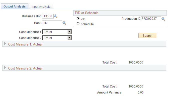

Use the Compare Cost Measures - Output Analysis page (CE_COST_ANALYTICS) to review and compare the cost calculations for the output from a production ID (products, co-products, and so on) at various stages of production.
Cost comparisons can include the production ID as planned, as produced, the frozen standard costs, the actual production costs, or other stages of production.
Navigation:
This example illustrates the fields and controls on the Compare Cost Measures - Output Analysis page. You can find definitions for the fields and controls later on this page.
Review and compare the cost calculations for a production ID at various stages of production. Enter the business unit, cost book, production ID or production schedule for the production costs that you want to review.

Cost Measure 1 and Cost Measure 2 |
Enter the two cost measures to compare for this production ID or production schedule. Cost measures represent the current costs at various stages of production. Cost measures include:
Seq Nbr (sequence number) |
Enter the sequence number that uniquely identifies the captured costs that use the Cost Measure of As Planned, As Produced, or Other. |
Search |
Select to display the costs for Cost Measure 1 and Cost Measure 2. |
