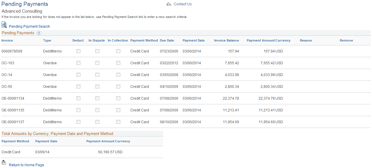

Use the Pending Payments page (AR_EBP_SCHEDULE) to review payments that are pending processing in Receivables.
Customers can view payments that have been received and determine to which invoices the payment was applied. For example, credit, customer service, and sales people can review payment information with a customer while they are on the telephone, essentially looking at the same page for all balance and payment information.
Navigation:
This example illustrates the fields and controls on the Pending Payments page.
Pending payments appear on the Pending Payments page until they have been processed by credit card or direct debit processing within Receivables. The system performs validations before removing a pending or scheduled payment to make sure that the totals by payment method, currency, and payment date are positive. No longer a scheduled payment, this invoice becomes available again on the Balance Detail page () and the Account Balance page (). From those pages, you can add the invoice to the Payment Cart again. If you delete a scheduled payment, the invoice is added to the Payment Cart.
Field or Control |
Description |
Click this icon to remove a scheduled payment from the Pending Payments page. When you submit an invoice for payment using the Credit Card payment method, and the Payment Date is the current date, an authorization is received from the credit card provider and the credit card is billed. In this case, the garbage bin icon is hidden because this scheduled invoice cannot be deleted after authorization. |
Pending Payment Search |
Click this link to open the Pending Payment Search page (AR_EBP_SCHED_SRCH), where you can search for payments that are not listed on the page and sort results. |
Note: If a pending short payment is deleted, the system does not delete the corresponding conversation for the short payment.

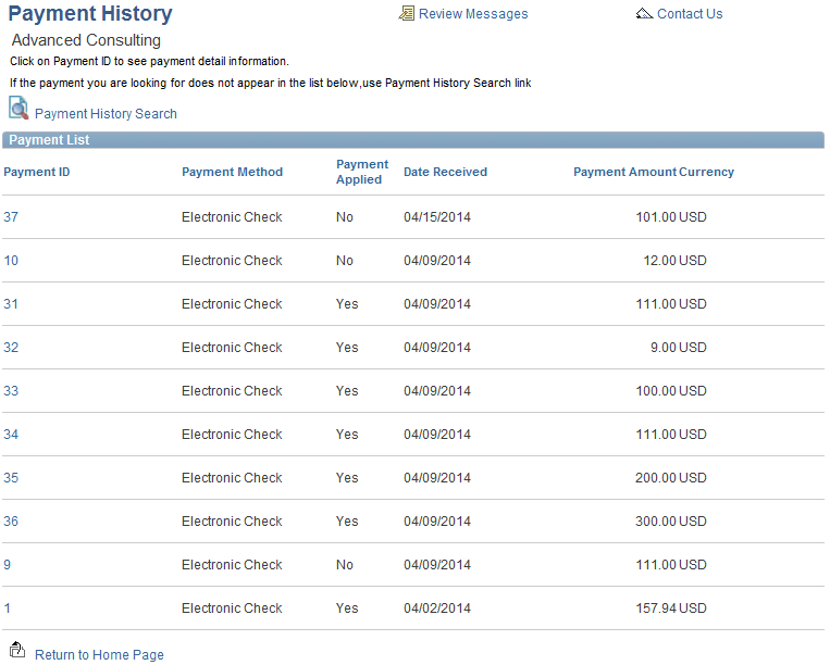

Use the Payment History page (AR_SSREV_PAYMENTS) to review payments.
Navigation:
Click the Payment History link from the home page or the side navigation menu.
This example illustrates the fields and controls on the Payment History page.
Payment List
Field or Control |
Description |
Payment History Search |
Click this link to open the Payment History Search page (AR_SSSRCH_PAYMENTS), where you can search for payments that are not listed on the page and sort results. |
Payment ID |
Click a Payment ID link to view the payment detail on the Payment Detail page. Identifies the payment that is received. The Payment Applied field indicates whether the payment has been applied. The date received is the date that the payment is received from the payee, and payment amount indicates the amount that is received. |
