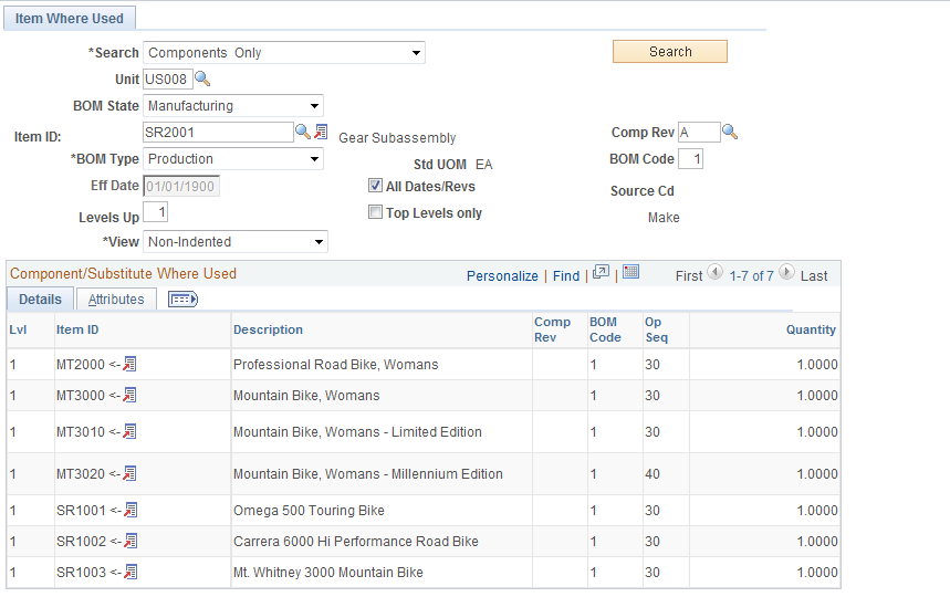

Use the Item Where Used (inquiry) page (EG_BOM_WHEREUSED) to view all of the EBOMs on which an item appears.
You'll find this information useful when you want to analyze the impact that a change in an item can have on all existing BOMs.
Navigation:
This example illustrates the fields and controls on the Item Where Used page: Details tab. You can find definitions for the fields and controls later on this page.

Search |
Select a value to display only certain types of data. Values are: Components Only, Components and Substitutes, Outputs Only, and Substitutes Only. |
Unit, Item ID, BOM Type, Eff Date or Revision, and BOM Code. |
Enter this information about the item, as appropriate. |
Levels Up |
Enter 1, to view only the item's parent assembly. The larger the number, the higher the level; for example, level 3 is three levels higher in the BOM structure than the item. To view only the final end item in which the selected item is an item, select Top Levels only. If you have requested more than one level, an arrow appears next to the item's immediate parent in the Item ID field. Note: Do not confuse the Levels Up field with the Depth field on the BOM inquiry pages. Levels Up looks up the BOM structure; Depth looks down the structure. The Levels Up field is available only for BOM code 1. |
Search |
Click to retrieve the selected item where-used information. |
If you selected Components Only or Components and Substitutes, the system displays all higher-level subassemblies or assemblies that contain the selected item. You also see the levels at which the items appear in the higher-level items. The left arrow (←) in the display points to the item that directly uses the item selected.
Components and Substitutes and Substitutes Only appear if the component for the item is a substitute.
If you selected Outputs Only, the system displays information by output type, including:
Item ID
BOM Code
Op Seq
Output Quantity
If the component is revision-controlled, a Comp Rev field also appears as a search parameter. If you enter a component revision, this page returns all assemblies where that component matches or is blank. If you leave the component revision blank, the inquiry returns assemblies that use any revision of the component.
