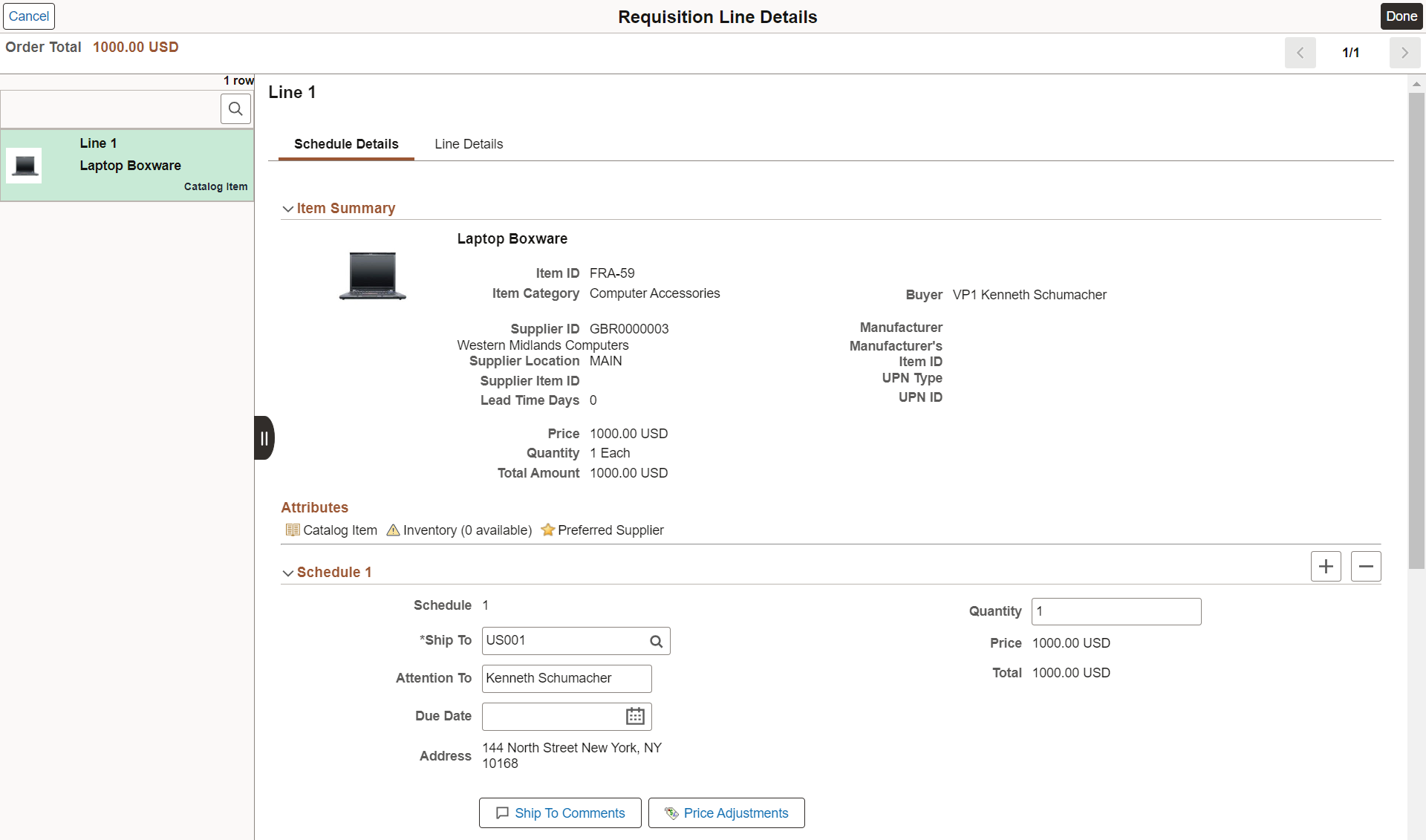

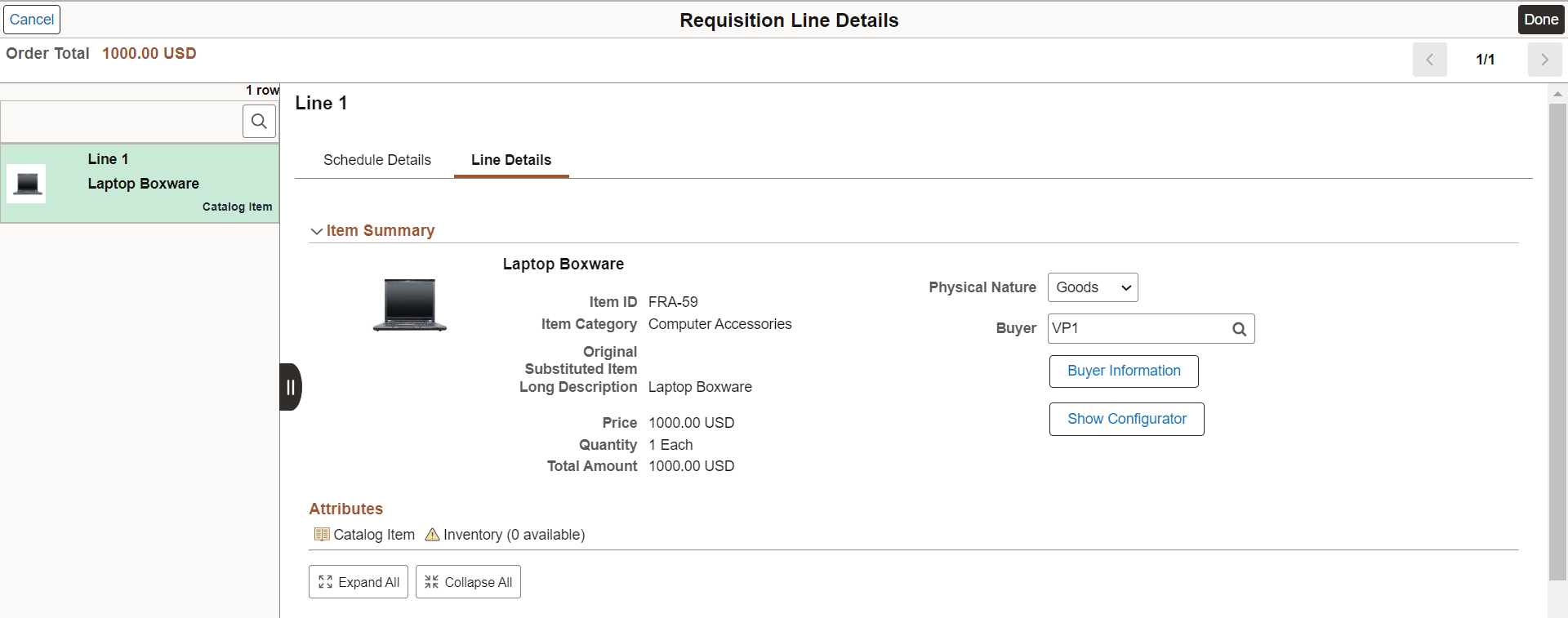

Line Details Page
PV_SCH_DIST_SCF
Confirm requisition checkout information and edit additional details for a line, such as the buyer, supplier, and other line-specific information.

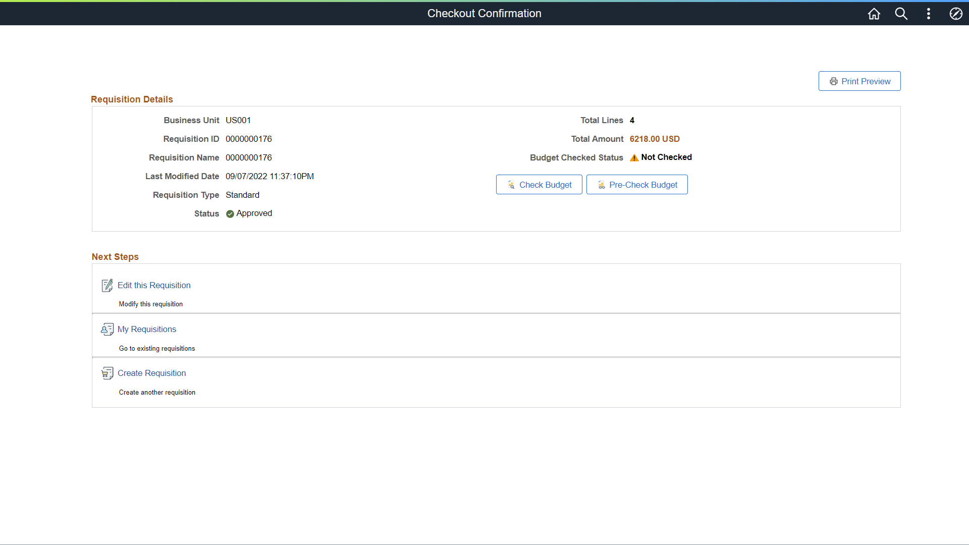

Save Confirmation Page
PV_MOB_855_CONF
View the final requisition details that have been submitted for approval.

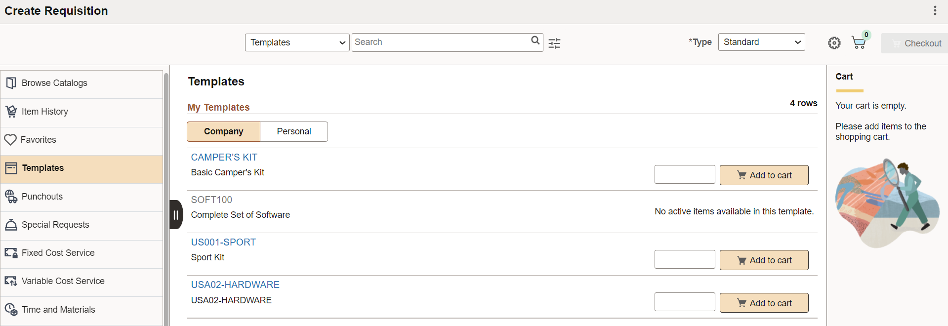

Templates Page
PV_MOB_TEMPLAT_FL
View and add purchasing kits, company and personal templates to your cart.

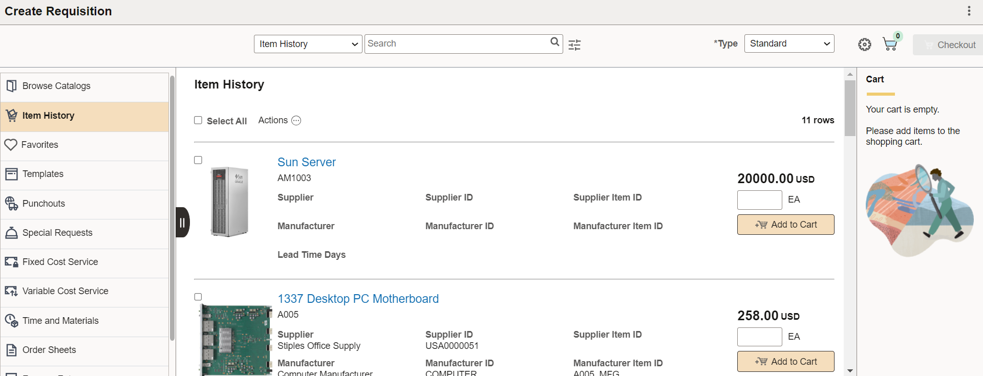

    Item History
    Select to display the Item History page in the right panel. The Item History page displays a list of recently ordered items. The number of items displayed depends on the value in the Max Rows to Retrieve for Search Results field on the ePro Installation Options Page.

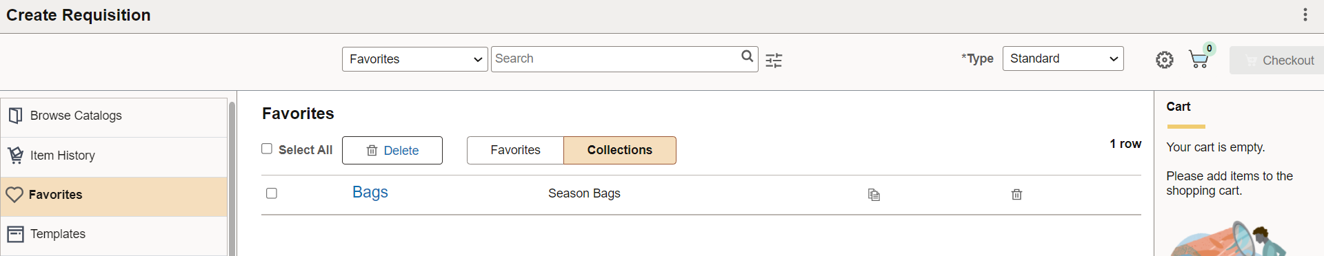

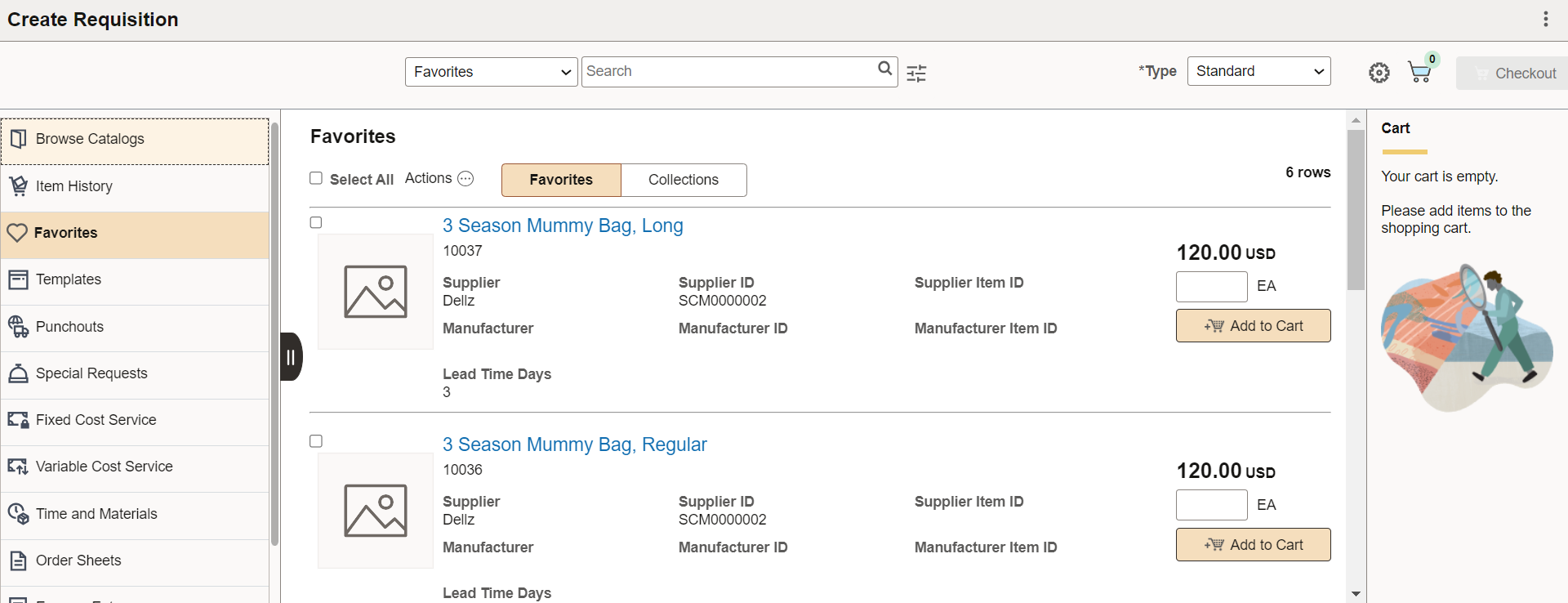

    Favorites
    Select to access the Favorites page. This page displays a list of items that have been marked as a favorite.
    You can enter a quantity, add items to the cart, add items to templates, delete items from your favorites, and view the item description and item details.
    Select the Manage Favorite Groups button to access the Favorite Groups window, where you can modify the Favorite Group name, description, and sharing information.

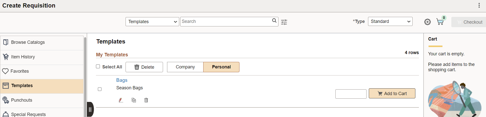

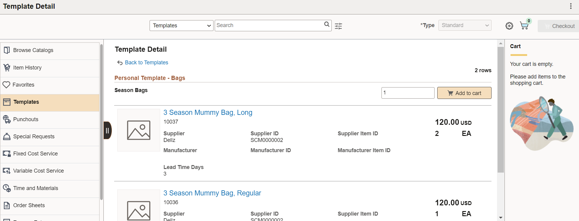

    Templates
    Select to access the Templates page. This page displays purchasing kits and personal templates. For each template or kit. Use the quantity and Add to cart button to add the template or kit items to the cart.
    Select the Detail icon to view the items in the kit or template.
    Select the Manage Personal Templates button to access the Personal Templates window, where you can modify the template name, description, and sharing information.

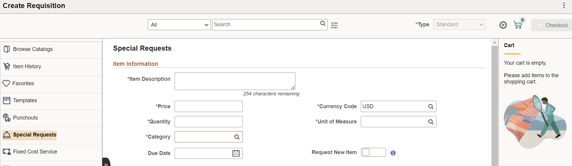

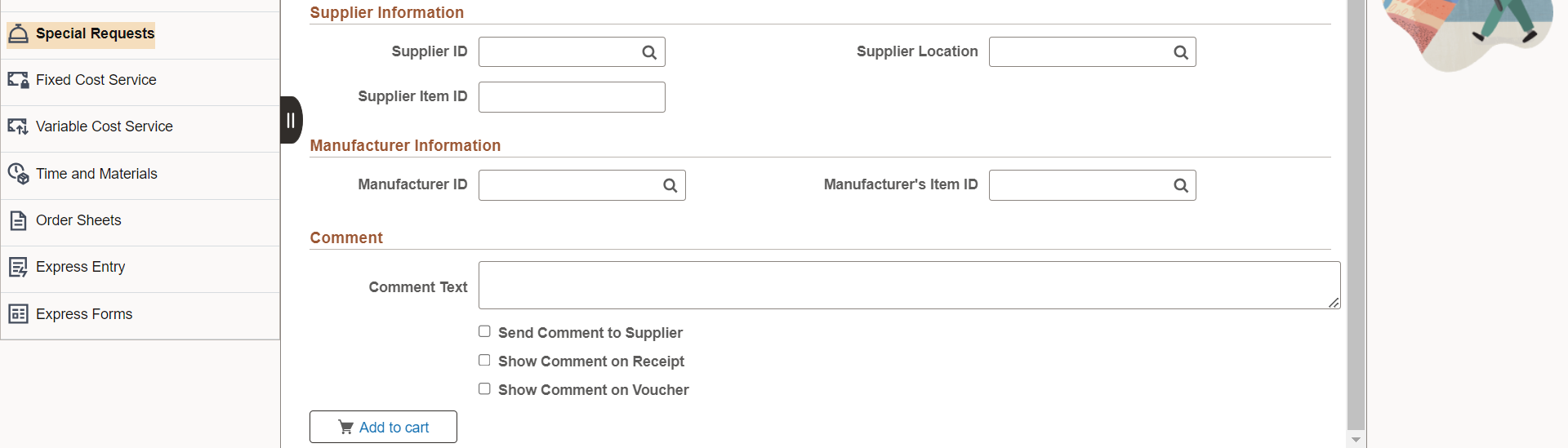

    Special Request
    Select to access the Special Requests page. This page allows you to create special requests for an item that is not in a standard catalog and has no item ID.
    Use the Special Requests page (PV_MOB_SPECIAL_REQ) to create any special requests to requisitions if required. Use the Special Request page to create requisitions for items or goods that are not included in the standard catalog of items in PeopleSoft eProcurement and have no item ID. This special request can be for goods or services.
    Users can either select the items you want to add to the cart or select the add special request tab to create special request .

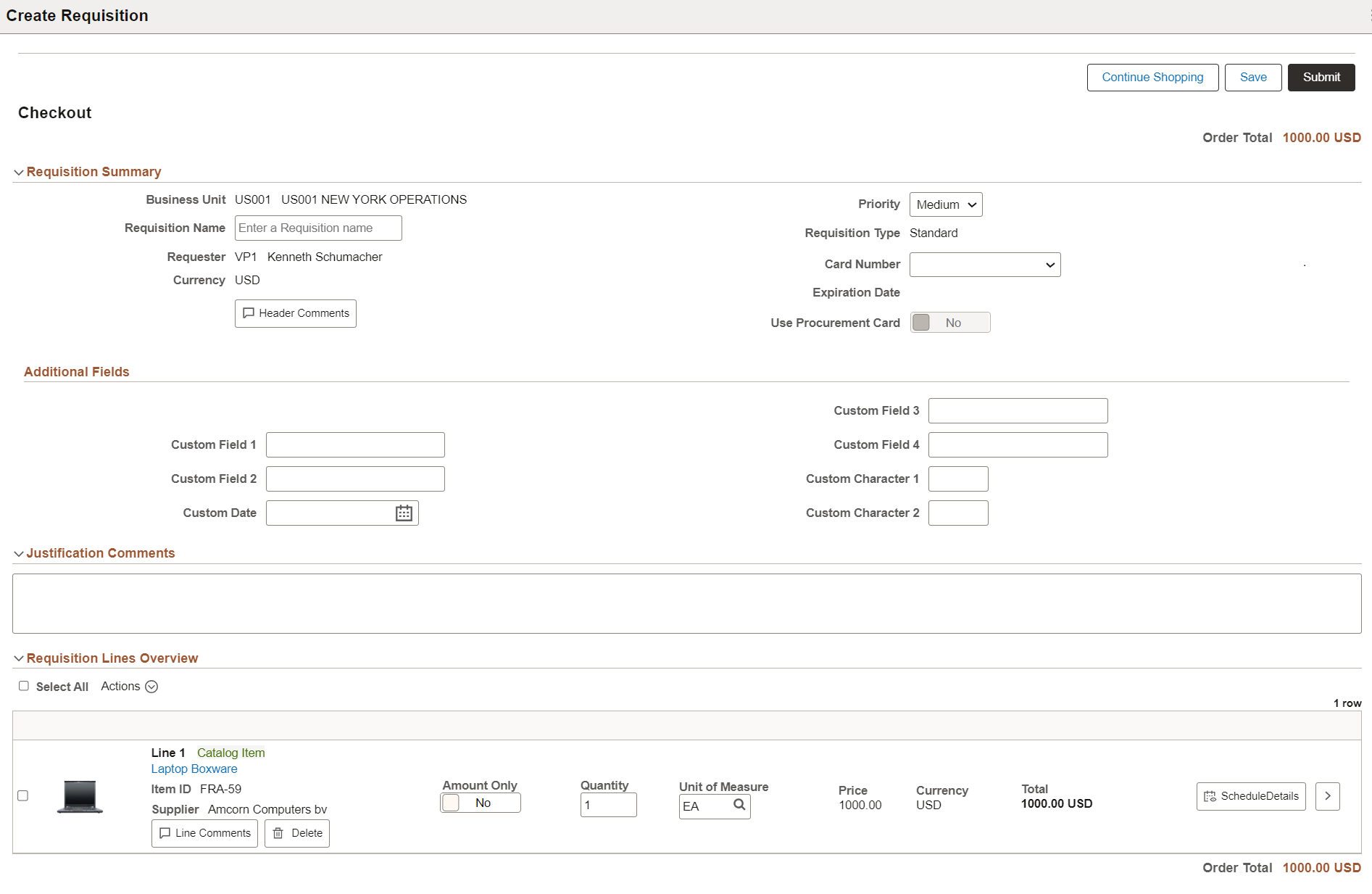

  4. Access the Shopping Cart page to verify items.
  5. Access the Checkout page to verify requisition information, check budgets, or add documents.

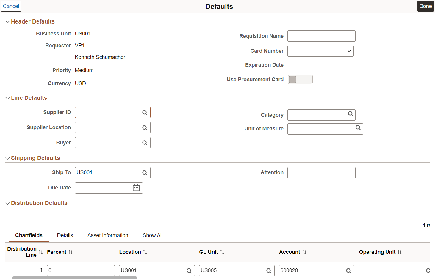

Use the Requisition Defaults page (PV_MOB_855_SET_SCF) to enter default field values for new requisition lines and define requisition settings such as purchasing business unit and requester.
Note: If you enable the LAND_ON_REQ_SETTINGS_PG role action on the Assign Role Action To Roles page, the Requisition Defaults page displays as the landing page.
Navigation:
Fluid Home > Employee Self Service > eProcurement > Create Requisition > Settings Icon > Defaults
This example illustrates the fields and controls on the Requisition Defaults Page. You can find definitions for the fields and controls later on this page.
Before using this page, determine the features that your users can access by linking user roles to the following eProcurement role actions:
  • The CHANGEREQBU role action is required to access the Business Unit and Requester fields on this page.
    Note: Fluid has a persistent cart. This means that if any items remain in the cart from the previous session, then you cannot change the requester/BU fields, even if you have the CHANGEREQBU role, until the cart is empty.
  • When the new business unit is selected, the existing shopping cart items will be removed. You can add the new requisitions under new business unit.
    Note: Some fields on this page may not be changeable if there are already items in the cart.
Field or Control
Description
Line Defaults, Shipping Defaults, and Distribution Defaults
The values that you enter on this page can be applied to the entire requisition at the line, shipment, or distribution levels.
Note: Because these values override default values on the requester, only one distribution line is allowed on this page. This is different behavior from classic and intentional. The approved method to add more than one default distribution is to use the mass change option on all lines after all are entered.
Add One Time Address
Select this button to enter the default one time shipping address. Enter the shipping details in the Shipping Address page and save the details.
Note: To use this field, you must have NO_ONETIME_SHIPTO role action disabled.

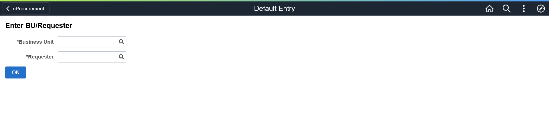

Use the Default Entry page (PV_MOBREQ_ENTRY_FL) to enter the business unit and requester ID.
Navigation:
eProcurement Tile > Create Requisition Tile
This example illustrates the fields and controls on the Default Entry page.
Default Entry page
If you have already specified the business unit and requester ID on the User Preferences – Procurement page, this page does not display.
After entering the details, you can proceed with creating requisitions. If you have already defined the business unit and requester ID on the User Preferences – Procurement page, and enabled the LAND_ON_REQ_SETTINGS_PG role action on the Assign Role Action To Roles page, the Requisition Defaults page is displayed as the landing page.
Note: If you do not have the authority to add requesters, the system displays a message, in which case you can contact the Administrator to get the authorization.

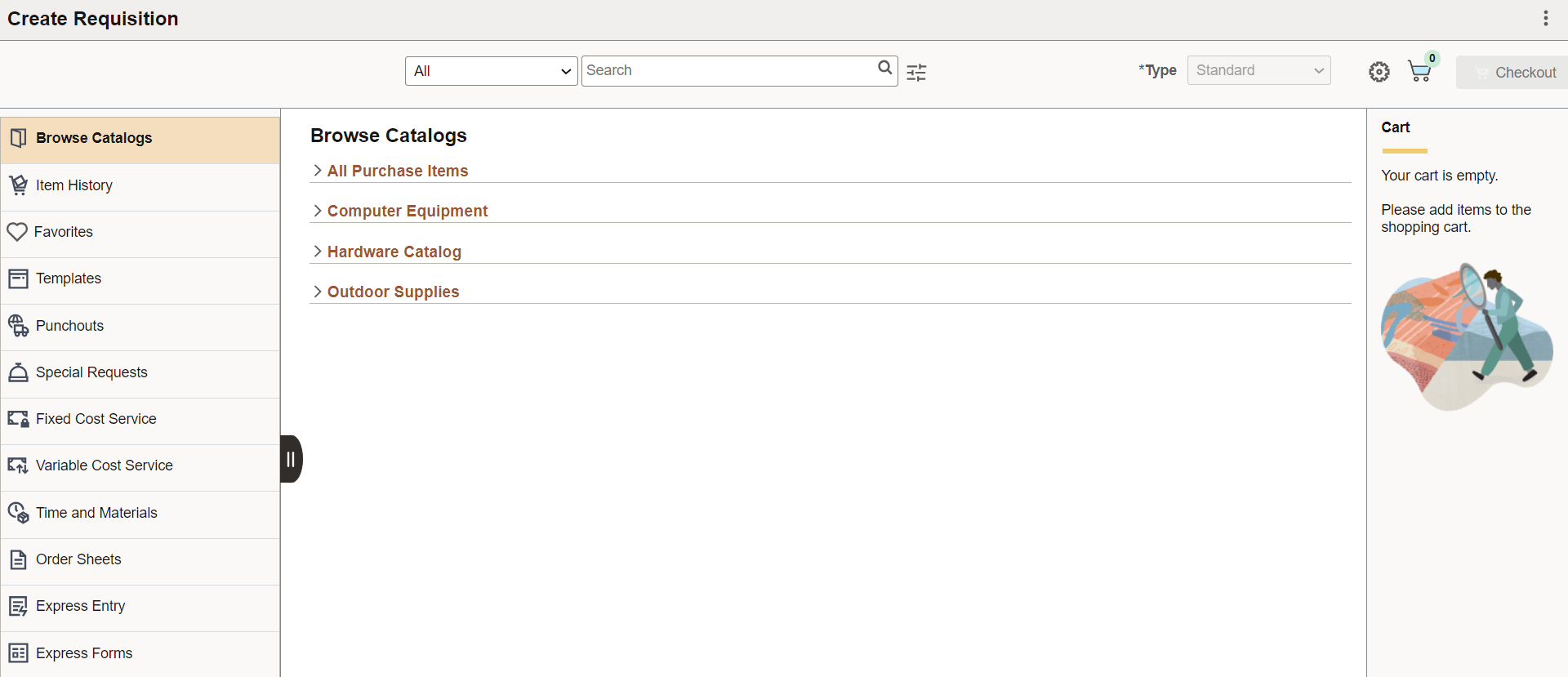

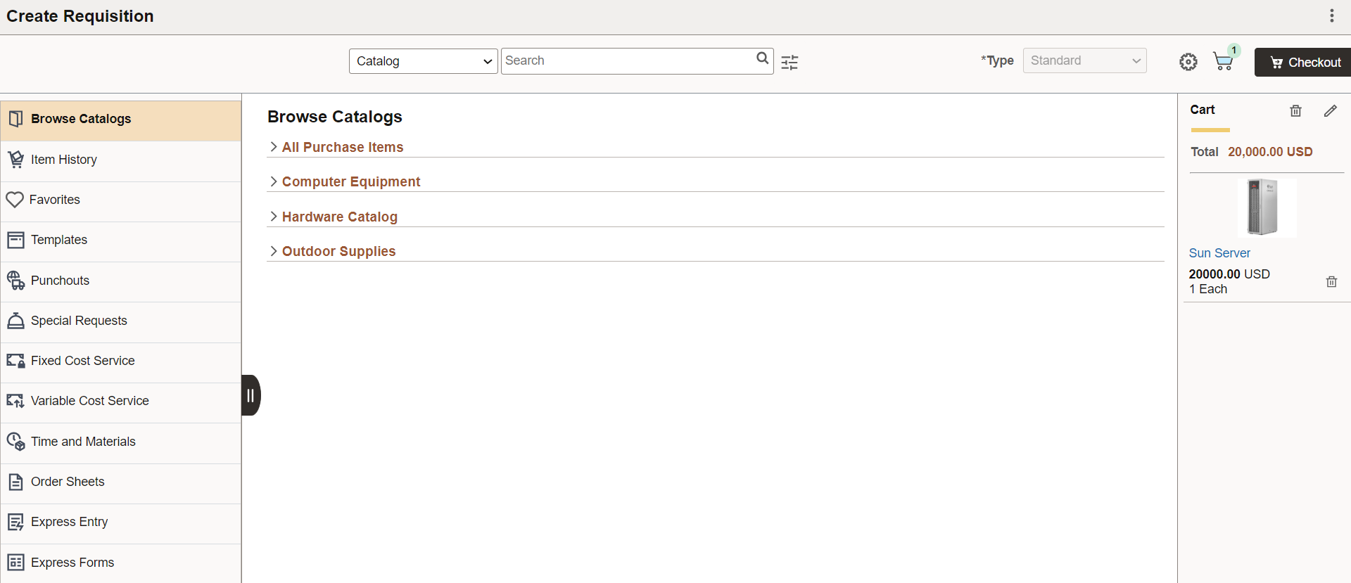

Use the Create Requisition: Browse Catalogs page (PV_MOB_CATBROWSE) to search for items.
Navigation:
eProcurement Tile > Create Requisition tile
Select a Requisition Type (Standard, Bill Only, and Bill and Replace) from the drop-down.
Select Catalog.
This example illustrates the fields and controls on the Create Requisition - Browse Catalogs page.
If one of the item suppliers on the Item details page is not available to be added to the cart, the Add button is hidden. The categories displayed on the Requisition page are visible or hidden, based on the Settings page. The Checkout button is enabled only when items are available in the cart.
The cart icon displays the number of items added to the cart.
The Cart displays a list of added items added, along with the item name, quantity, and price. To view item details, click on the item name.
This example illustrates the fields and controls on the Create Requisition - Cart Overview page.
Cart Overview
To remove all of the added items from the cart, click the Clear Cart button. You can remove the items individually from the list. Click the Edit Cart button to view the Shopping Cart page, and the Checkout button to access the Checkout page. For additional details, see Shopping Cart Page and Checkout Page. You can also delete items from the cart here.
To update an item already in the cart, click the item description link. You will be taken to the Item Details or special requests pages. If the item in the cart is a punchout item, you will be taken to the punchout site.

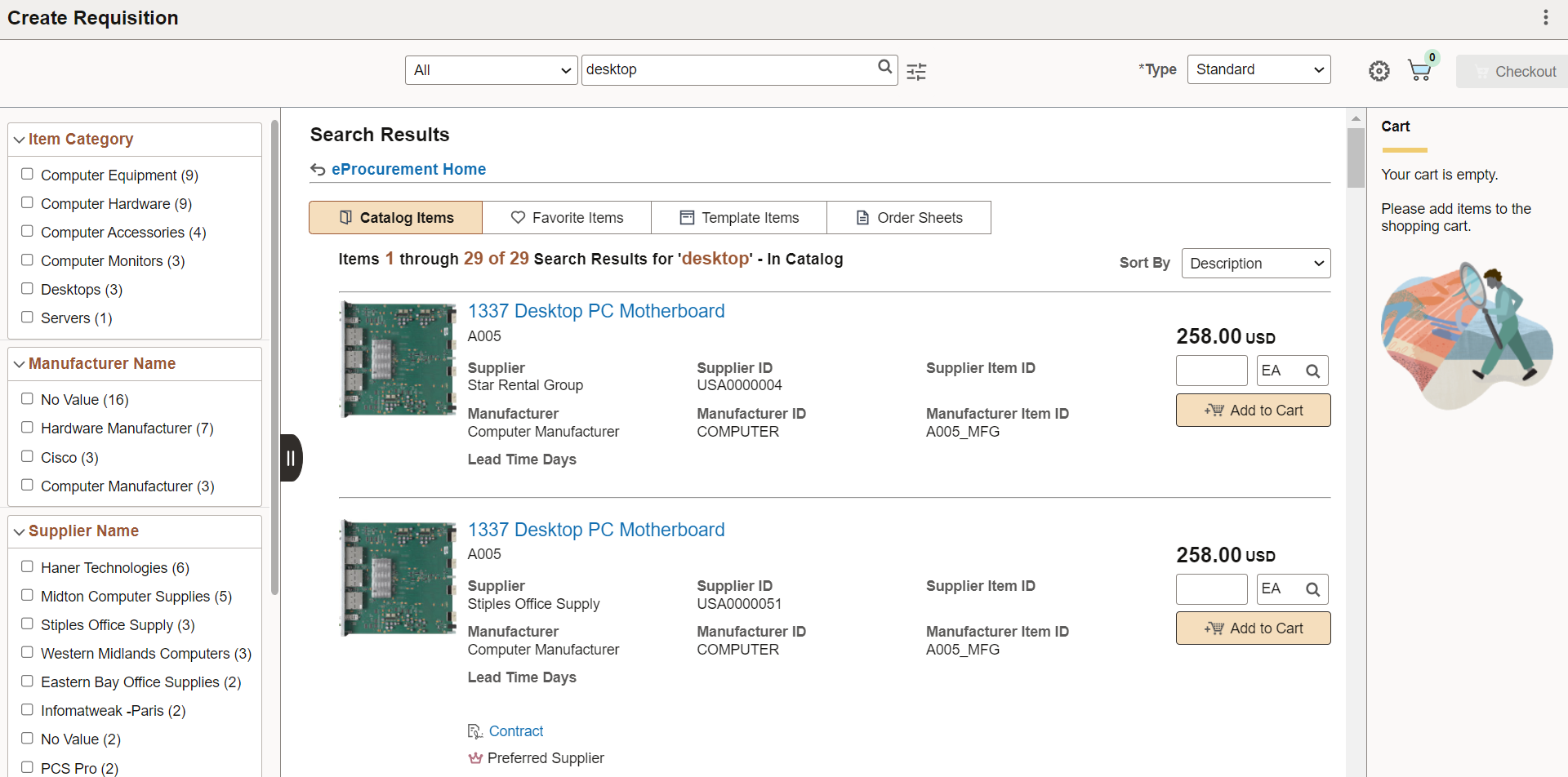

Use the Create Requisition: Search Results page (PV_MOB_855_SRCH) to search for items based on the Search field.
Navigation:
Select a category and enter text in the search field.
This example illustrates the fields and controls on the Create Requisition: Search Results Page.
Create Requisition Search Results Page
You can search for an item across all categories (All) or select a specific category (Catalog, Express Forms, Favorites, Item History, Order Sheets, Punchouts, and Templates). The top of the Search Results page displays buttons for the categories or types that contain the item matching your search criteria. In this example, the default selection is the Catalog Items category, which displays the items within it. Select another category to view the results within it. The values in the drop down depend on which pages your organization has authorized for Create Requisitions. Therefore, the categories available may depend on whether or not these pages are in use.
The search result displays the list of items along with Category, Manufacturer Name, Supplier Name, and Preferred Supplier details when a catalog item is searched. In the right column, the search results display the PO ID, item name, and supplier name. Click the item description link to view the item details and perform Add to Favorites and Add to Templates. The links for each item, such as Inventory, Price Breaks, Contract, Stock, and Substitute Item appear as applicable.
Select any of the sort options (Description, Price - high to low, Price - low to high, and Relevance) in the Sort By drop-down to reorganize the search result. To configure the sort options, see Search Settings Page and Manage Weighted Sort Rules Page.
Note: Price - high to low and Price - low to high sort options sort the search result based on the price value irrespective of currency type.
To make Relevance Sort Option available, APPLY_WEIGHTED_SORT Role Action should be enabled for the requester and at least one Weighted Sort Rule should be activated.
Click the eProcurement Home link to navigate to the Create Requisition home page.
Use the Advanced Catalog Search button next to the search box to perform more complex searches by entering the required search criteria. You can save the search criteria by clicking the Save Search Criteria link.
For more information about performing advanced search, see Advanced Search — Create Requisition Page.
To add an item from the search result to the cart, enter the quantity and click Add to Cart. The cart displays the added number of items. While adding items to the cart, check the UOM, or you can select the UOM type using the Lookup UOM button.

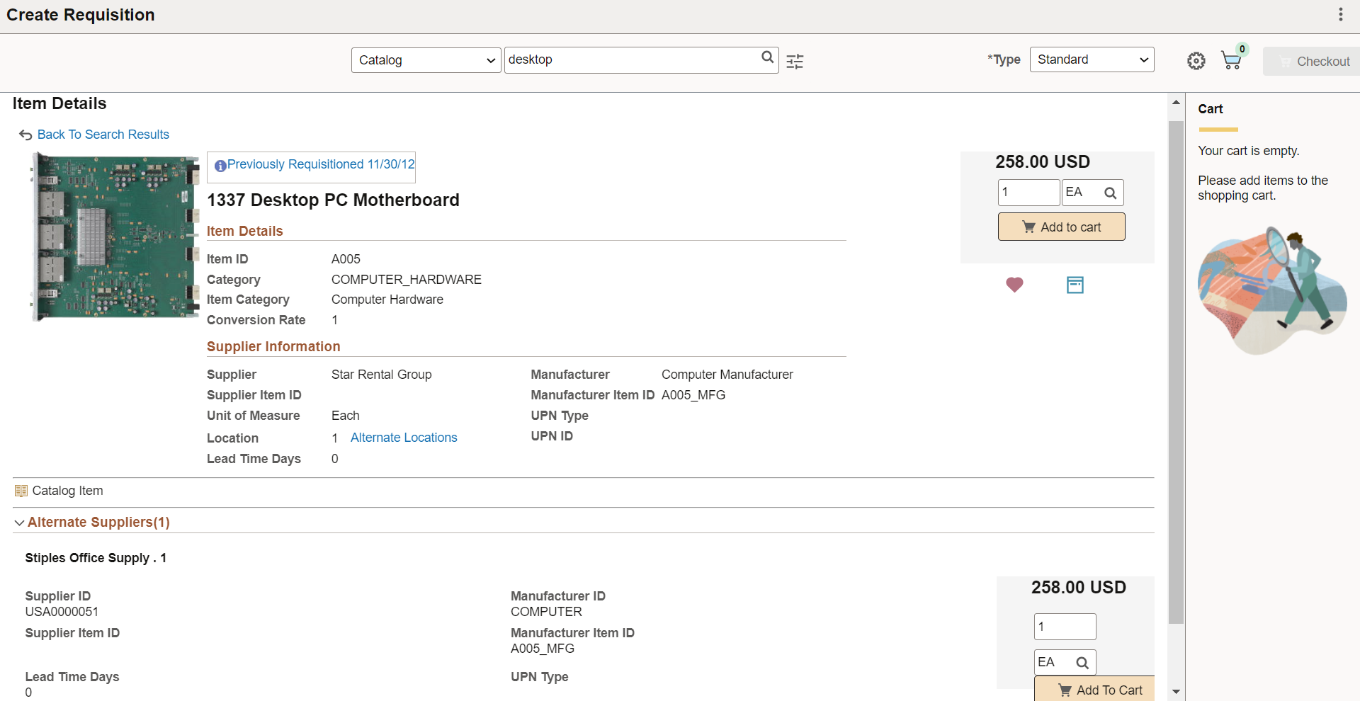

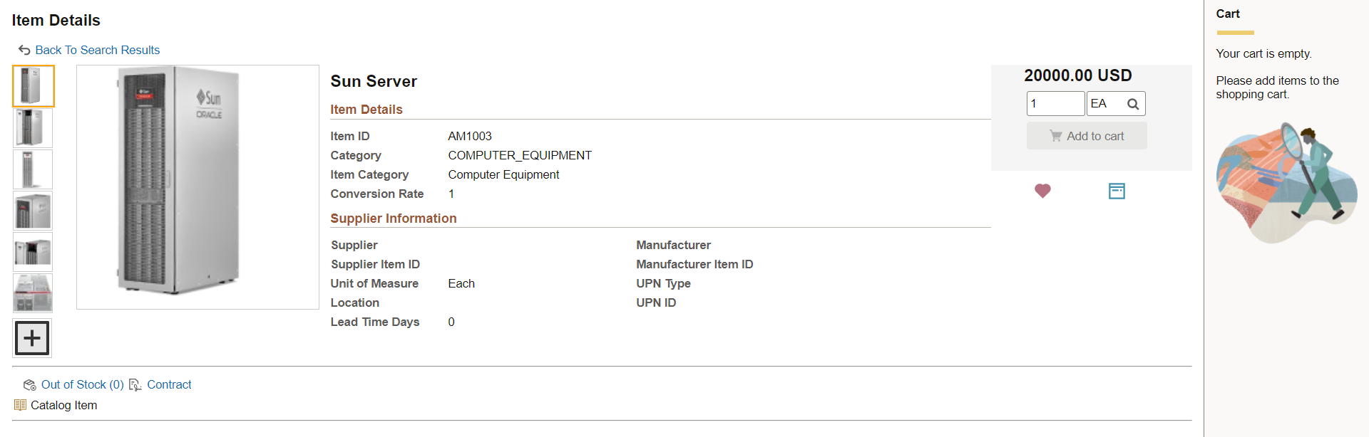

Use the Item Details page (PV_MOB_855_ITEMDET) to view item details.
Navigation:
Select the item name link.
This example illustrates the fields and controls on the Item Details page.
Create Requisition Item Details page
If you enable multiple images in the installation options, You can view all the images available for the item. Click the image to enlarge it.
To view the Requisition Details page of the previous requisition for this item, click the Previously Requisitioned link.
This example illustrates the fields and controls on the Item Details page - with multiple images.
Item Details page - multiple images
The Item Details page displays all potential suppliers for the item if the role action VIEW_ALL_SUPPLIERS is enabled. If there is a preferred supplier, it is listed at the top. You can add the item to your favorites list or to a template. The icon changes color (fills in) if you have already added the item to your favorites or templates.
If you want to add this item to the cart, verify the quantity and unit of measure (UOM) and select the Add to Cart button.
To return to the list, select the back button. The back button takes you back to the first page where you viewed the item details.
The item details display item level and supplier level attributes. To configure which attributes to be displayed on the search result, see Manage Weighted Sort Rules Page.

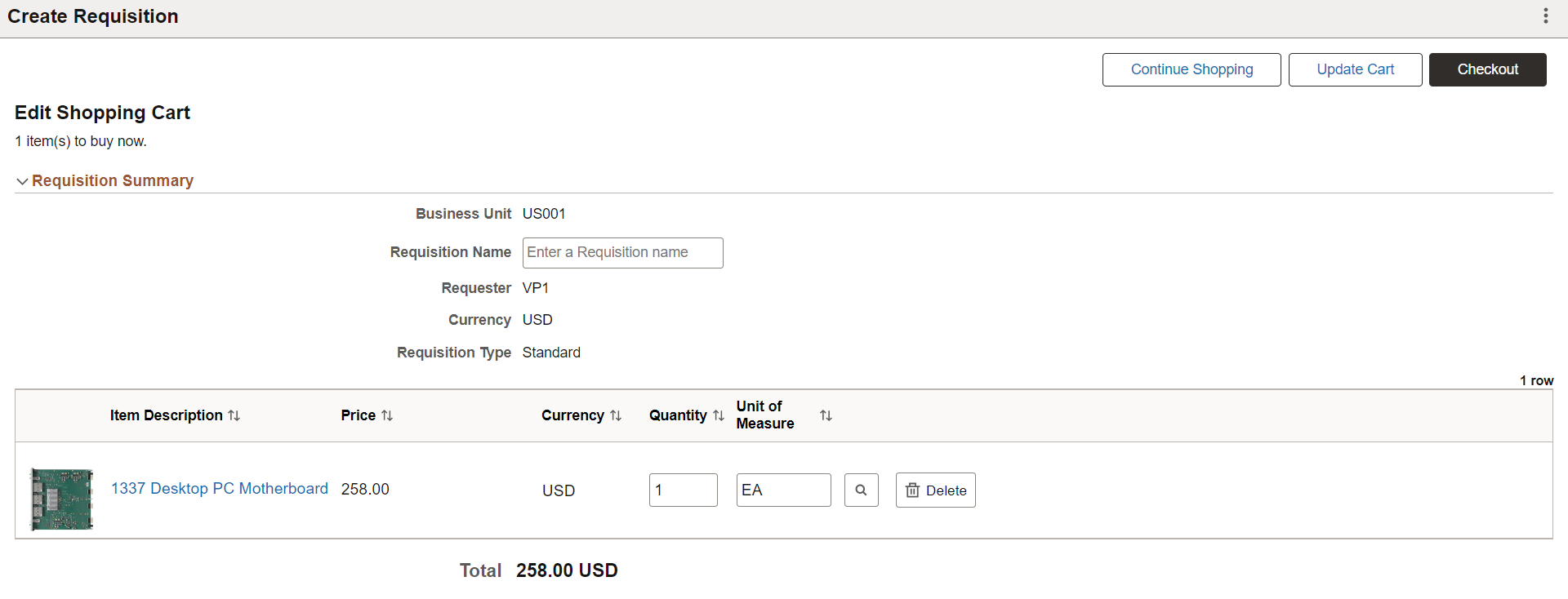

Use the Shopping Cart page (PV_MOB_855_SR_CART) to view and modify items in your cart. Select the Checkout button to check out items and save or submit requisitions.
Navigation:
eProcurement Tile > Create Requisition tile > Edit Cart
This example illustrates the fields and controls on the Shopping Cart page. You can find definitions for the fields and controls later on this page.
Create Requisition Shopping Cart page
Use this page to make changes to the requisition and submit it again. You can perform the following operations:
Users can access the Edit Requisition page, make changes to the requisition, and submit it again. These operations can be performed when editing a requisition:
  • You can modify the Quantity if the requisition line is not multi-scheduled.
  • You can add or remove requisition line items, and split quantities into multiple schedules and distribution lines.
  • You can perform budget checking and pre-checking process.
  • You can either cancel the edit operation or save changes and submit the requisition.
  • After the requisition is saved or submitted, you can view the My Requisition and Create New Requisition buttons from the Confirmation page.

Update Cart
Select this button to save any changes and update the requisition.
Checkout
Select to access the Checkout Page.
Business Unit
Displays the name of the business unit.
Requisition Name
Enter a description of the request to help you identify this requisition as it flows through the system. If this field is left blank, the system uses the requisition ID as the name.
Requester
Displays the ID of the requester.
Currency
Displays the currency that is selected for the business unit
Requisition Type
Standard, Bill Only, and Bill and Replace Requisition Types will be display only if there are items in the cart.
Item Description
Click on this link to view the item details and images.
Quantity and Unit of Measure
Modify the quantity, unit of measure (UOM), or both.
Note: The UOM can be edited only if the Allow Editing of UOM check box is selected on the ePro Installation Options Page.
Delete
Select to remove the item from the cart or requisition.
Use the Checkout page (PV_MOB_NEW_CHEKOUT) page to verify and perform various actions to the requisition and requisition lines.
Navigation:
eProcurement Tile > Create Requisition tile > Shopping Cart > Checkout
This example illustrates the fields and controls on the Checkout page. You can find definitions for the fields and controls later on this page.
Create Requisition Checkout page

Requisition Summary
Field or Control
Description
Requisition Name
Select to enter a description of the request to help you identify this requisition as it flows through the system. If this field is left blank, the system uses the requisition ID as the name.
Priority
Select an option of High, Medium, or Low to indicate the priority to the approver.
Header Comments
Select to accesses the Requisition Header Comments and Attachments page where you can add comments and upload one or more supporting documents. The system displays an error message if you try to load more than the number of attachments specified on the Installation Options - Multiple Attachments Page for Purchasing product.
Use this page to enter comment text and indicate whether to send the comment to the supplier, show the comment at receipt, and show the comment at voucher.
Select the comments and attachments to view the collated header comments and attachments for the requisition.
You can also add multiple comments and attachments for the requisition. MULTI_COMMENTS role action controls whether the user can add multiple comments and attachments for the requisition or not.
Card Number
Select to enter a credit card number
Use Procurement Card
Select to indicate that a Procurement card is to be used.
Additional Fields
Additional Fields provides the drop zone custom fields configured on the Requisition Type Template Page.
Justification Comments
Enter comments to justify the need for the requisition. These comments appear on the Requisition Approvals page.
Requisition Lines Overview
Use this section to apply the selected action to one or many lines. Click on an item name link to access the Item Description window.

  • Mass Change: Displays the Mass Change page, where you can change the information for the selected requisition lines. For more information, see Edit Lines/Shipping/Accounting for Selected Lines Page.
    Different options to apply distribution changes to the lines of your requisition are All Distribution Lines, Matching Distribution Lines, and Replace Distribution Lines.
    Select the Load Values From Defaults button to populate distribution line values.
    Populating distribution lines on the Mass Change page can also be done by manually entering accounting tags.
For more information, see Submitting Requisitions.
Select to access the Mass Change page (PV_MOB_855_MAS_SCF) where you can change the following:
  • Line Information such as Supplier ID, Supplier Location, Category, and Buyer.
  • Shipping Defaults such as Ship To, Comments, Due Date, and Attention
  • Distribution Information such as ChartField and Asset information.

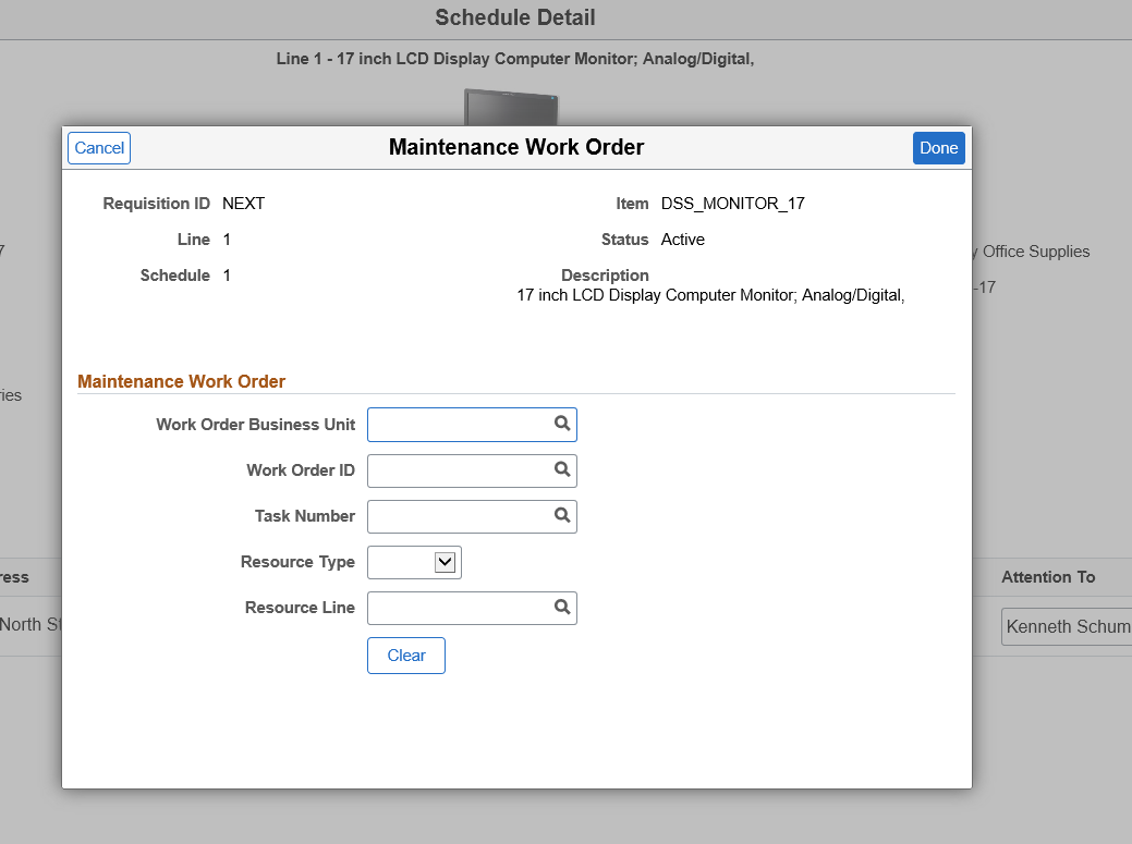

Maintenance WO
Click Maintenance WO button to integrate a work order to a requisition schedule.
A requester with the CANLINK_WO role action enabled can view this option.
Note: For fluid requisitions, you can peg only non-inventory items to work orders.
For more information about work order integration, see Integrating Requisitions with Work Orders.

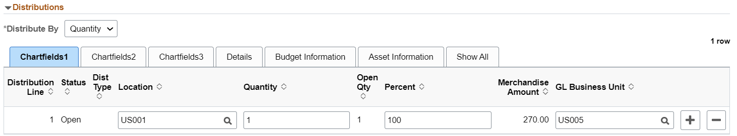

Distributions group box
You can view and override the accounting information.
Use the Distributions section to access Accounting Tag information, modify ChartFields, and access Budget and Asset information.
This example illustrates the fields and controls on the Schedule Detail - Distributions page
Distributions Page
Note: ChartField Display Templates are used to extend ChartField configuration to control the display of individual ChartFields on PeopleSoft Fluid components. It displays ChartFields in a consistent manner on PeopleSoft Fluid transaction pages across PeopleSoft products. For eProcurement mobile requisition the default ChartField display template ALLCFS is used for all users, a permission list, or user ID. Use the Assign CF Display Templates Pageto assign template to the mobile requisition component.

Use the Line Details page (PV_SCH_DIST_SCF) to confirm requisition checkout information and edit additional details for a line, such as the buyer, supplier, and other line-specific information.
Navigation:
eProcurement tile > Create Requisition tile > Shopping Cart > Checkout. Select the View Details icon for a line.
This example illustrates the fields and controls on the Line Details Page (1 of 4). You can find definitions for the fields and controls later on this page.
Create Requisition Line Details page (1 of 4)
This example illustrates the fields and controls on the Line Details Page (2 of 4). You can find definitions for the fields and controls later on this page.
Create Requisition Line Details page (2 of 4)
This example illustrates the fields and controls on the Line Details Page (3 of 4). You can find definitions for the fields and controls later on this page.
Create Requisition Line Details page (3 of 4)
This example illustrates the fields and controls on the Line Details Page (4 of 4). You can find definitions for the fields and controls later on this page.
Create Requisition Line Details page (4 of 4)
If you have substitute items defined for the original item, the Substitute icon appears next to the Original Substituted Item field. Click the Substitute icon to access the Substitute Items window to override any auto-substituted item. Only those items that are available for Manual Substitution and Automatic and Manual Substitution types are listed for your selection.

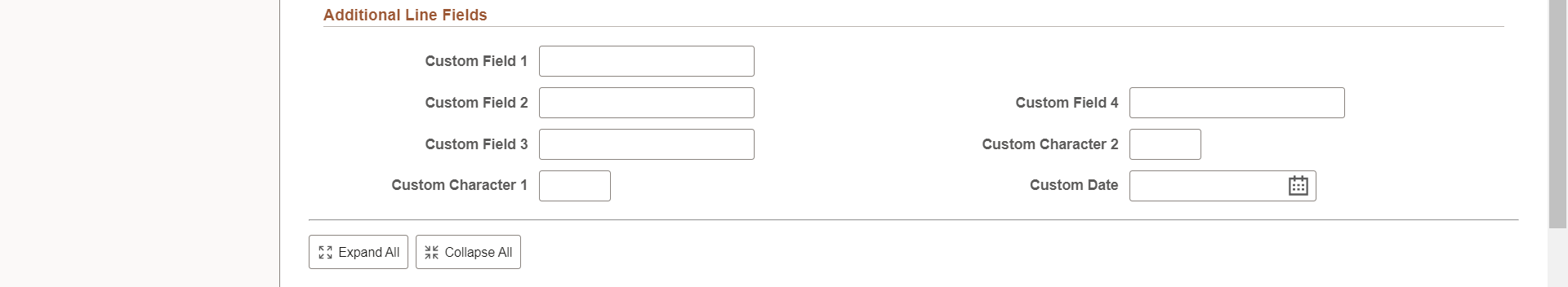

Additional Line Fields
Additional Line Fields provides the drop zone custom fields configured on the Requisition Type Template Page.

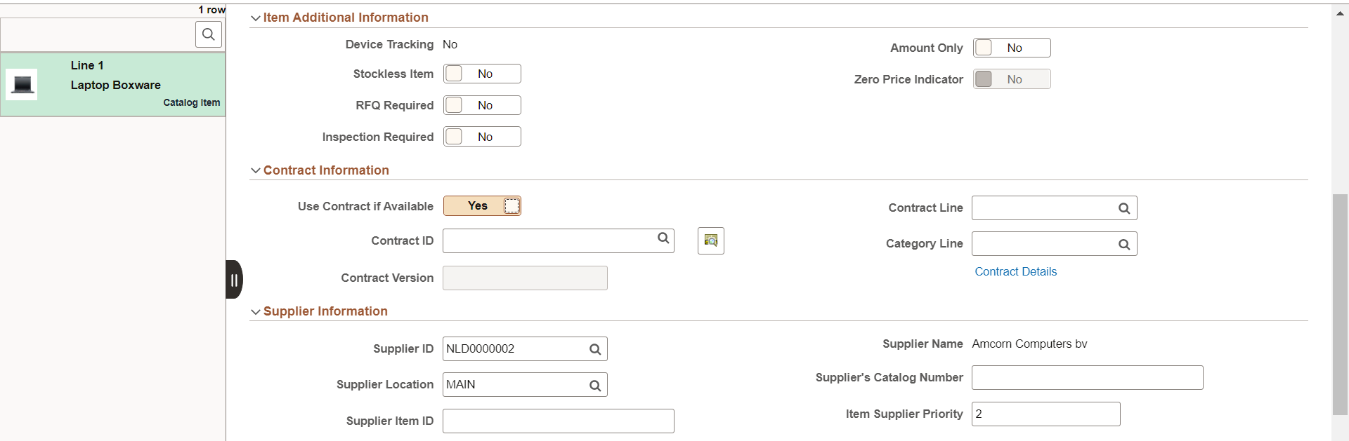

Item Additional Information
Field or Control
Description
Device Tracking
Displays whether a receipt line is device tracked. This field is available for items that are description-only. See Using Device Tracking
Stockless Item, RFQ Required, Inspection Required
See Purchasing Attributes - Purchasing Controls Page
Amount Only
Select Yes to indicate that the line is an amount only line. When you select Yes, these actions occur on the requisition:
  • The requisition and schedule line quantity are set to 1 and become unavailable for entry.
  • The Price field on the line is available for entry. The price amount that you enter becomes the schedule price and amount.
  • The Distribute By option on the Schedule-Distribution page defaults to Amt.
  • In the Line Details window, the Inspection Required, Consolidate with other Reqs, and Inventory Source Flag toggle buttons are disabled.
  • The system prevents you from adding another schedule line by removing the Add Row button on the Schedule page.
See also, Common Elements Used in the Sourcing Workbench
Note: The Amount Only toggle button is always visible and available on the Requisition Line Details page.
Zero Price Indicator
See Common Elements Used in the Sourcing Workbench.
Contract Information
Click the Contract Search icon to access the Contract Search page, where you can perform advanced searches for contracts to be applied to the requisition line.
If you replace an existing contract or select another, the Supplier Information section reflects the modifications accordingly. You can confirm whether you want to proceed with changing the supplier when the message displays.
See Line Details Page for more information.
Field or Control
Description
Supplier ID
Displays the ID of the supplier that supply this item.
Supplier Location
Displays the location of the supplier. The default is based on the value that is defined for the supplier.
Supplier Item ID
Displays the ID that the supplier uses to identify this item on the Item Supplier page.
Supplier's Catalog Number
Displays the Catalog Number that the supplier assigned for the item.
Item Supplier Priority
Indicates the supplier priority selected for the item. The value appears by default as a medium priority, but can be changed by the user. The updated priority appears on the Requisition Header.
Suggest New Supplier
Select this link to access the Suggested Supplier page (PV_MB_SUG_VNDR_SEC) where you can enter supplier name, address, and phone information.

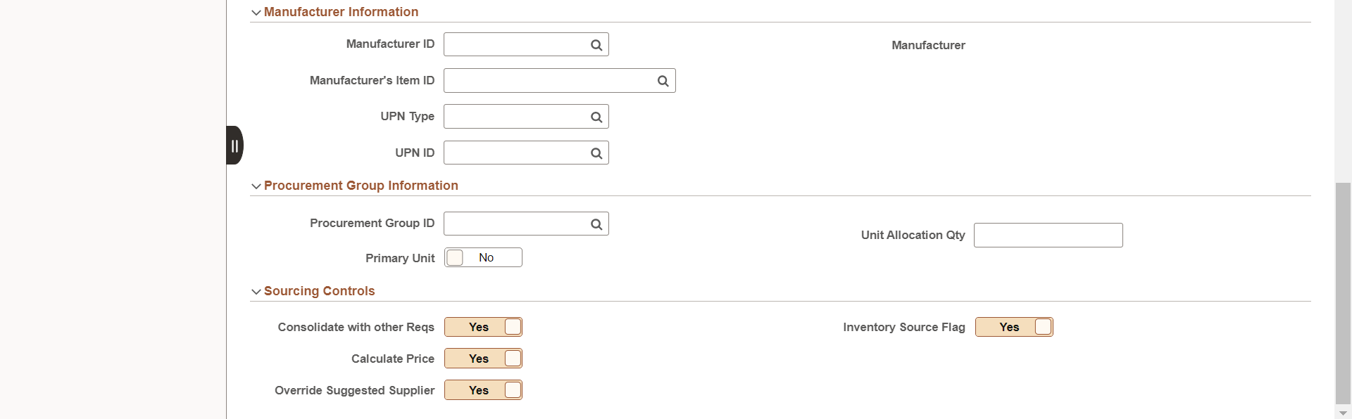

Manufacturer Information
The Manufacturer information group box displays all information pertaining to the manufacturer.
Field or Control
Description
Manufacturer ID
Identifies the manufacturer of the item. This value is supplied from the Supplier’s Manufacturer Info page.
Manufacturer's Item ID
Displays the identifier that the manufacturer uses for this item when the suggested supplier supplies the item. This value appears from the Supplier's Manufacturer Info page.
UPN Type
Select applicable UPN Type Code.
UPN ID
Select applicable universal product number that is defined by a unique combination of item ID, manufacturer ID, manufacturer item ID, and Unit of Measure.
On selecting the UPN ID, the item line information associated with the selected UPN ID will be populated.
Procurement Group Information
For additional information about Procurement Groups, see Understanding Procurement Groups in PeopleSoft
Field or Control
Description
Procurement Group ID
Select a Procurement Group ID to be displayed on receipt lines. Procurement groups are defined using the Procurement Groups Page.
Primary Unit
Select Yes or No to indicate that this is the primary unit for the Procurement Group.
Unit Allocation Qty
Enter a quantity that identifies the quantity to allocate per asset for the Procurement Group.
Sourcing Controls
Use this section to alter sourcing options for the selected requisition line. This section is controlled by role, therefore some options are display only.
Field or Control
Description
Consolidate with other Reqs (consolidate with other requisitions)
Select Yes to consolidate multiple requisitions for the same supplier into one purchase order. This is defined at requester setup.
Calculate Price
Select Yes to have the sourcing process recalculate the item price when this requisition line enters the sourcing stage.
Override Suggested Supplier
Select Yes to enable the sourcing process to override the suggested supplier. This is determined for purchasing order sourcing.
Displays whether eligible requisition items are sourced from PeopleSoft Inventory, which is determined in user preferences.
Note: If the substitute item is valid for a particular supplier, then Inventory Source Flag and Override Suggested Supplier are set to No. If the substitute item is valid for all suppliers, it can be defined at the item definition level and the Override Suggested Supplier will be Yes.
Auto Item Substitution
Select Yes to indicate that item substitutions can be determined by the system. This is determined by Purchasing business unti.
Use the Save Confirmation page (PV_MOB_855_CONF) to view the final requisition details that have been submitted for approval.
Navigation:
eProcurement Tile > Create Requisition tile > Checkout > Submit
The message disappears after two seconds.
This example illustrates the fields and controls on the Checkout Confirmation page. You can find definitions for the fields and controls later on this page.
Field or Control
Description
Print Preview
Click to print the requisition with distribution details.
View Approval Chain
Select to view the list of approvers for the requisition.
Budget Checked Status
Displays the following statuses based on the Check Budget and Pre-Check Budget processes:
  • Not Checked: Indicates that the Check Budget and Pre-Check Budget processes are pending.
  • Provisionally Valid: Indicates that the Pre-Check Budget process was successful.
  • Valid: Indicates that the Check Budget process was successful.
  • Error: Indicates that the budget checking processes failed. Click the link to navigate to the Review KK Requisition page to view the line information and view the exception.
Check Budget
If the Check Budget process is successful, the Budget Checking Status changes to the Valid link.
The Pre-Encumbrance Balance is also displayed as a link.
Click the Valid link to view the Commitment Control window. In the window, click the Go To Activity Log link to navigate to the Commitment Control Activity Log page.
Pre-Check Budget
If the process is successful, click the Provisionally Valid link to view the Commitment Control details in the Commit Control window.
The Pre-Budget link becomes disabled after running the process.
The Pre-Encumbrance balance is displayed as a link. Clicking this link opens the Accounting Entries page.
Note: The pre-encumbrance value will also be displayed on the Edit Requisition page next to Order Totals and on the Budget Information tab of the Distribution page. You can click these links to view the details on the Accounting Entries page.
Edit this Requisition
Select to edit the requisition.
My Requisitions
Select to go to the requisition page, where you view and work with all your requisitions.
Create Requisition
Select to create new requisition directly from this page.
You can navigate to other pages from this page via the Action menu. See Approving Requisitions Using PeopleSoft Fluid User Interface.
Use Item History page (PV_MOB_RECENT_ORD) to view the list of recently ordered items.
Items that appear on the Item History page are based on user recently ordered items, but are limited by any work done using the Purge Requester Item History and Load Requester Item History configurations on the Requester Item History Page (Not all item history may be available).
Navigation:
On the ePro Homepage, select Item History from the left menu.
This example illustrates the fields and controls on the Item History page. You can find definitions for the fields and controls later on this page.
Item History
This page displays the list of recently ordered items along with their Item Description, Supplier Name, Manufacturer Name, Price, Currency, and UOM. Click the item name to view the Item Details Page.
Field or Control
Description
Quantity
Enter the number of items to be added to the cart.
Add to cart
(Add to cart)
Click to add items with the defined quantity to the cart.
Note: You can select multiple items using the checkbox on the left for specific items on the grid, or use the select all checkbox on the top left of the grid for all items. To add multiple items to the cart, click the Actions button.
The Add to Cart button is not available for inactive items.

Use the Favorites page (PV_MOB_855_SRCHFAV) to add items to your Favorites list and group them using collections.
You can manage frequently ordered items and groups of items in a single location by creating favorites. You have the ability to compile a list of frequently ordered items and arrange them into favorite collections. You can use the list to add items to a requisition without searching the item catalog.
Favorite Items are private, accessible only to you, and are stored under the Requester ID. The list can be built from items in PeopleSoft eProcurement or PeopleSoft Services Procurement.
Navigation:
On the ePro Homepage, select Favorites from the left menu.
This example illustrates the fields and controls on the Favorites page. You can find definitions for the fields and controls later on this page.
Create Requisition - Favorites
Select items using the checkbox on the left for specific items on the grid or the select all checkbox on the top left of the grid, and click Actions to add items to the cart, collections, or templates. Actions can also be used to remove items from the favorites list.
Note: The Add to Cart button is not available for inactive items.
Collections
Select the items from the Favorites list, click Actions, and then Add to Collections. The Add to Collections page appears to allow you to create a new collection or add items to an existing one. To create a new collection, you need to enter the collection name and the collection description.
This example illustrates the fields and controls on the Favorites - Collections page. You can find definitions for the fields and controls later on this page.
Create Requisition Favorites Collection
Click the collections name to view the list of item and add to the cart.
Field or Control
Description
Delete
(Delete)
Select all or one or more collections, and click the delete button at the top to remove them from the list. You can also remove individual collections by clicking the corresponding delete button.
Copy
(Copy)
Click to copy the collection and create a new one from it.
For more information on Favorites, see Create Requisition — Favorites Page.
Use the Templates page (PV_MOB_TEMPLAT_FL) to add purchasing kits, company, and personal templates to your cart.
Navigation:
On the ePro Homepage, select Templates from the left menu.
This example illustrates the fields and controls on the Templates page.
Create Requisition Templates page
Click on any template description from the list to view the template details.
Personal Templates
While adding items to the template, you can create a personal template or add the items to an existing one. To view a personal template or remove existing templates, click the Personal Templates button.
This example illustrates the fields and controls on the Personal Templates page.
Personal Template
Field or Control
Description
Add to Cart
Click the Add to Cart button To add the template items to the cart. Items are added as per the predefined quantities in the template.
Edit
(Edit)
Click the edit button to remove items from the selected personal templates or update the item quantity.
Delete
(delete)
Select all, or select one or more personal templates, and click the delete button at the top to remove the templates from the list. You can also remove individual templates by clicking the corresponding delete button.
Copy
(copy)
Click to copy the template and create a new one from it.
Template Details
This example illustrates the fields and controls on the Template Detail page.
Template Details
Note: If any item status is inactive in the template and you add the template items to the cart, a confirmation message appears indicating whether you want to add other items to the cart excluding the inactive one.
For more information on Templates, see Create Requisition — Templates Page.
Use the Special Requests page (PV_MOB_SPECIAL_REQ) to order items that are not found in the item catalog.
Navigation:
On the ePro Homepage, select Special Requests from the left menu.
This example illustrates the fields and controls on the Special Requests page (1 of 2).
Special Request page (1 of 2)
This example illustrates the fields and controls on the Special Requests page (2 of 2).
Special Request page (2 of 2)
Specify the required requisition details and click the Add button to add the special item to the cart.
Note: The Amount Only toggle button is displayed only if the requester has the AMT_ONLY_SPECIAL_REQ role action assigned and enabled. By default, this button is set to No.
For more information on special requests, see Requesting Special Items.
While creating requisitions, requesters can integrate requisitions directly to a work order as needed. A requester with the CANLINK_WO role action can view the Peg Work Order option on the Schedule Details page.
Note: For fluid requisitions, PeopleSoft Update Image 42 supports work order integration of non-inventory and special request items only.
Navigation
Add items to the shopping cart and proceed to checkout.
Select the Schedule Details button on a requisition line and click the Maintenance WO button.
This example illustrates the fields and controls on the Maintenance Work Order window.
MM WO window
Field or Control
Description
Work Order Business Unit
Select a business unit that contains the work order that you plan to integrate.
Work Order ID
Select the required work order ID.
Task Number
Select the work order task number generated by the system.
Resource Type
Available resource types are Labor, Material, and Tools. The Resource line reflects any changes to the resource type.
Resource Line
If the work order does not have any item information, the resource line does not display any value. You can either add a value or leave it blank. If you submit a requisition without adding a resource line, the line number is automatically added.
If line numbers already exist and you proceed with submitting a requisition with a blank resource line field, the resource line number will be automatically incremented by one. Whereas, if you enter a resource line number, the same number is retained upon the requisition submission.
Clear
Select to remove all the field values at the same time.
After entering the details, click the Done button and go back to the Checkout page and submit the requisition. The Edit Requisition page will display the details entered.
