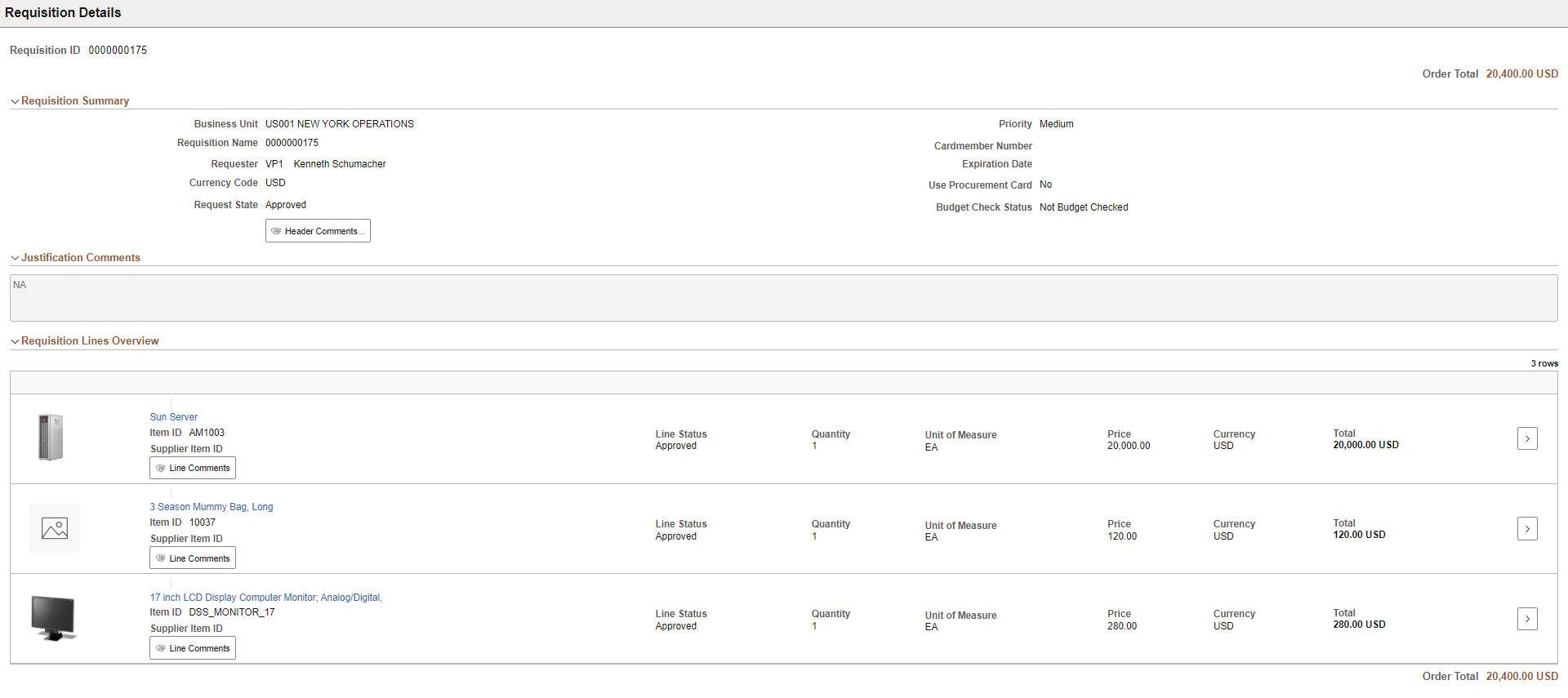

Requisition Details Page
PV_REQ_INQUIRY_FL
To get detailed information about the requisition, including comments, attachments, item descriptions, schedules, distributions, and line details.

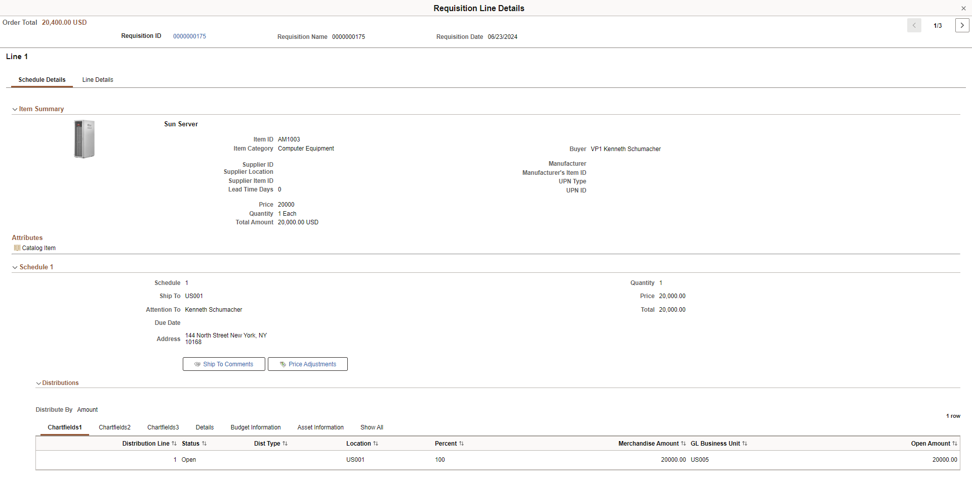

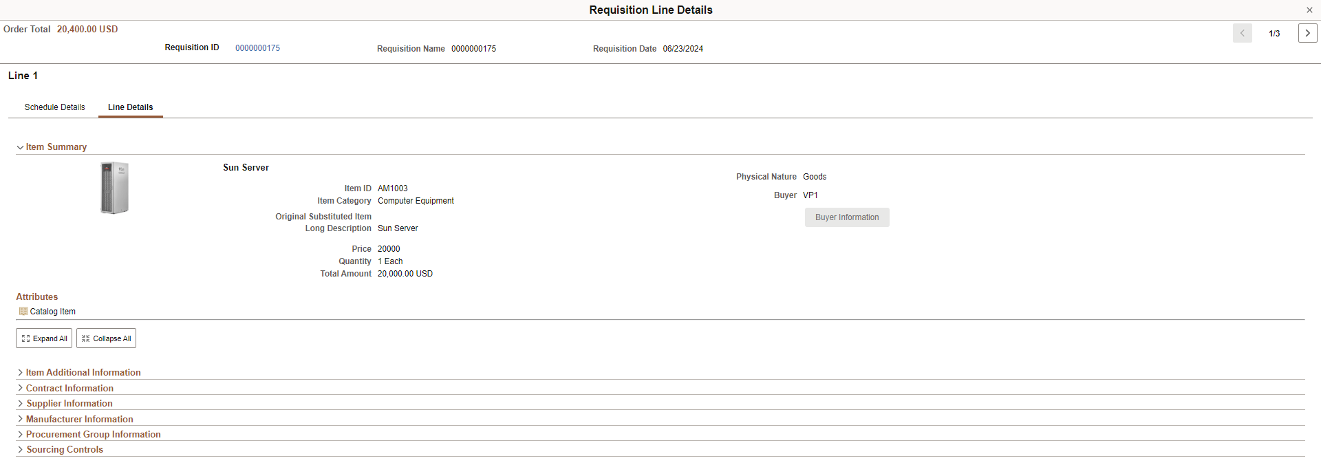

Requisition Line Details - Schedule Details and Line Details Page
PV_REQ_SCH_DIS_SCF
View the requisition line and schedule details for the selected line item.

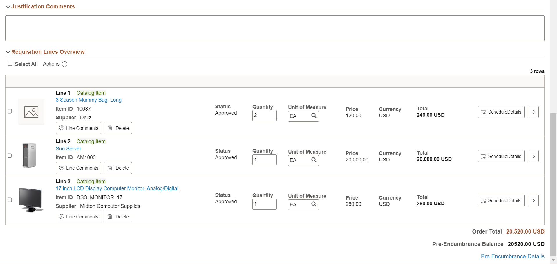

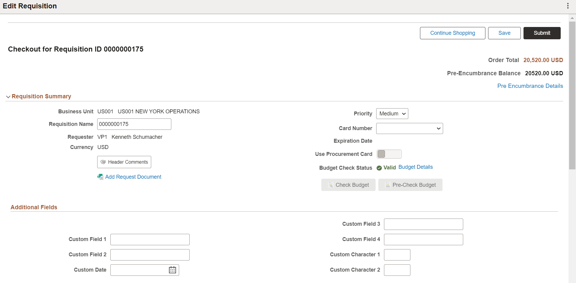

My Requisition - Edit Requisition Page
PV_MOB_NEW_CHEKOUT
To review the contents of the requisition, make final adjustments to quantity and UOM, add last-minute items to the requisition, and to place orders.

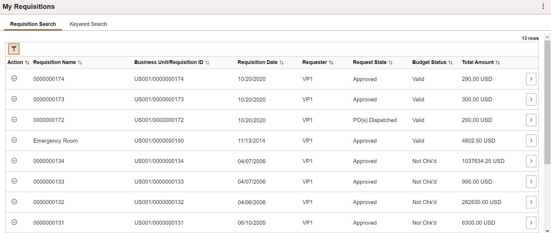

Use the My Requisitions page (PV_MOB_855_ORDR_FL) to view a list of requisitions that you have ordered.
Navigation:
Employee Self Service > eProcurement > My Requisitions
This example illustrates the fields and controls on the My Requisitions page. You can find definitions for the fields and controls later on this page.
My Requisitions
Use this page to review requisitions. From this page, you can access other pages to perform tasks, such as review requisition details, edit or cancel requisitions, create change requests, receive stock, copy requisition, view approvals, or return stock to the supplier.
The number of requisitions shown on this page depends on the configuration done on the eProcurement Installation Options page. The requisitions are displayed based on the From and Through dates, using the default timeframe of 90 days prior to the current date, and irrespective of the business unit or requester ID. The default number of results is 50. However, it is recommended to keep this value low as a large number of items may take longer to display, depending on the hardware configuration and the memory capacity of the system.
Requisition Search Tab
Requisition Search tab displays the list of requisitions based on the filters criteria.

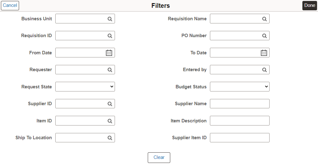

Click the Update Filters button or Filters by icon (Filters by icon) to view the Filters page. Enter search criteria on Filters page and click Done button to display the requisitions.
This example illustrates the fields and controls on the My Requisitions Filters page. You can find definitions for the fields and controls later on this page.
Field or Control
Description
Business Unit
Select the PeopleSoft business unit.
Requisition ID
Enter a specific requisition ID to display.
From Date and To Date
Enter the creation date or range of dates for the requisitions.
Requester
Enter the requester name of the requisition.
Request State
Select the state for the overall requisition (header-level) to limit the requisitions displayed to this status. Leave this field blank to display search results without using request state as a search criteria. The following search criteria are included:
  • All but Complete — Displays all requisitions except those with the state Complete.
  • Approved
  • Canceled
  • Complete
  • Denied
  • Open
  • PO Partially Canceled
  • PO Partially Completed
  • PO Partially Created
  • PO(s) Created
  • PO(s) Canceled
  • PO(s) Completed
  • PO(s) Dispatched
  • Partially Dispatched
  • Partially Received
  • Pending
  • Received
  • See Lines
Supplier ID
Enter or select the supplier ID, or use the Lookup page to select a supplier.
Supplier Name
Enter the Supplier Name.
You can enter the full supplier name or partially. Search results display the requisitions that contain or begin with the entered keyword. This field is not case-sensitive.
Item ID
Enter the item ID for a requisition line.
Ship To Location
Enter the ship to location code.
Requisition Name
Enter the given Requisition Name.
PO Number
Enter the Purchase Order Number where the requisition was sourced.
Entered by
Enter the user ID of the individual who entered the requisition. This is usually the requester but can be another individual.
Budget Status
Displays the header results of a budget check initiated by clicking the Check Budget button or the Pre-Check Budget button. The options are:
  • Valid: The requisition passed budget checking and the Budget Processor has updated the control budget ledger (LEDGER_KK).
  • Not Budget Checked: The Budget Processor has not processed the requisition.
  • Error in Budget Check: The requisition failed budget checking.
  • Provisionally Valid: The requisition passed budget checking but no pre-encumbrance was created in the control budget ledger.
  • Document In Processing
Item Description
Enter the item description used by the supplier for the item.
Supplier Item ID
Enter the item ID used by the supplier for the item.
From Date is defaulted to the last 90 days. If all the fields are left blank on the Filters page except for Business Unit then all the requisitions are retrieved for that Business Unit. Filters page allows to enter partial values and the 'contains' operator is applied to bring results.

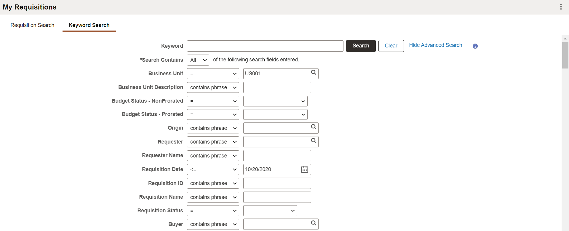

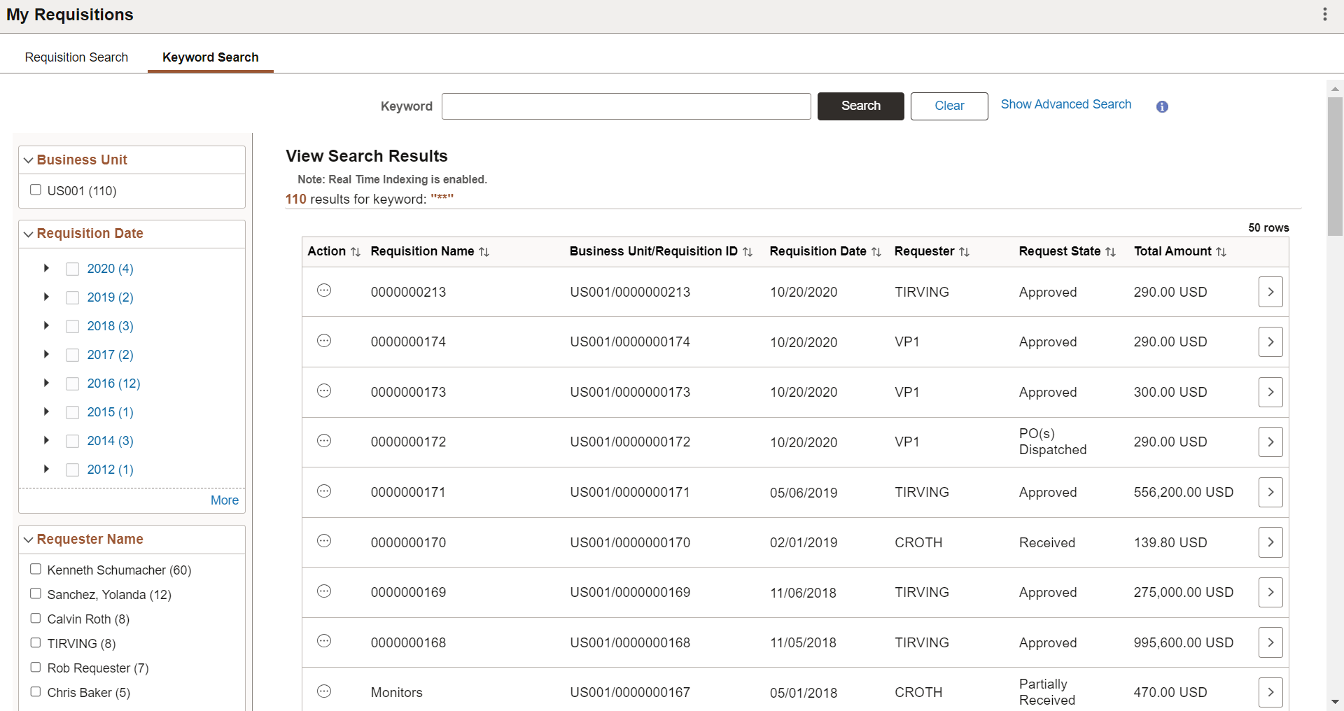

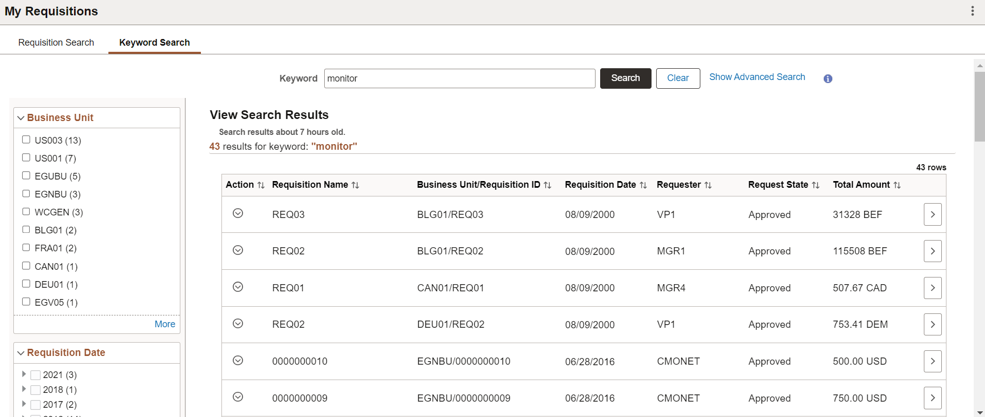

Keyword Search Tab
Enter a word (for example monitor) or a string of characters in the Keyword Search box, and then click the Search button to display the requisitions having keyword.
This example illustrates the fields and controls on the My Requisition Keyword Search page. You can find definitions for the fields and controls later on this page.
My Requisitions Keyword Search
The facets on this page enable you to quickly and easily filter your search results. When you click a facet link, the system displays only the search results associated with the facet. If you select multiple facets, the system filters the search results so that only the search results associated with all of the facets appear.
The available facets are Business Unit, Requisition Date, Requester Name, Budget Checking Header Status, Supplier Name, and Requisition Status.
Field or Control
Description
Clear
Click to clear the search result and start a new search entry.
Keyword Search Tips
(Search Tips)
Click Search Tips icon to view the General Search Guidelines for Keyword Search.
Advanced Search
Click Show Advanced Search to expand this section to enter much more specific search criteria. In addition to entering values for fields, you can select operands for those field values. For example, if you want to search for requisitions created on 20.10.2020, you can select = and enter same date in the Requisition Date criteria field.
This example illustrates the Advanced Search criteria that you can use to search for positive input entries.
My Requisitions Advanced Search
This is an example of search results generated using Advanced Search criteria.
My Requisitions - Advanced Search Results
Requisitions
This group box displays requisitions based on the search criteria. Basic information about the entire requisition (requisition header-level) is displayed for each requisition. You can view additional information, including line details by using the details icon.
Field or Control
Description
Actions
Select the Actions icon to perform the following related action on the requisitions:
  • Check Budget — Select to budget check the requisition. You can budget check only when the Request state is approved.
  • Edit — Select to access the My Requisition - Edit Requisition Page where you can make changes to the requisition and submit it again. You can edit requisitions in Open, Pending or Approved status only.
  • Cancel — Select to cancel requisition.
  • Details — Select to access the Details Page.
  • PreCheck Budget
  • Copy — Select to copy the requisition including its header, line, schedule, and distribution details. If the requisition has header comments, line comments, schedule comments, attachments, and one time address records, the action copies them too. After copying the items, the Shopping Cart page displays. The newly added items are not saved to the existing shopping cart.
  • View Print — Select to view the print format of the selected requisition.
  • Create Receipt — Select to Create Receipt for the requisition. If the requisition Request State is Partially Dispatched or PO(s) Dispatched, then Create Receipt action is available.
  • Create Return — Select to Create Return for the requisition. If the requisition Request State is Partially Received or Received, then Create Return action is available.
  • Inquiry — Select to view the Requisition Details page. For more information, see Requisition Details Page.
Note: The options that appear for a requisition differ depending on the status of the requisition. For example, you cannot cancel a requisition for which a PO is created.
Requisition Name
Displays the description of the request entered by the requester when the requisition was added. The requisition name helps to identify this requisition as it flows through the system. If no requisition name was entered, then the requisition ID is displayed.
Business Name/Requisition ID
Displays the PeopleSoft Purchasing Business Unit and requisition ID for this requisition.
Requisition Date
Displays the date the requisition was created.
Requester
Displays the ID of the requester who created the requisition.
Request State
This state field displays the request state across the entire procurement cycle, not just the requisition header state. The following states are included:
  • Approved: The requisition have been approved and is ready for sourcing. For this status to display at the header level, all lines of this requisition must be in the Approved status.
  • Cancelled: The requisition was entered and saved but then the entire requisition or each requisition line was canceled. For this status to display at the header level, all lines of this requisition must be in the Canceled status. A canceled requisition can be reopened within a certain number of days as specified for the Purchasing business unit; otherwise, it is closed permanently.
  • Complete: The requisition is marked complete after the requisition is dispatched on a PO, the goods are received and the supplier is paid. A background process identifies the requisitions and moves them to the complete status. Canceled requisitions and those that are fulfilled by inventory stock are also identified as complete.
  • Denied: The entire requisition or each requisition line has been denied in the approval process. For this status to display at the header level, all lines of this requisition must be in the Denied status.
  • Open: The requisition has been entered and saved but not yet submitted. For this status to display at the header level, all lines of this requisition must be in the Open status.
  • PO Partially Canceled: The requisition contains some lines that have been placed on purchase orders and these purchase orders have been subsequently been canceled. For this status to display, the purchase orders must all have the same status, Canceled. This status indicates that some of the requisition lines have not been sourced to a purchase order and it also indicates that none of the lines have been received or returned to supplier.
  • PO Partially Completed: The purchase order has been closed for some of the requisition lines , however the requisitions are not yet closed.
  • PO Partially Created: The requisition contains some lines that have been sourced to an approved purchase order. For this status to display, the purchase orders must all have the same status, Approved. This status indicates that some of the requisition lines have not been sourced to a purchase order and it also indicates that none of the lines have been received or returned to supplier.
  • PO(s) Created: The requisition has been placed on a PO that has been approved. This header status indicates that all lines of this requisition have been sourced to approved purchase orders and the requisition line status is PO(s) Created. For this status to display, the purchase orders must all have the same status, Approved.
  • PO(s) Cancelled: The requisition has been placed on a PO that has been subsequently been canceled. This header status indicates that all lines of this requisition have been sourced to canceled purchase orders and the requisition line status is PO(s) Canceled. For this status to display, the purchase orders must all have the same status, Canceled.
  • PO(s) Completed: The purchase order has been closed for all of the requisition lines , however the requisitions are not yet closed.
  • PO(s) Dispatched: The requisition has been placed on a purchase order and the purchase order has been dispatched to the supplier. This header status indicates that all lines of this requisition have been sourced to dispatched purchase orders and the requisition line status is PO(s) Dispatched. For this status to display, the purchase orders must all have the same status, Dispatched.
  • Partially Dispatched: The requisition contains some lines that have been placed on purchase orders and these purchase orders have been dispatched to the supplier. For this status to display, the purchase orders must all have the same status, Dispatched. This status indicates that some of the requisition lines have not been sourced to a purchase order and it also indicates that none of the lines have been received or returned to supplier.
  • Partially Received: The requisition contains some lines that have been placed on a purchase order, the purchase order has been dispatched to the supplier, and the goods have been fully or partially received. This status indicates that some of the requisition lines have not been received.
  • Pending: The requisition has been submitted and is awaiting approval. This header status indicates that all lines of this requisition have the line status of Pending.
  • Received: The requisition has been placed on a purchase order, the purchase order has been dispatched to the supplier, and the goods have been fully received. For this status to display at the header level, all lines of this requisition must be in the Received status.
  • See Lines: The lines of this requisition are in various stages of the approval process and the lines have different statuses (i.e. pending, approved, denied, and so on); however, none of the lines have been sourced to a purchase order.
Total Amount
Displays the total price amount of all the items in the requisition.

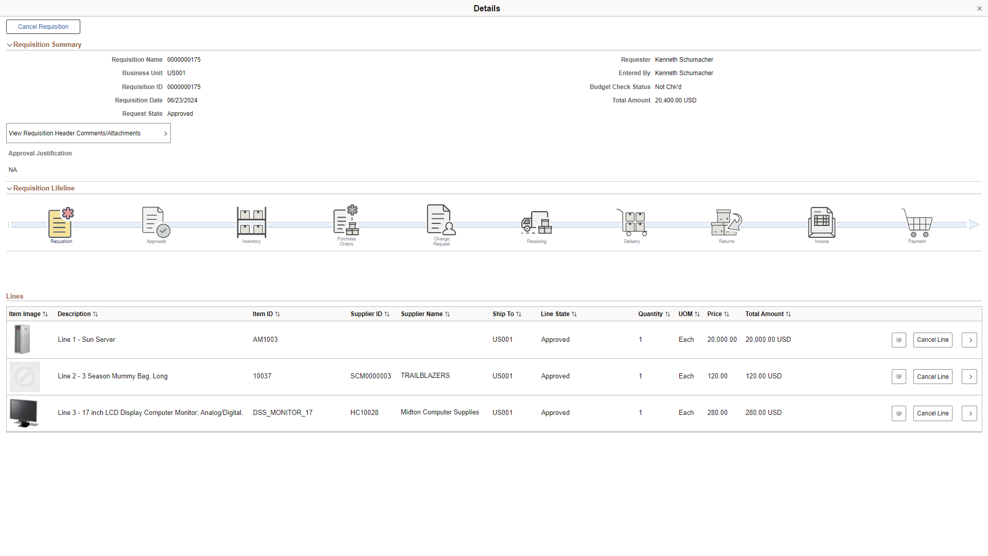

Use the Details page (PV_MOB_855_ORDRSCF) to view the requisition summary, requisition lifeline, and requisition lines.
Navigation:
Employee Self Service > eProcurement > My Requisitions. Select the Requisition Details icon.
Or
Click the Related Actions icon and select Details.
This example illustrates the fields and controls on the Details page. You can find definitions for the fields and controls later on this page.
Details page
Cancel Requisition: Displays if the Request State is Approved. Select to cancel the entire requisition.
Requisition Summary
Requisition Summary displays the basic details of the requisition: Requisition Name, Business Unit, Requisition ID, Requisition Date, Request State, Requester, Entered By, Budget Check Status, and Total Amount.
Requisition Lifeline
The Requisition Lifeline section displays the business process flow for a requisition with links to various documents. The business process flow or lifecycle, includes icons for requisition creation, requisition approval, sourcing to inventory stock, sourcing to a purchase order, purchase order acknowledgments (POA), advanced shipping notices (ASN), change requests, receiving, returns, invoices, and payment. The icons are highlighted when the requisition has completed the step. Some of the icons link you to additional information on a separate page. In order to view the POA and ASN icons you must select the Requisition Lifeline Options on the eProcurement Business Unit Options page.
Stages in the requisition cycle that are complete or in progress are highlighted with active links.

Use the Requisition Details (PV_REQ_INQUIRY_FL) page to get detailed information about the requisition, including comments, attachments, item descriptions, schedules, distributions, and line details.
Navigation:
Employee Self Service > eProcurement > My Requisitions > Action > Inquiry.
Employee Self Service > eProcurement > My Requisitions > Select a Requisition > Requisition Lifeline > Requisitions.
This example illustrates the fields and controls on the Requisition Details page. You can find definitions for the fields and controls later on this page.
Requisition Details
Note: This page displays the information in read-only mode.
Requisition Summary
Field or Control
Description
Requisition Name
Displays a description of the request to help you identify this requisition as it flows through the system. If this field is left blank, the system uses the requisition ID as the name.
Priority
Displays High, Medium, or Low to indicate the priority to the approver.
Header Comments
Select to access the Requisition Header Comments and Attachments window.
This page is also used to indicate whether the comment is sent to the supplier, show the comment at receipt, and show the comment at voucher.
Justification Comments
Displays comments to justify the need for the requisition.
Requisition Lines Overview
This section displays actions applied to the selected one or many lines.
Field or Control
Description
Item Description
Click the Item name to view the item description page.
Line Comments
Select to access the Requisition Line Comments and Attachments page.
Quantity
Displays the quantity of the line item.
Note: If the Amount Only toggle is set to Yes for any requisition line, the Quantity value is set to 1 and becomes display only for that line.
Unit of Measure
The unit of measure in which the item is purchased.
Price
Displays the item price per unit.
Currency
Displays the currency of the price.
Total
Displays total price for the items on that line.
View Details
View Details icon
Select to access the Requisition Line Details - Schedule Details and Line Details Page.
Use the Requisition Line Details (PV_REQ_SCH_DIS_SCF) page to view the requisition line and schedule details for the selected line item.
Navigation:
Click View Details icon for any of the item.
This example illustrates the fields and controls on the Requisition Line Details - Schedule Details page. You can find definitions for the fields and controls later on this page.
Requisition Line Details page displays the Order total amount, Requisition ID, Requisition name, and Requisition Date.
Note: This page is view only when accessed from the My Requisition page.
Item Summary
Item Summary displays item information, such as Item Image, Item ID, Item Category, Supplier ID, Supplier Location, Supplier Item ID, Lead Time Days, Price, Quantity, Total Amount, Buyer, Manufacturer, Manufacturer's Item ID, UPN Type, and UPN ID.
If you have substitute items defined for the original item, displays the original Item ID on the transaction line that was replaced when a Substitute Item was found. Once the field is populated, the original Item ID will not be overridden with another Item ID. If the Item ID field is changed directly by the Requester or Buyer, the Original Substituted Item field is cleared. Similarly, if the Supplier ID/ Location field is changed by the Requester or Buyer, then the value in the Original Substituted Item field is cleared and the value is moved back to the Item ID field. The substitute items icon helps the Requester or Buyer to know whether the item has been substituted. This appears on a transaction line whenever the Original Substituted Item field is populated. If Original Substituted Item and Description fields are already displayed in the component, i.e. Requisition and PO, a text ‘Substitute Item in Use’ will appear.
Use the Next or Previous icon on the top right to review each line item.
Field or Control
Description
Ship To
The location code that indicates the location where the supplier should deliver the items.
Attention To
Displays the name of the individual who should receive the items or services on this requisition line.
Due Date
The date the requester would like the items to arrive at the Ship To location.
Address
Displays the shipping address of the item.
Quantity
Displays the total requested quantity.
Price
Displays price of each item.
Total
Total price of the number of items requested for that line.
Schedule VAT
Click the Schedule VAT icon to access the VAT Information for Schedule page, where you can review value added tax (VAT) information for the schedule line. The icon does not appear when the Calculate VAT on Req check box at Purchasing business unit level is not selected, the purchasing business unit is not in a VAT environment , or the VAT_DETAILS eProcurement role action is not used and the user eProcurement role is not added to the user ID profile. Using this page, you can override the recovery percentage and rebate percentage, and recalculate or reset VAT defaults changes that are made to VAT determinants.
See Understanding VAT.
Ship to Comment
Click Ship to Comments button to view comments and attachments.
Price Adjustment
Click Price Adjustments button to view the price adjustments for the schedule.
PO Information
This link appears if the requisition item is sourced to PO. Click this link to view the PO information that opens in a secondary page.
Field or Control
Description
Receipt Status
Displays the receipt status for this PO. Values include:
PO Not Received: No quantities for this PO line have been received.
PO Partially Received: Part or all quantities for this PO line have been received. Even if the quantity is fully received, the status does not change until you run the Match Request process in PeopleSoft Payables.
PO Received: All quantities for this PO line have been received. Run the Matching process (AP MATCHING) in PeopleSoft Payables.
View Receipt
Click the View Receipt button to access the Receipt For a Casual User page. This button appears if a receipt was recorded for this line.
Requisition Line Details - Distribution Details
Distribution displays Accounting Tag information, ChartFields, and access Budget and Asset information.
Field or Control
Description
ChartField
ChartField Display Templates are used to extend ChartField configuration to control the display of individual ChartFields on PeopleSoft Fluid components. It displays ChartFields in a consistent manner on PeopleSoft Fluid transaction pages across PeopleSoft products.
Distribution VAT
Click the Distribution VAT icon to access the VAT Information for Distribution page, where you can review value added tax (VAT) information for the distribution line.
This button only appears when the Calculate VAT on Req check box for Purchasing business unit is selected, the purchasing business unit is using a VAT environment, or the VAT_DETAILS eProcurement role action is used.
Exchange Rate Detail icon
Click to view the exchange currency information and the exchange rate.
Custom Fields
Click to view the Custom Fields for Line 1 and Schedule 1 and Distribution 1 page that opens in a pop-up window. The custom field values appearing on this page are display only.
Chartfields
Chartfields displays the distribution line details.
Field or Control
Description
Distribution Line
Displays the number the system assigned to this distribution. The system uses this numbering to distinguish between multiple distributions for a single requisition line.
Status
Distribution statuses include:
Open: The distribution line is open.
Complete: The distribution line is closed.
Processed: The distribution line has been processed and is unavailable for sourcing.
Canceled: The distribution has been canceled.
Dist Type
Displays the distribution type that was selected for the requisition line. Values are Labor and Expense.
Merchandise Amount
Displays the supplier's unit price and currency for the item, which are assigned on the Supplier's UOM & Pricing Info (supplier's UOM and pricing information) page.

Requisition Line Details - Line Details
This section displays additional details for a line, such as the buyer, supplier, and other line-specific information.
Navigation:
Select Line Details on the Requisition Line Details page
This example illustrates the fields and controls on the Requisition Line Details - Line Details page. You can find definitions for the fields and controls later on this page.
Field or Control
Description
Buyer
Displays buyer name.
Buyer Information
Select to access the Buyer Telephone Information window, which displays the buyers name, telephone, and fax number.
Show Configurator
Select to access the Item Configuration Information window, where you can select an Inventory Unit and Configuration Code.
Item Additional Information
Field or Control
Description
Device Tracking
Displays whether a receipt line is device tracked. See Using Device Tracking
Stockless Item, ,
Aagreement has been set up with the supplier to supply this item for par inventory replenishment.
RFQ Required
Item must go through the RFQ cycle before it can be included on a purchase order.
Inspection Required
Inspection required for the item.
Amount Only
Displays Yes to indicate that the line is an amount only line.
Auto Item Substitution
Indicate that item substitutions can be determined by the system. This is determined by Purchasing business unti.
Contract Information
This link appears if a contract ID has been assigned to the requisition line. Click this link to view contract details that opens in a secondary page.
The PeopleSoft eProcurement, PeopleSoft Purchasing, and PeopleSoft Payables applications are integrated with the procurement contract functionality to streamline the use of contacts with requisitions, purchase orders, and vouchers. As part of the contract functionality, you can set up requisitions to automatically search for a contract to use for requisitions. Applying default contract prices to requisitions enables you to receive contract prices for requisition items and to more accurately track budgets and pre-encumbrance balances.
Field or Control
Description
Contract ID
Displays the purchasing contract used to price this requisition line. The contract ID can be entered manually on the Review and Submit-Line Details page when creating and editing a requisition. A contract ID can also be added automatically by the system when you have selected the Default Contract On Req check box on the Purchasing Definition - Business Unit Options page.
Version
Displays the contract version applied to this requisition line. Multiple versions are available when you are using version control. Contract versions enable contract administrators to create and maintain multiple versions of a contract in the procurement system.
Contract Line
Displays the contract line applied to this requisition line.
Category Line
Displays the contract category line number. Categories enable you to specify groups of items on a contract, rather than having to enter the items one at a time.
Supplier Information
Field or Control
Description
Supplier ID
Displays the ID of the supplier that supply this item.
Supplier Location
Displays the location of the supplier. The default is based on the value that is defined for the supplier.
Supplier Item ID
Displays the ID that the supplier uses to identify this item on the Item Supplier page.
Supplier's Catalog Number
Displays the Catalog Number that the supplier assigned for the item.
Item Supplier Priority
Indicates the supplier priority selected for the item. The value appears by default as a medium priority, but can be changed by the user. The updated priority appears on the Requisition Header.
Suggest New Supplier
Select this link to access the Suggested Supplier page (PV_MB_SUG_VNDR_SEC) where you can enter supplier name, address, and phone information.
Manufacturer Information
The Manufacturer information group box displays all information pertaining to the manufacturer.
Field or Control
Description
Manufacturer ID
Identifies the manufacturer of the item. This value is supplied from the Supplier’s Manufacturer Info page.
Displays the identifier that the manufacturer uses for this item when the suggested supplier supplies the item. This value appears from the Supplier's Manufacturer Info page.
UPN Type
Displays UPN Type Code.
UPN ID
Displays universal product number that is defined by a unique combination of item ID, manufacturer ID, manufacturer item ID, and Unit of Measure.
Procurement Group Information
Field or Control
Description
Procurement Group ID
Displays Procurement Group ID.
Primary Unit
Indicates that this is the primary unit for the Procurement Group.
Unit Allocation Qty
Identifies the quantity allocated per asset for the Procurement Group.
Sourcing Controls
Field or Control
Description
Consolidate with other Reqs
Displays if multiple requisitions are consolidated for the same supplier into one purchase order. This is defined at requester setup.
Calculate Price
Displays Yes if the sourcing process recalculated the item price when this requisition line enters the sourcing stage.
Override Suggested Supplier
Displays Yes the sourcing process to overridden the suggested supplier. This is determined for purchasing order sourcing.
Inventory Source Flag
Displays whether eligible requisition items are sourced from PeopleSoft Inventory, which is determined in user preferences.
Indicates that item substitutions can be determined by the system. This is determined by Purchasing business unit.
Use the Edit Requisition page (PV_MOB_NEW_CHEKOUT) to review the contents of the requisition, make final adjustments to quantity, UOM, add last-minute items to the requisition, and to place orders.
Navigation:
Employee Self Service > eProcurement > My Requisitions. Select the Action icon and then select Edit.
This example illustrates the fields and controls on the Edit Requisition page (1 of 2). You can find definitions for the fields and controls later on this page.
My Requisitions - Edit Requisition (1 of 2)
This example illustrates the fields and controls on the Edit Requisition page (2 of 2). You can find definitions for the fields and controls later on this page.
My Requisitions - Edit Requisition (2 of 2)
Field or Control
Description
Item Description
Click the item description link to view the item details.
For Catalog items, the details are read-only, whereas you can modify the details of Punchout items, Special Request items, Fixed Cost items, and Time and Materials items.
Note: If a requisition has been sourced, you will not be able to change the Quantity and UOM field values on the Checkout page. The values can be modified on the Schedule Detail page.
Quantity
Modify the quantity if required.
UOM
Modify the UOM if required.
VAT Amount (value added tax amount)
Displays the amount of value added tax (VAT) calculated on a VAT-enabled requisition. It does not appear when the Calculate VAT on Requisition check box at Purchasing business unit level is not selected, the purchasing business unit is not in a VAT environment, the VAT_DETAILS eProcurement role action is not used, and the user eProcurement role is not added to the user ID profile.
In addition, for Purchasing Requisition in a VAT enabled Business Unit, VAT Amount and icon also do not appear when the User ID Preferences - Requisition Authorizations for Allowed Requisition Actions of View/Override VAT Details is not selected.
Pre-Encumbrance Balance
Displays the pre-encumbrance balance amount after requisition is successfully budget checked. When you use commitment control, the system deducts each type of financial obligation from the budget and tracks it according to obligation type. This enables you to determine the money that you have committed in pre-encumbrances. The system extracts these values from commitment control tables by passing the business unit, document ID, and other key information that depends on the display. The system displays this field only when commitment control for purchasing is enabled and if the document has been budget checked successfully at least once. In addition, a default commitment detail ledger must be selected on the Ledgers For A Unit – Commitment Control Options page so that the accounting entries can be summarized to display the respective pre-encumbrance balance for the requisition.
Pre-encumbrance balance appears in the transaction currency of the requisition and is based on the transaction budget date, general ledger unit, and commitment control ledger group. Pre-encumbrance balance can be partially or fully liquidated from purchase orders.
Click the Pre-Encumbrance Balance amount hyperlink to view Requisition Accounting Entries. You can use this page to view accounting information details including the commitment control ledger group and transactions that have been performed against the requisition.
Delete
Click to delete selected requisition lines. You cannot delete a requisition line that has been sourced to a purchase order. You cannot use this button to delete a requisition line that has not passed budget checking when Commitment Control is used.
Save
Click to save the requisition for later review or submission.
Submit
Click to submit the requisition for approval, sourcing, and dispatching to a supplier.
The Quantity and UOM values are retained the next time the Checkout page is accessed. You have the options to continue shopping, save your modifications, and submit the requisition.
Note: Use Header Comments, Line Comments, and Ship to Comments to open the respective page where you can add or delete one or more supporting documents and comments. The system displays an error message if you try to load more than the number of attachments specified on the Installation Options - Multiple Attachments Page for Purchasing product.
Note: If you have changed a requisition, upon submission, the Change Request/Line Approval Summary page is displayed with the details such as, line number, item description, change request status. The Line Re-Approval details are displayed only if the required Approval Framework Control options are selected on the Purchasing Definition - Req Change Options page.
