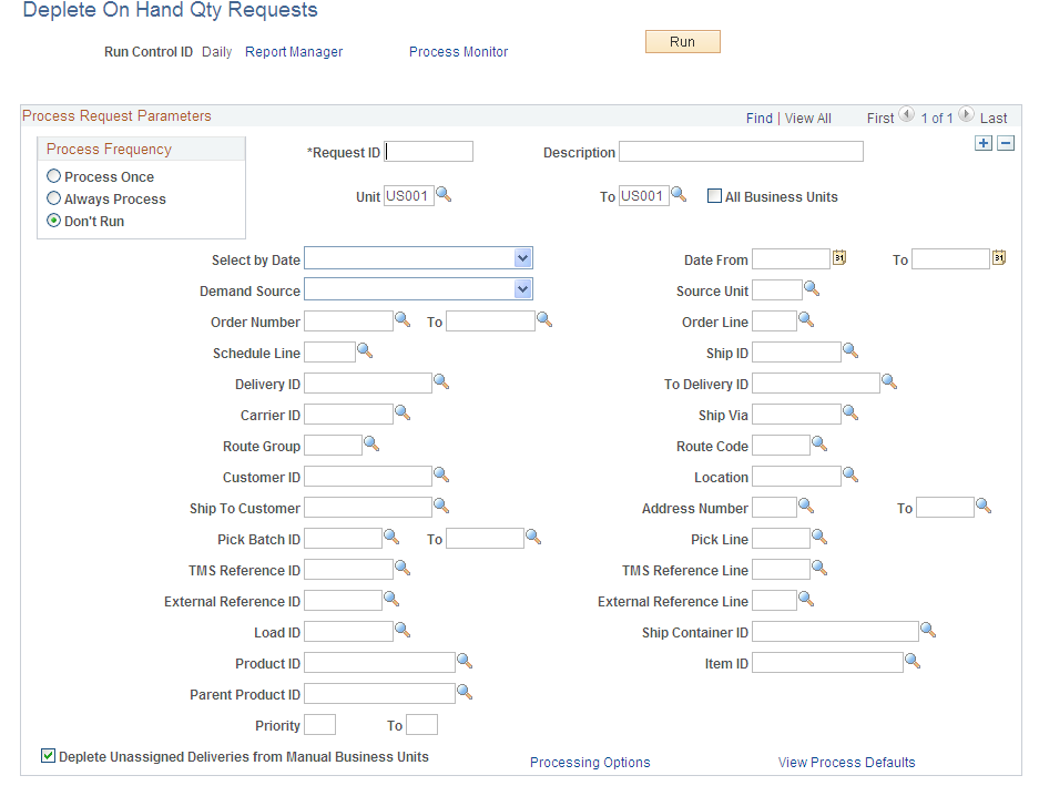

Use the Deplete On Hand Qty Requests page (RUN_IN_FULFILL_DPL) to establish parameters for a stock depletion request.
Navigation:
This example illustrates the fields and controls on the Deplete On Hand Qty Requests page. You can find definitions for the fields and controls later on this page.
See Common Elements Used in Understanding Shipping Rules.
Field or Control |
Description |
Deplete Unassigned Deliveries from Manual Business Units |
Select this check box to deplete demand lines that are not assigned to a delivery ID. This check box is only displayed if you have chosen the value of Manual in the Delivery Option field of the Setup Fulfillment-Delivery/Freight page. |
