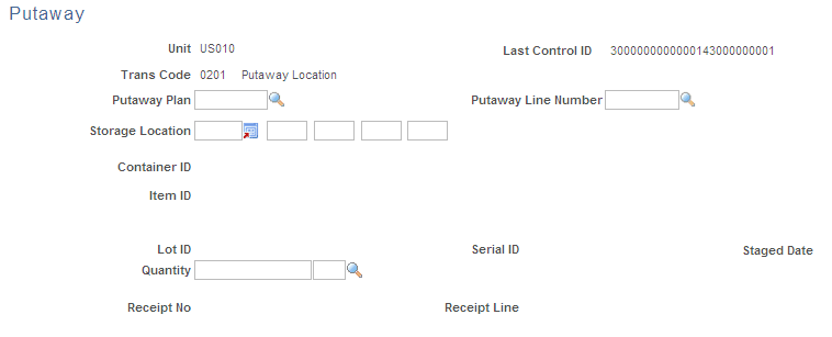

Use the Inventory Putaway page (BCT_INV_PUTAWAY) to enter stockroom putaway information using an electronic data collection system.
Navigation:
This example illustrates the fields and controls on the Inventory Putaway page. You can find definitions for the fields and controls later on this page.
Transaction code options are:

The remaining fields are available for entry only if you are conducting a Putaway Location transaction code.
If you enter a Putaway Location transaction code and then enter a Putaway Plan Line Complete transaction code for the same line, only the remaining open quantity for the line is put away into the originally entered material storage location. Similarly, if you enter a Putaway Plan Complete transaction code after entering either a Putaway Location or Putaway Plan Line Complete transaction code for the same line, only the remaining open quantity for the plan is put away into the originally planned material storage location.
Note: The business unit's default display options determine how many location levels appear upon entry to this page. If you are entering a material storage location that requires additional levels, enter the storage area, then refresh the page to display the remaining levels for that area.
Note: The business unit defaults established on the Inventory Display Options page govern whether lot, serial, staged date, and configuration fields appear upon entry to this page. Any fields for which the default is Yes always appear. Any fields for which the default is No appear when you save or refresh the page, and only if they apply to the item in question.
