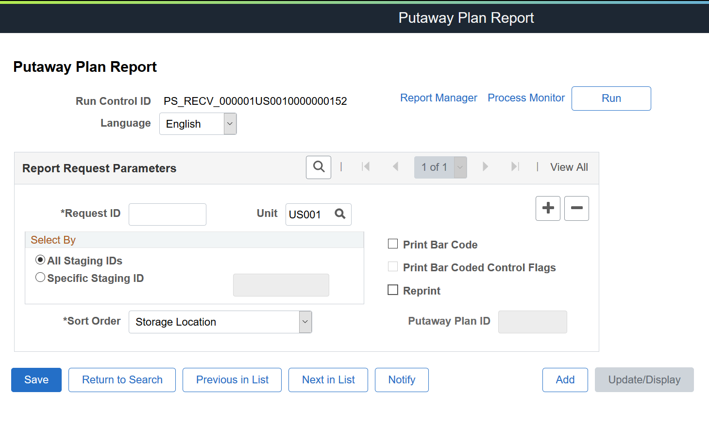

Use the Putaway Plan Report page (RUN_INS3500) to define parameters for the Putaway Plan report.
Navigation:
This example illustrates the fields and controls on the Putaway Plan Report process page. You can find definitions for the fields and controls later on this page.
All default values come from the Setup Putaway page.
Field or Control |
Description |
Reprint |
Putaway Plan ID can be selected for reprinting if a staging ID already has a Putaway Plan. Putaway Plan of Completed putaways can be reprinted only within the time period specified on the Installation Options – Inventory page. |
Putaway Plan ID |
The Putaway Plan ID field becomes editable only if you select the Reprint check box. Select the Putaway Plan ID using the prompt. The prompt displays the Putaway plan ID along with the Receipt ID and Line Number. |
