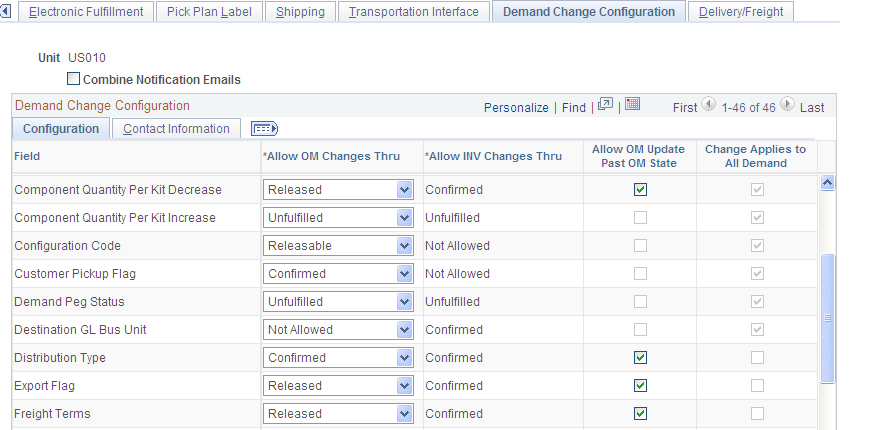

Use the Setup Fulfillment- Demand Change Configuration page (OF_SETUP9_INV) to at the inventory business unit level, view or change the system-level default values for the individual Inventory business unit.
This page defines the user's ability to change fields on a sales order during the fulfillment process.
Navigation:
This example illustrates the fields and controls on the Demand Change Configuration page at the business unit level. You can find definitions for the fields and controls later on this page.
During inventory fulfillment, any changes to sales orders entered in PeopleSoft Order Management must conform to the Demand Change Configuration parameters. The Setup Fulfillment- Demand Change Configuration page allow the user to change the system-defined default values to control which fields are restricted and when they are restricted within the inventory business unit.
Configuration tab
Field or Control |
Description |
Field |
Identifies the fields on a sales order and other settings from PeopleSoft Order Management that can be configured to be changed during inventory demand fulfillment. |
Allow OM Changes Thru |
Select the last state of the demand line that this field can be changed from the sales order. |
Allow INV Changes Thru |
Select the last state of the demand line that this field can be changed from the Maintain Stock Requests component. |
Allow OM Update Past OM State |
Select to enable changes to this field after the state defined in the Allow OM Changes Thru column. The system notifies an inventory manager when a change is made. Note: The Maintain Stock Request component will not allow changes to sales orders unless the demand line is past the last state defined here, except for the Ship To Address field and product kit component demand. |
Change Applies to All Demand |
Select if a change made to this field should be applied to all demand lines in the order. |
