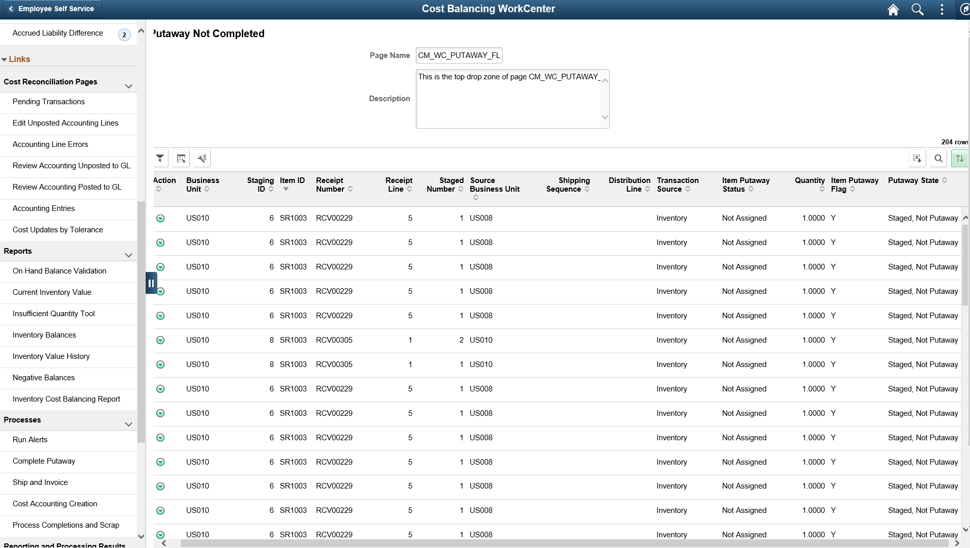

Alerts in this group maybe run in real time or batches and are listed below:
Field or Control |
Description |
Putaway Not Completed |
View non-interfaced, interfaced, load staged interface, load staged errors and stockroom feedback lines for incomplete PO, Interunit, RMA, and Manufacturing putaways. |

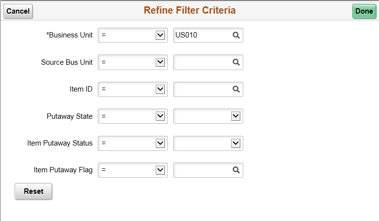

Use the Refine Filter Criteria page (EOWC_FILTER_VAL_FL) to select filter values for a pagelet.
Navigation:
Select the Refine Filter Criteria icon.
This example illustrates the fields and controls on the Refine Filter Criteria Page (ELFF). You can find definitions for the fields and controls later on this page.
Use this page to filter the results displayed on a page that is accessed from the Cost Balancing WorkCenter.
Field or Control |
Description |
Done |
Select to return to the list where your filter changes have been applied. |
Reset |
Select to restore saved filter values and disregard any changes. |

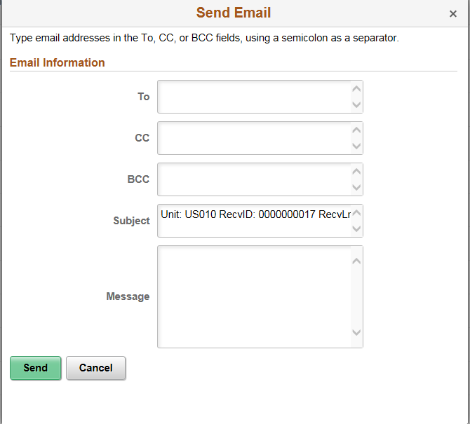

Use the Email Notification page (CM_WC_NOTIFY_SCF) to notify one or more users of an action they need to take for one or more transactions.
Navigation:
Select the Actions icon from the Fluid Cost Balancing WorkCenter and select Email Notification.
This example illustrates the fields and controls on the Email Notification Page (Fluid). You can find definitions for the fields and controls later on this page.
Email Notification is a feature that has been added to PeopleSoft WorkCenters in Classic and Fluid. The Email Notification option is added to the Action option.
Field or Control |
Description |
To, CC or BCC |
Add the users to notify. |
Subject |
The system adds this information based on the transactions selected from the previous page. You can add to and edit this field. |
Message |
Enter information to notify users based on the transactions selected from the previous page |

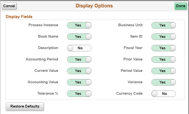

Use the Display Options page (CM_WC_USER_OPT_FL) to select fields to display on a corresponding alerts page.
Navigation:
Select the Display Options icon.
This example illustrates the fields and controls on the Display Options Page. You can find definitions for the fields and controls later on this page.
Field or Control |
Description |
Done |
Select to modify Display Fields options and return to the corresponding alerts page. |
Restore Defaults |
Select to restore default Display Field options. |

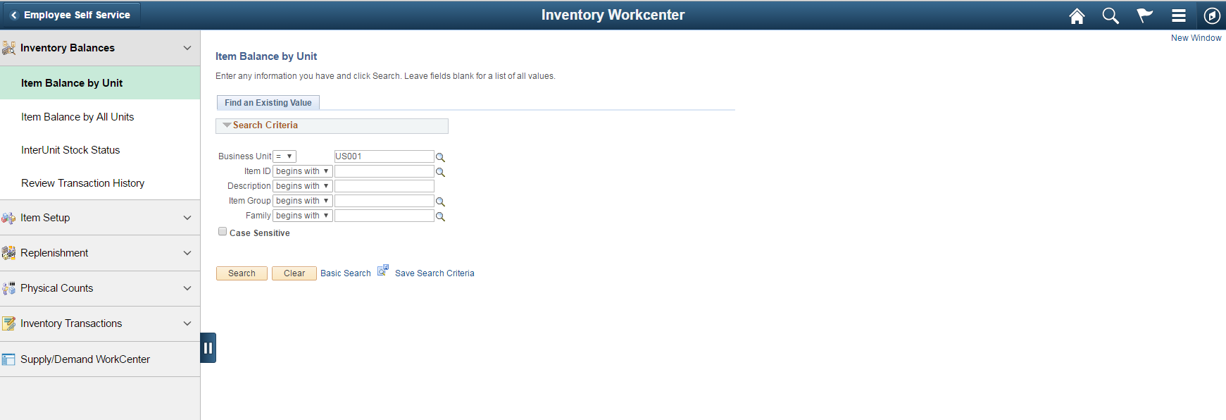

Use the Inventory tile (EP_IN_INVWORKCENTERNC_FL_GBL) to access a collection of frequently used Inventory-related components.
Navigation:
The Inventory tile is delivered as part of the home page, but the location can change if you change the delivered home pages or if administrators personalize their home pages.
This example illustrates the Inventory Tile.
Click the Inventory tile to access the Inventory navigation collections.
This example illustrates the Inventory WorkCenter.
This navigation collection enables users to access frequently used Inventory components from one location. The left panel of this page lists the components collected under seven categories:
Inventory Balances
Item Setup
Replenishment
Physical Counts
Inventory Transactions
Supply /Demand WorkCenter
The right panel displays the component selected in the left panel.
Administrators can edit these categories by navigating to the Structure and Content page (Navigation: PeopleTools, Portal, Structure and Content, Portal Objects, Navigation Collections, Inventory).
