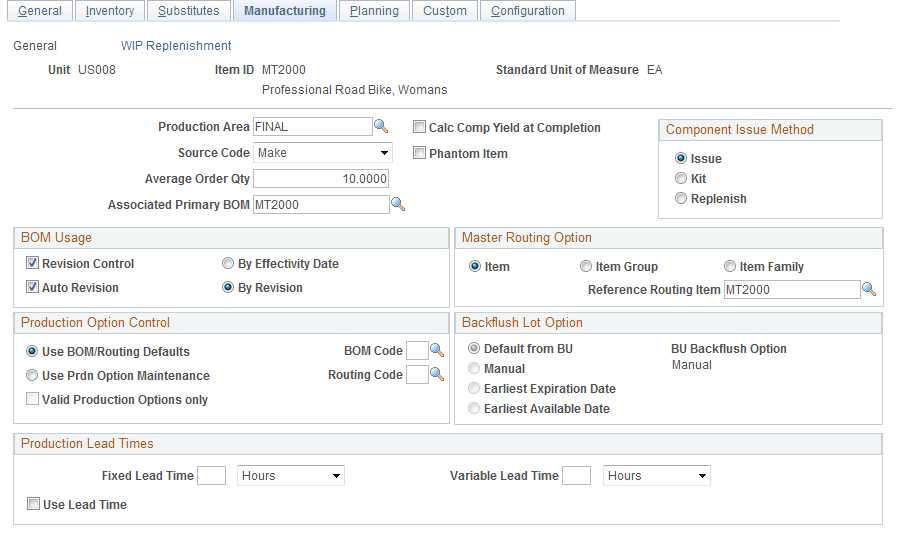

Use the Define Business Unit Item - Manufacturing: General page (GEN_ATTRIB_INV) to define production option control information for an item.
Navigation:
This example illustrates the fields and controls on the Define Business Unit Item - Manufacturing: General page. You can find definitions for the fields and controls later on this page.

Use BOM/Routing Defaults |
Use to create specific BOM and routing combinations for PeopleSoft Supply Planning. If you select Use BOM/Routing Defaults, you cannot access the production option maintenance pages for the item, but you can limit the production options that are created in PeopleSoft Supply Planning by using the BOM Code and Routing Code fields. |
Use Prdn Option Maintenance (use production option maintenance) |
If you select Use Prdn Option Maintenance for a specific item ID, you can access the specified item using the Production Option Maintenance component. With these pages, you can define specific BOM and routing combinations that can be extracted to PeopleSoft Supply Planning and used in PeopleSoft Manufacturing. You can define effective start and end dates for the combinations in addition to assigning the combinations to valid production areas. If you select Use Prdn Option Maintenance, select Valid Production Options only to use only predefined production options when creating production IDs. If any BOM or routing combination is valid, leave this blank. |
Note: You can only select Use Prdn Option Maintenance if no area or items have been defined for the specific item. If you have already assigned an item to a production area in PeopleSoft Manufacturing, you cannot select Use Prdn Option Maintenance for that same item on the Define Business Unit Item - Manufacturing: General page. You can, however, create production options by running the Autocreate Production Options process, which sets the item's Production Options group box to Use Prdn Option Maintenance rather than Use BOM/Routing Defaults.
Note: If you have marked an item to Use Prdn Option Maintenance, you must set the planning rates to be based on routings; you cannot select them to be based on lead time. If the item is already going to be produced based on lead times, you cannot select the Use Prdn Option Maintenance option on the Define Business Unit Item - Manufacturing: General page.
