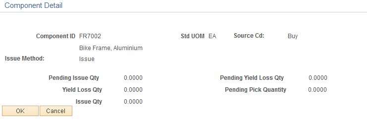

Component Detail |
SF_COMP_MAINT2_SP |
Click the Detail button. |
View component detail activity at a summary level. |

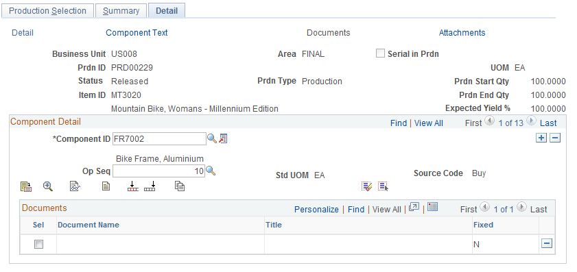

Update Component List - Detail: Documents |
SF_COMP_DC |
Associate, access, and manage pertinent component documents in the embedded document management system. You must have PeopleSoft Engineering installed to access this page. |
Update Component List - Detail: Documents Details |
DC_DOC_DETAILS_SP |
Click the Detail button for the selected document. |
View additional information about the selected document from the document vault. You must have PeopleSoft Engineering installed to access this page. |

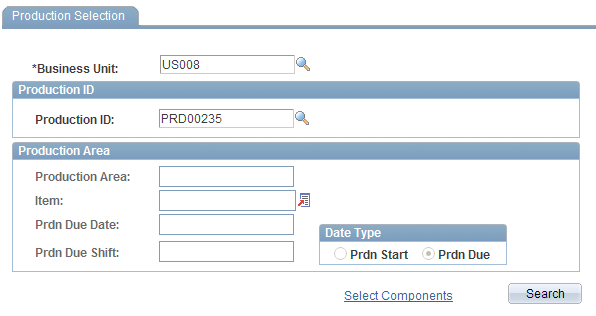

Use the Update Component List - Production Selection page (SF_COMP_MAINT_SEL) to select a specific production ID or production schedule to add, change, or delete components when the production status is Firmed, Released, or In Process.
Define at least one production ID or production schedule with a production status of Firmed, Released, or In Process.
Navigation:
This example illustrates the fields and controls on the Update Component List - Production Selection page. You can find definitions for the fields and controls later on this page.
Field or Control |
Description |
Production ID |
Select to view or maintain the component list for a specific production ID. |
Production Area and Item |
Enter values in both fields to view or maintain the component list for production schedules. The production schedule information is based on the start date of production or when production is due to be completed. |
Select Components |
Click this link to access the Component List Selection page, where you can retrieve specific components. |
Date Type
Field or Control |
Description |
Prdn Start (production start) and Prdn Start Date (production start date) |
Select Prdn Start to view the production schedules that are or were due to begin on a specific production start date. Select the production start date for the production schedule. Scroll through the list until you find the specific production schedule that you'd like to view. |
Prdn Due (production due) and Prdn Due Date (production due date) |
Select Prdn Due to view production schedules based on production due dates. Scroll through the list until you find the specific production schedule that you'd like to view. Select the production due date for the production schedule. |
Prdn Due Shift (production due shift) or Prdn Start Shift (production start shift) |
Select a valid shift for the production schedule based on either when the shift ends or when the shift begins. Note: If multiple production schedules exist for the production area/item/date/shift, then a warning appears followed by a listing of the production schedules from which you can select one production schedule to maintain. |
Search |
Click the Search button to retrieve the information associated with the production ID or production schedule. |

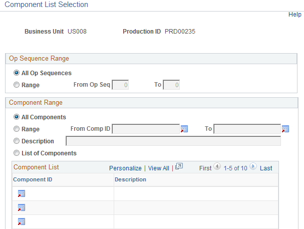

Use the Component List Selection page (SF_SELECT_COMPS_SP) to select specific components to modify.
Navigation:
Click the Select Components link on the Update Component List - Production Selection page.
This example illustrates the fields and controls on the Component List Selection page. You can find definitions for the fields and controls later on this page.
Op Sequence Range
Field or Control |
Description |
All Op Sequences (all operation sequences) |
Select this option if you do not want to filter by operation sequence. |
Range |
Enter a range of operation sequences. |
Component Range
Select one of these options:
All Components
Range
Description: Enter the words or strings included in the component's description. The system retrieves any component whose description contains the words or string that you enter in this field.
Note: The values for this field are case sensitive.
List of Components: Select specific components to retrieve.
Note: You can use both the Op Sequence Range and Component Range options to further filter the selection criteria.
Click OK to retrieve the selected components and access the Summary page.
Click Cancel to return to the Production Selection page.

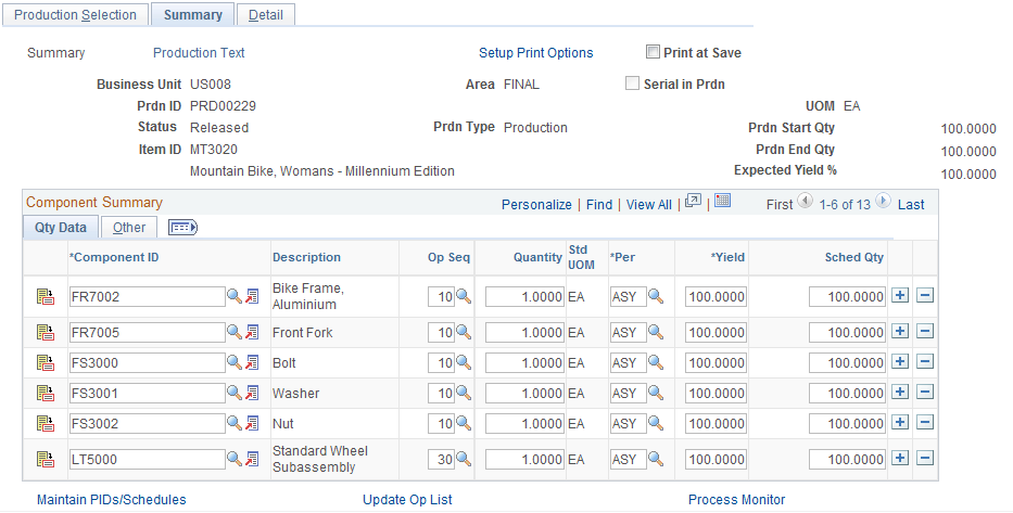

Use the Update Component List - Summary: Summary page (SF_COMP_MAINT_GRD) to add, change, or delete components when the production ID or schedule status is Firmed, Released, or In Process.
Navigation:
This example illustrates the fields and controls on the Update Component List - Summary: Summary page: Qty Data tab. You can find definitions for the fields and controls later on this page.
Field or Control |
Description |
Print at Save |
Select this check box if you want to print production documents at save time. |
Setup Print Options |
Click this link to access the Process/Output Options page to select different print criteria for the production documents. |
Component Summary
Field or Control |
Description |
Component ID |
Select the component being added. |
Item Search |
Click to search for the item ID using various search criteria. |
Op Seq (operation sequence) |
Determines where in the manufacturing process that you need the components. PeopleSoft Manufacturing uses the work center associated with each operation, and the WIP location associated with each work center to determine where to deliver components. The component's issue method in combination with the operation sequence determines when and where the material is delivered and how the system updates inventory in the WIP location or the issue quantity on the component list. When the operation sequence is set to zero or an invalid operation sequence is specified, it is assumed that the component item will be used at the first operation. In this case, PeopleSoft Supply Planning uses the recorded completions and scrap at the first operation to calculate the correct kit component quantity on hand. |
Quantity |
Enter the number of components required based on per assembly or per order. |
Per |
Displays the component requirements in amounts per Asy (assembly) with a unit of 1, or per Ord (order), an amount regardless of the order size. |
Yield |
Displays the expected percentage of usable components within a batch of components issued to production. You can change the component yield here. If you change the yield, the system recalculates the schedule quantity for the component relating to this production only. |
Sched Qty (schedule quantity) |
Enter the number of components required for the batch production. To calculate the scheduled quantity with a known quantity per assembly: Scheduled Quantity = operation start quantity * [Quantity Per Assembly / (Component Yield / 100)] |
Quantity Per Calculations
You can calculate the quantity per assembly or per order.
To calculate the quantity per assembly with a known scheduled quantity:
Quantity Per Assembly = [(Scheduled Quantity / operation start quantity) x (Component Yield / 100)] + .00005*
*.00005 is used for rounding
To calculate the quantity per order with a known scheduled quantity:
Quantity Per Order = Scheduled Quantity
Important! To provide greater accuracy when modifying component data, we don't require the Quantity field to follow the quantity precision rules defined for the item. A warning is issued if you define a decimal quantity value for an item whose quantity precision value is a whole number.
Scheduled Quantity Calculations
You can calculate the scheduled quantity per assembly or per order.
Scheduled Quantity = Production Start Quantity x [Quantity Per Assembly / (Component Yield / 100)]
Note: The production start quantity in this calculation denotes the starting quantity required at the operation sequence associated with the component. If there is no operation sequence, then the production start quantity is the starting quantity of the production ID or production schedule.
To calculate the scheduled quantity with a known quantity per order:
Scheduled Quantity = Quantity Per Order
Note: The format for the Scheduled Quantity on this page may be determined by the item's unit of measure and quantity precision combination that was defined in PeopleSoft Inventory.
Other tab
Field or Control |
Description |
Enter the operation step where the component is to be added. |
Qty on Hand (quantity on hand) |
The system displays the total, available quantity on hand for the component. |
Issue Method
When you set the component issue method to Issue, material is delivered to the work center WIP location. When you record end item completions for the operation, the components associated with that operation sequence are consumed from the work center's WIP location. At that point, the system decrements the quantity on hand in the WIP location and updates the issue quantity on the component list.
Components using the Replenishment method are handled in a manner similar to those using the Issue method. Material is delivered to the WIP location using the production replenishment pages as a result of a worklist notification.
When you record end item completions, the components associated with that operation sequence are consumed from the work center's WIP location. At that point, the system decrements the quantity on hand in the WIP location and updates the issue quantity on the component list.
If you are using PeopleSoft Flow Production, you can also replenish the WIP locations directly from an inventory location, feeder line, or supplier using Kanban Cards or online replenishment requests.
When you use the Kit component issue method, the operation sequence is only a reference for the material handler. Kitted material is delivered to the work center tied to the operation sequence, but the system charges the material directly to the production ID upon issue. The material isn't issued to the work center's WIP location, nor consumed when the operation is completed. The system updates the issue quantity on the component list when the material is released to production.
When you add a new component to the component list, the operation sequence defaults to zero. A component with an operation sequence of zero means that the component will be used at the first operation. If an invalid operation sequence has been specified on the end item's BOM, the system assumes that it will be used at the first operation.
For the phantom item's components, the system assigns the phantom's operation sequence to all of its components.
If an invalid operation sequence has been specified on the end item's BOM, or the operation sequence is set to zero, the system issues the components to the production area's WIP location. Owned components are issued only to owned WIP locations. Likewise, non-owned components are issued only to non-owned WIP locations.
Serial Control
The Serial Controlcheck box is a display-only field that indicates if the component is serial-controlled.
Teardown
The Teardown check box designates the component as a potential teardown output. This value is copied from the BOM Component Detail page. If a production ID is selected as the basis for a teardown order, the components designated as teardown are considered the outputs from the teardown production.
Substitute
The Substitute check box designates that a substitution has already taken place. This value is copied from the Component List Substitution detail page.
MES and Component Lists
When you modify a component list, if you are integrating to a third-party MES, PeopleSoft Manufacturing uses the Production Order Update EIP to publish a message to the MES with the transaction information. The MES then subscribes to that message and updates the MES information.

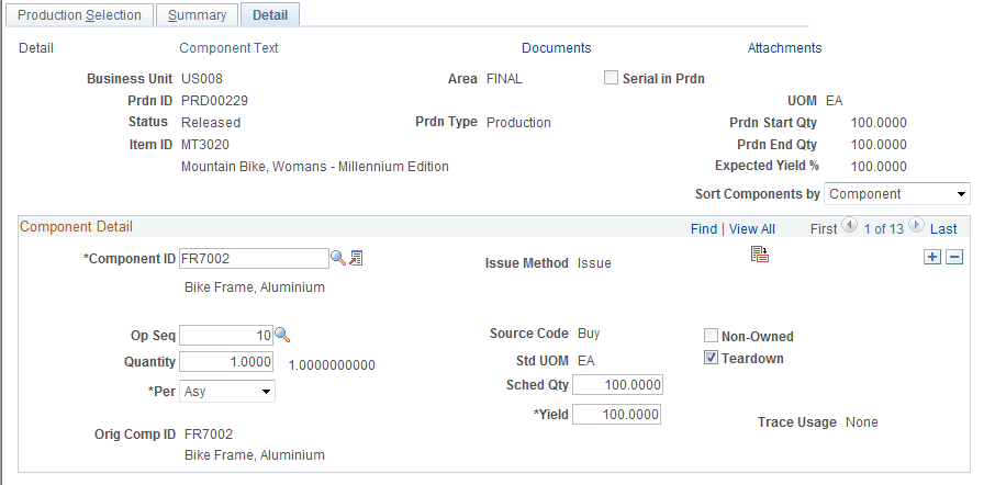

Use the Update Component List - Detail: Detail page (SF_COMP_MAINT2) to view additional information for a component.
Navigation:
This example illustrates the fields and controls on the Update Component List - Detail: Detail page. You can find definitions for the fields and controls later on this page.
Field or Control |
Description |
Component Details |
Summarizes the activity of the component for the production ID or production schedule. |
Orig Comp ID (original component ID) |
Displays the original component ID, if this component is a substitute, as well as the issue method for the component. There are several component issue methods: Production Issue, Production Kit, and Production Replenishment. |
Source Cd (source code) |
Values are Make, Buy, Expenses, or Floor Stock. |
Sched Qty (current scheduled quantity) and Yield |
Fields are display only, but you can change this information. |
Quantity |
Displays the calculated quantity per assembly or per order. The system calculates the quantity per by dividing the quantity per assembly by the BOM's BOM quantity. You designate the level of precision for the calculated quantity per in the manufacturing installation options page. |
Config Code (configuration code) |
Displays a code if the item is configured. If you add a configured item to the component list, you must add the configuration code here. Note: For serial-controlled items, values in the Quantity Per and Scheduled Quantity fields must be whole numbers. |
Non-Owned Item |
Indicates that the component is supplied by the customer or is a consigned item. Approved consigned items can be added to component lists. |
Teardown |
Designates the component as a potential teardown output. This value is copied from the BOM Component Detail page. |
Use the Component Detail page (SF_COMP_MAINT2_SP) to view component detail activity at a summary level.
Navigation:
This example illustrates the fields and controls on the Component Details page. You can find definitions for the fields and controls later on this page.
Field or Control |
Description |
Pending Issue Qty (pending issue quantity) |
Displays the quantity used based on the quantity completed at the operation multiplied by the quantity per assembly. If the component's quantity is expressed as per order, this is the per order quantity. The per order quantity is completely consumed at the first backflush. This quantity hasn't yet been consumed from the WIP location due to material shortages. |
Yield Loss Qty (yield loss quantity) |
Displays the quantity that was scrapped during the end item process and consumed from the WIP location. |
Issue Qty (issue quantity) |
For components using the Issue or Replenishment material issue method, this is the quantity that was consumed from the WIP location for the component and that was charged to work in process. For components using the Kit method, this is the quantity issued directly to the production ID. |
Pending Yield Loss Qty (pending yield loss quantity) |
Displays the quantity of components that was scrapped during the end item process but that has not yet been consumed from the WIP location due to material shortages. |
Pending Pick Quantity |
Displays the quantity that is awaiting issue to the WIP location or to the production ID to satisfy the scheduled component requirement. The pick plan has already been generated for these components but they haven't yet been reviewed and released to production. |
Use the Update Component List - Detail: Documents page (SF_COMP_DC) to associate, access, and manage pertinent component documents in the embedded document management system.
Navigation:
This example illustrates the fields and controls on the Update Component List - Detail: Documents page. You can find definitions for the fields and controls later on this page.
Note: You must have PeopleSoft Engineering installed before you can access this page.
Using the Documentum Component Options page, you control the document management buttons that appear on this page.
Component Details and Documents
The system displays all the documents associated with this component list, including the document name and title, and whether the document is fixed or not. When you fix an associated document to a page, a specific version of the document is "permanently" associated with the page.
Field or Control |
Description |
Click to view document detail. |
Click to query the Documentum database. |
Click to view document contents. |
Click to launch Documentum. |
Click to edit documents in the Documentum database. |
Click the Checkout button to check out documents from the vault. Click the Checkin button to check in documents from the vault. Click the Cancel the Checkout/Checkin button to cancel these operations. |
Click the Fix/Unfix Versions to change versions. |
Click to copy links. |
