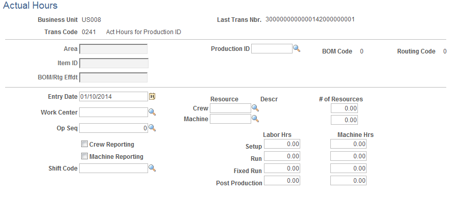

Use the Actual Hours page (BCT_MG_ACT) to enter actual hours transactions for production IDs and production schedules.
This process uses the Actual Hours EIP.

This example illustrates the fields and controls on the Actual Hours page (electronic data collection). You can find definitions for the fields and controls later on this page.
Note: You cannot enter negative hours using the data collection pages. You must correct data entry errors using negative hours with the online Actual Hours pages.
Field or Control |
Description |
Production ID |
Select a value if you're using transaction code 0241. |
Area, Item ID, and BOM/Rtg Effdt (BOM/routing effectivity date) |
Select values for these fields if you're using transaction code 0242. |
Entry Date, Work Center, and Op Seq (operation sequence) |
Enter values for these fields. You must select an operation sequence or a work center. If you select the operation sequence, the work center, crew, and machine information associated with the operation sequence appears. You can, however, change the values for crews or machines. |
# of Resources |
Displays the number of resources for the crew and machine. You can update this information. |
Work Center |
You can optionally select this option rather than the operation sequence. Once you select this field, the crew and machine information is provided based on the work center information. |
Crew Reporting |
If you select this check box, then all labor hours reported are multiplied by the number of resources associated with that crew to calculate total labor hours. |
Machine Reporting |
If you select this check box, then all machine hours reported are multiplied by the number of resources associated with that machine to calculate total machine hours. |
Labor Hrs or Machine Hrs |
Record values for these fields based on:
