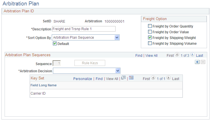

Use the Arbitration Plan page (TRFT_RULE_CD) to establish arbitration plans for transportation lead times and freight charges.
The transportation and freight arbitration plan determines the sequence in which the system searches for and applies transportation and freight arbitration plans that match the order to establish transportation lead times and freight calculations. Use the same arbitration plan for both transportation and freight charges. At order entry time, the system retrieves the transportation arbitration plan from the order management business unit. It retrieves the freight charge arbitration plan from the inventory business unit.

This example illustrates the fields and controls on the Arbitration Plan page. You can find definitions for the fields and controls later on this page.
Field or Control |
Description |
Freight by Order Quantity, Freight by Order Value, Freight by Shipping Weight, and Freight by Shipping Volume |
Select an option if you are creating an arbitration plan for internal freight calculations. By selecting only the freight charge methods that you will be using, you can limit the number of additional deliveries that are created if there is no conversion for the unit of measure. Before assigning a schedule to a delivery for the freight charge, the system checks to see if the units of measure of the schedule match the units of measure on the existing delivery. If the delivery is a new delivery, the shipment inherits the units of measure of the schedule. If the new schedule units of measure do not match the existing delivery, the system creates a new delivery. |
Default |
To establish a default arbitration plan, select the check box. After selecting this option and saving the default arbitration plan, the check box no longer appears on this page. This default it used if an arbitration plan is not specified for the PeopleSoft Order Management Business Unit on the Shipping and Returns page. |
Sort Option By |
Use to determine how the system will sort the arbitration rules. Select: Arbitration Plan Sequence: The system will select the rule based on the arbitration plan sequence. If you select this option, you will also have to select the Arbitration Decision. Note: This option is used for simple transportation lead time calculations. Longest Lead Time, Plan Seq: The system will select the rule based on the longest lead time. This option is not used for freight charges. Shortest Lead Time, Plan Seq: The system will select the rule based on the shortest lead time. This option is not used for freight charges. |
Sequence |
Displays the sequence number which is automatically generated by the system. You can change this number as long as you do not select a number that has already been used. The sequence number indicates the order in which the system searches the transportation and freight arbitration plans. |
Arbitration Decision |
Determine how to sort the arbitration rules. This option is only visible if you selected the Arbitration Plan Sequence in the Sort By Option field. Options are: Alphabetically Longest Lead Time, Alpha Shortest Lead Time, Alpha |
Rule Keys |
Click to access the Key Fields page where you can select the combination of elements that determines a match on a sales order line. The keys that you select appears in the Key Set group box. |
