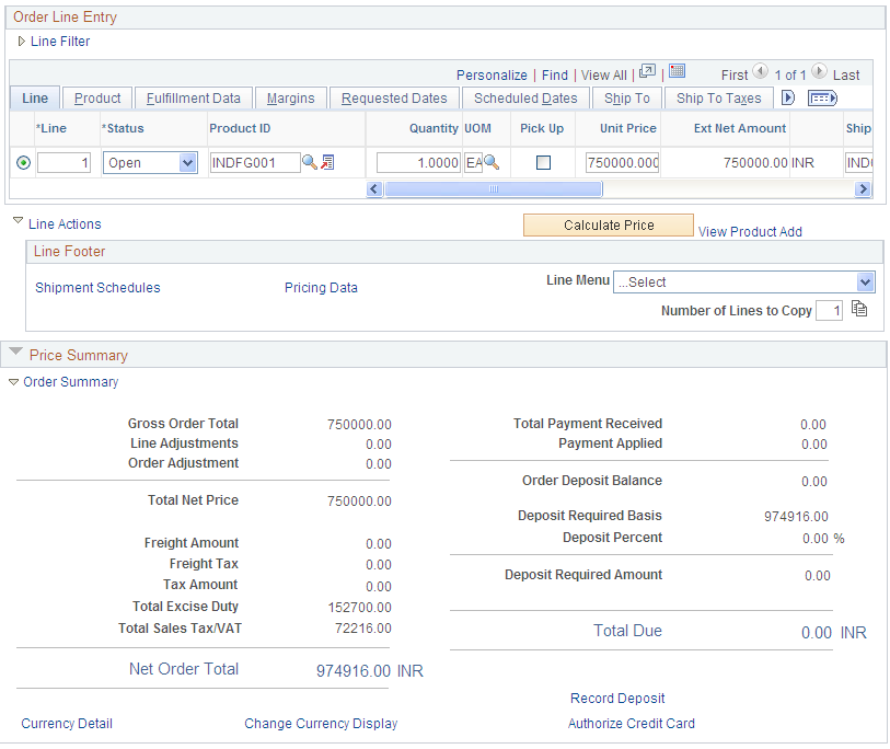

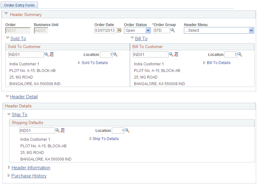

Use the Order Entry Form page (ORDENT_FORM_LINE) to modify the tax transaction type and enter customer and order information pertaining to the entire order.
You can also view total excise duty and sales tax amounts for each individual line and for the order.
Navigation:
This example illustrates the fields and controls on the Order Entry page (1 of 2). You can find definitions for the fields and controls later on this page.
This example illustrates the fields and controls on the Order Entry page (2 of 2). You can find definitions for the fields and controls later on this page.
Field or Control |
Description |
Total Excise Duty and Total Sales Tax/VAT |
You can view the values for the line from the Taxes tab and for the entire order in the Price Summary area. |
Total GST |
This field is visible only when the GST flag is enabled. You can view the values for the line from the Taxes tab and for the entire order in the Price Summary area. The Total GST will comprise of CGST, SGST, and IGST. |
Ship To |
Once Ship To Customer is selected, the system will default the GST Tax based on the Tax Setup defined in India GST. |

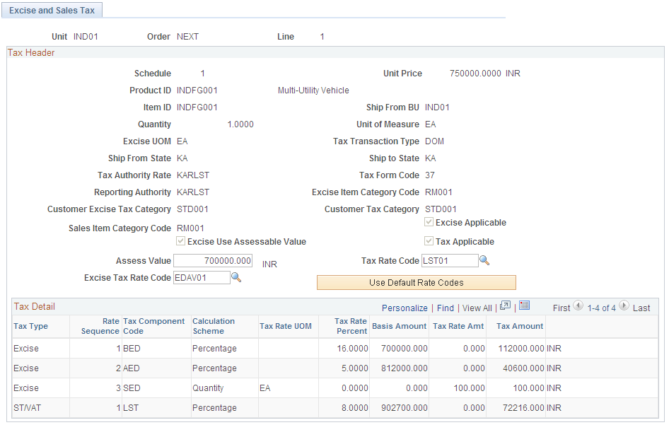

Use the Excise and Sales Tax page (ORDENT_EXS_TAX_PG) to view excise and sales taxes and modify the tax rate codes.
Navigation:
Select Excise and Sales Tax in the ...More field on the Shipment Schedules page.
This example illustrates the fields and controls on the Excise and Sales Tax page. You can find definitions for the fields and controls later on this page.
Note: If you change any of the values that can be edited (Assess Value, Sales Tax Rate Code, Excise Tax Rate Code, Use Default Rate Codes, Switch Currency Display), the Tax Calculation process uses the new values to determine or recalculate excise duty and sales tax.
Field or Control |
Description |
Excise UOM (excise unit of measure) |
Appears by default from the Item Tax Applicability page, Item Business Unit Tax Applicability page, or the Product Tax Applicability page. The calculated excise duty is multiplied by the conversion rate between the transaction unit of measure and the excise unit of measure to arrive at a final excise duty amount. |
Tax Authority Rate |
The tax authority rate is derived by using the tax determination process and assigned to the transaction. |
Tax Form Code |
Define form codes, which are groupings of form names. Form codes are assigned to tax rate codes. When a tax rate code is associated with a transaction, the form code helps determine the applicable forms for the transaction for form tracking purposes. Values are defined on the Sales Tax Form Codes page. |
Excise Use Assessable Value |
If the flag is selected, the assessable value is used to calculate the tax amounts. If the option is not selected, the Unit Price is used to calculate the tax amounts. |
Assess Value |
For items and products, this is the assessable value that is defined if you want to calculate duties based on a value other than the basic item or product value. If you edit this field, the Tax Calculation process uses this value to calculate tax amounts. |
Excise Item Category Code |
Default excise tax category code that is defined for the item. |
Sales Item Category Code |
Default sales tax category code that is defined for the item. |
Customer Excise Tax Category |
Appears by default from the Customer Tax Applicability page. |
Customer Tax Category |
Excise Tax Rate Code and Tax Rate Code |
Taxes are recalculated if you change either the Excise Tax Rate Code or Tax Rate Code field values. |
Use Default Rate Codes |
Click the link to call the Tax Determination process to determine the default excise and sales tax rate codes. Then the Tax Calculation process is called to calculate the tax amounts. |
Tax Type |
Select a tax type with which to associate the tax component code. Defining this information filters tax component codes in the Tax Rate Code table to ensure that tax rate code definitions contain only tax component code lines of the same tax type. Values are Excise (this is the default value) and Sales Tax. Note: If GST flag is enabled, the tax type is GST only. |
Tax Component Code |
You define tax components on the Tax Component Code page. Use to group tax component codes of the same tax type under a common tax rate code. |
Calculation Scheme |
Assign a default calculation scheme to the tax component code. The value that you assign here appears by default to the Tax Rate Code page, where it can be overridden. Values are: Amount: Ad hoc amount-based tax calculation. Percentage: Percentage-based tax calculation. This is the default value. Quantity: Quantity-based tax calculation. |
Tax Rate UOM (tax rate unit of measure) |
The unit of measure that is associated with the corresponding rate code. Note: If the transaction unit of measure is different from the tax rate code unit of measure, the system performs the conversion using the PeopleSoft-delivered unit of measure conversion feature. |
Tax Rate Percent |
If the Calculation Scheme field value is set to Percentage, enter a percentage that is to be applied against the taxable amount. |
Basis Amount |
Base amount against which taxes are calculated. |
Tax Rate Amt (tax rate amount) |
If the Calculation Scheme field value is set to Quantity, amount to be applied against the transaction quantity, according to the transaction quantity in the Tax Rate UOM value. Note: If the transaction unit of measure is different from the tax rate code unit of measure, the system performs the conversion by using the PeopleSoft-delivered unit of measure conversion feature. If the Calculation Scheme is set to Amount, this is the calculated tax amount. If the Calculation Scheme is set to Percentage, this field is clear and the tax calculation parameter is the Tax Rate Percent field value. |
Tax Amount |
Tax amount for the tax rate sequence. |
Switch Currency Display |
Click to switch between the transaction and base currencies. |
Ship From State |
The location from where the item will be shipped. |
Ship To State |
The location to which the item will be shipped. |
