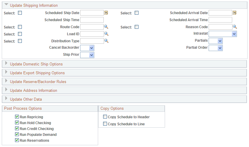

This example illustrates the fields and controls on the Run Update Schedules Page (1 of 2). You can find definitions for the fields and controls later on this page.

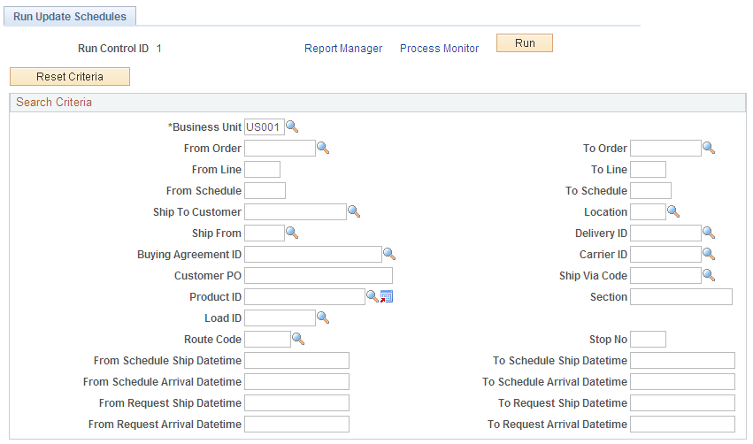

This example illustrates the fields and controls on the Run Update Schedules Page (2 of 2). You can find definitions for the fields and controls later on this page.
Field or Control |
Description |
Click the button to clear the values. |
Search Criteria |
After entering a business unit, select additional values to be updated by the OM Update Schedules process (OM_ORDCHG). |
Select |
Use to indicate that a text field is to be changed. Warning! If a check box is selected and no value is provided for the corresponding field, the Update Schedules process attempts to change the field to a blank field on all applicable schedules. |
Partials |
If Yes, Partial Order must also be Yes and you can change the value to No only. If No, Partial Order must also be No and you can change the value to Yes only. |
Address |
Enter a country code for proper address formatting. Note: If the select check box is marked and no address is provided, the address that corresponds to the schedules' ship to location is used to update the schedules in PeopleSoft Order Management and Inventory. Note: Address overrides are added or updated at the schedule level only for non-single ship orders, and at the header for single ship orders. Ship-to address updates will not occur at the line or header levels. |
Schedule Status |
You can change the field to Open or Canceled only. At the completion of the process, the status is applied to the order lines and header as applicable. For example, if all the pending schedules of a line are changed to open, the line status is changed to open, and if all order lines are changed to open, the header status is automatically changed to open. When updating the schedule status to cancel, the line will be updated to cancel only if there are no other open schedules for the line. If all schedules for the line are canceled, the line status is also set to cancel. If all lines of the order are canceled, the order will be set to cancel. |
Single ship |
You can change the field from Yes to No only. |
Run Repricing and Run Hold Checking and Run Credit Checking and Run Populate Demand and Run Reservations |
Select the processes to run after the OM Update Schedules process is run. Note: If the Order Management business unit uses deliveries or VAT parameters for a schedule need to be redefaulted, the Order Completion process (OM_BACKGRND) is always run after the OM Update Schedules process is run. The process performs repricing and attempts to update default values that were blank. |
Copy Schedule to Header and Copy Schedule to Line |
Select these boxes to copy the schedule line information to the order line and order header. The copy process is done when one or more schedule lines have been updated. When none of the checkboxes are selected and the schedule line being updated is the only open schedule line for that order line, the order line is updated with that schedule line information. Similarly, if none of the checkboxes are selected and the order line being updated is the only open line for the order, the order header is updated with that order line information. If the schedule line being updated is not the only open schedule line for that order line and the checkboxes are unchecked, the order line and order header will not be updated. |
Line and header level ship-to information, including contact, will be updated only if the ship-to customer matches the value on the updated schedules.
Note: Changes to any Export Shipping Options will only be updated on the order line if the line is marked for export. Changes to the Domestic Ship Options of carrier ID and ship via will only be updated on the order line if the line does not have a load defined for it. If the Load ID on the order schedule is being cleared, then any carrier ID and ship via changes will be applied to the order line. If any of the fields related to routes are updated on the order line, the system will recalculate the route information for the line.
