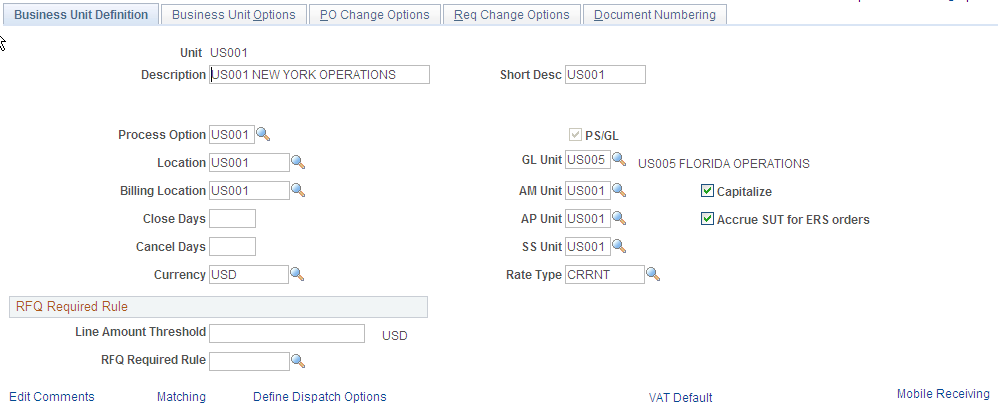

Use the Purchasing Definition - Business Unit Definition page (BUS_UNIT_TBL_PM) to create PeopleSoft Purchasing business units or update existing ones.
Navigation:
This example illustrates the fields and controls on the Business Unit Definition. You can find definitions for the fields and controls later on this page.
When you access this page in Add mode, you can enter only the unit description, default SetID, and short description. Enter this information and click the Create BU (create business unit) button, which appears only in Add mode, to create the business unit. If you access the page in Update/Display mode, the remaining fields on the page become available for entry.
Field or Control |
Description |
Process Option |
Select the processing option ID for this business unit to be used throughout the procurement cycle. Values are defined on the Purchasing Options - Purchasing Options page. This defines options such as freight terms and payment terms for the business unit. |
Location |
Select the location code for the physical location of this business unit. The system uses this code to derive the organization address that prints on dispatched transactions. Define values on the Location - Location Definition page. |
Billing Location |
Select the code for the location where invoices are sent for this business unit. Define values on the Location - Location Definition page. By default, this information appears on transactions that are created for this business unit. |
Close Days and Cancel Days |
Enter the number of days that a requisition or purchase order, or a canceled requisition or purchase order, must remain open after its last update activity before it is eligible for closure. Cancel and close days enable you to delay the closure of requisitions and purchase orders after they are canceled or entirely received. If you are using PeopleSoft Payables, you can also use cancel and close days to delay closure after requisitions or purchase orders are invoiced. Note: The close days value that you define for the business unit is for purchase order reconciliation and has no relationship to the close days value on the Close Short Run control pages. |
PS/GL (PeopleSoft/general ledger) |
Select to enable transactions for this business unit to be posted to the general ledger and to link this business unit to a VAT entity. The GL Unit (general ledger unit) field becomes available for entry. |
GL Unit (general ledger unit) |
Select a PeopleSoft General Ledger business unit. By default, this business unit appears on transaction distribution lines for this PeopleSoft Purchasing business unit. If you are linking this PeopleSoft Purchasing business unit to a VAT entity, enter the applicable PeopleSoft General Ledger business unit. You can access this link using the PeopleSoft General Ledger business unit. You cannot directly link a PeopleSoft Purchasing business unit to a VAT entity. |
AM Unit (asset management unit) |
Select the default PeopleSoft Asset Management business unit for the transactions that this PeopleSoft Purchasing business unit creates. When you create a purchasing transaction, the PeopleSoft Asset Management business unit appears by default if the item is an asset. You can override this information at the transaction level. |
Capitalize |
Select if most of the asset purchases are capital items. |
AP Unit (accounts payable unit) |
Select the PeopleSoft Payables business unit that is to be used on evaluated receipt settlement (ERS) purchases. |
Accrue SUT for ERS orders (accrue sales and use tax for evaluated receipt settlement orders) |
Select if sales and use tax (SUT) should accrue for any ERS orders that this business unit creates. |
SS Unit (strategic sourcing unit) |
Select the default PeopleSoft Strategic Sourcing (SS) business unit that is to be used for this PeopleSoft Purchasing business unit. Note: When you enter the same PeopleSoft Strategic Sourcing business unit for multiple PeopleSoft Purchasing business units, PeopleSoft Strategic Sourcing copies requisitions from multiple PeopleSoft Purchasing business units into an event. |
Rate Type |
Select the rate type to be used for currency conversion. By default, the currency code and rate type apply to all purchasing transactions for this business unit. |
Tax supplier |
Select to integrate with a third-party tax supplier for tax processing. The system calculates tax from the third-party tax supplier (Vertex or Taxware) when it creates purchase orders online or when sourcing to a purchase order. When you select this check box, depending on the tax supplier that you select, certain fields appear in the group box below this check box. Note: This check box is available only if you select a tax supplier (Vertex or Taxware) on the Installation Options - Overall page. |
Taxware Group Box
This group box is available only if third-party Taxware or Vertex software is installed, and if the Tax supplier check box is selected.
Field or Control |
Description |
Company |
Enter the tax supplier company code. This field appears for these third-party tax products: Vertex Q Series, Vertex O Series, and Taxware Sales and Use Tax. The company code that you enter in this field passes information to the third-party Taxware or Vertex software as input parameters. |
Organization |
Enter the organization. This field appears instead of the Company field for the Taxware Enterprise third-party tax product. |
Division |
Enter the tax supplier division code. This field appears for these third-party tax products: Vertex Q Series, Vertex O Series, and Taxware Sales and Use Tax. The division code passes information to the third-party Taxware or Vertex software as input parameters. |
Department |
Enter the tax supplier department. This field appears only for the Vertex O Series third-party tax product. The department code passes information to the third-party Taxware or Vertex software as input parameters. |
Use Freight Product Code |
Select this option to associate the freight with the tax supplier product code and to indicate applicable tax rates. Note: This field is available only for Taxware. |
RFQ Required Rule
Use this group box to define a threshold line amount and RFQ required rule that, when the amount is exceeded or the rule is met, requires a requisition item to go through the RFQ cycle before it is included on a purchase order.
Field or Control |
Description |
Line Amount Threshold |
Enter a threshold amount. The threshold amount is the line amount limit that triggers that an RFQ is required to source the requisition. When a user exceeds the threshold amount for a requisition line, the system resets the RFQ Required check box to be selected for that line on the requisition. For example, if you are buying something and it costs more than 1000 USD, the system requires that you get a couple of bids before it will source it to the recommended or specified supplier. |
RFQ Required Rule (request for quote required rule) |
Select an RFQ rule from the rules defined in the RFQ Required Rules component. |
Click the Go To RFQ Required Rule button to access the RFQ Required Rule page, where you can define and view details about the RFQ required rule. |
Mobile Receiving |
Use this link to access the Mobile Receiving page. |

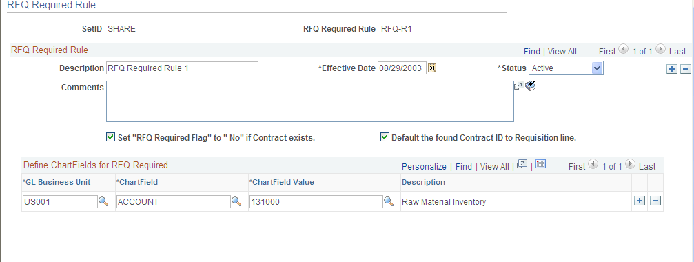

Use the Request For Quote (RFQ) Required Rule page (RFQ_REQUIRED_RULE) to define and view details about the RFQ required rule.
Navigation:
Click the Go To RFQ Required Rule button on the Purchasing Definition - Business Unit Definition page.
This example illustrates the fields and controls on the RFQ Required Rule. You can find definitions for the fields and controls later on this page.
Use this page to define ChartField values that will set the RFQ Required option to Yes for requisitions created online or through the Requisition Loader process. You can also define the RFQ Required option in the Purchasing Item Attributes or Item Category component when an RFQ is required any time that the item or category is specified on a requisition.
Some organizations require RFQ processing whenever a specific ChartField value is referenced on a requisition. For example, whenever a specified project is entered on a requisition, the funding requirements of the project require that the request go out for bid. The RFQ Required Rule page enables you to define the RFQ Required flag based on that ChartField value. When a requisition is created, the system checks the ChartField values that you define on this page and sets the RFQ Required option accordingly.
Field or Control |
Description |
Set "RFQ Required Flag" to "No" if Contract exists |
Select to bypass the RFQ cycle if a contract exists. Note: The system ignores the Default Contract on Req check box setting when the system applies the RFQ rule and you select this check box. |
Default the found Contract ID to Requisition line |
Select to supply by default the contract ID to the requisition line. |

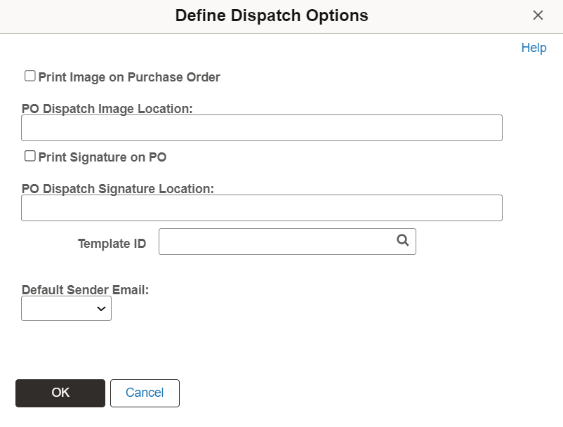

Use the Define Dispatch Options page (BUS_UNIT_PM_IMAGE) to define file directory locations for images that you want to print on purchase orders.
Navigation:
Click the Define Dispatch Options link on the Purchasing Definition - Business Unit Definition page.
This example illustrates the fields and controls on the Define Dispatch Options. You can find definitions for the fields and controls later on this page.
Field or Control |
Description |
Print Image on Purchase Order and PO Dispatch Image Location |
Select to print an image (logo) on purchase orders, and enter the directory location of the image file. |
Print Signature on PO and PO Dispatch Signature Location |
Select to print a signature on purchase orders, and enter the directory location of the signature file. |
Template ID |
Select the report template to use with this business unit to dispatch a purchase order. You use the report template to identify a BI Publisher report layout. The template provides a common report layout when dispatching purchase orders for both PeopleSoft eProcurement and Purchasing. If the Template ID field on this page is blank, then the system uses the default template on the BI Publisher Report Definition page This field appears only if you have selected the Enable XML Publisher check box on the Purchasing page of the Installation Options component. This check box selects the Oracle BI Publisher to format and print purchase orders during the dispatch process for both PeopleSoft Purchasing and PeopleSoft eProcurement. You use Oracle BI Publisher for reporting. It is a Java-based product within the Oracle Fusion Middleware family. |
Default Sender Email |
For PO dispatch email notification, select a sender email id.
Note: If Buyer or Specific is selected, it overrides the Default Sender Email configuration on the Installation Options - Purchasing Page. |
Image Locations
Consider these points when working with images and their locations:
For Structured Query Report (SQR) processes to work as designed, you must store associated images in external files.
The folder in which you store external image files must be shared.
For Microsoft Windows NT environments, define the directory locations using the universal naming convention (for example, \\server_name\folder_name\…).
When you run the PO Dispatch/Print (purchase order dispatch and print) process (POPO005), the image file to print on the purchase order is determined by the output format that you select on the Process Scheduler Request page. The PO Dispatch/Print process takes the image file name that you enter here and parses out the file extension information. The process uses this file extension to determine the image type that the PRINT-IMAGE command uses.
This table describes file extension values and their compatible image types to be used in the PRINT-IMAGE command:
File Extension |
Image Type |
No extension |
BMP-FILE |
.BMP |
BMP-FILE |
.JPG |
JPEG-FILE |
.GIF |
GIF-FILE |
.EPS |
EPS-FILE |
Others |
HPGL-FILE |
The next two tables describe output type options that are available for the PO Dispatch/Print process on the Process Scheduler Request page, along with their compatible output formats, output file extensions, and image types.
This first table represents output types for web, file, and email:
Output Format |
Output File Extension |
Image Type That Works |
CSV |
.CSV |
None |
HP |
.LIS |
HPGL-FILE |
HTM |
.HTM |
JPEG-FILE, GIF-FILE, BMP-FILE |
LP |
.LIS |
None |
OTHER |
.LIS |
None |
JPEG-FILE |
PS |
.LIS |
EPS-FILE |
SPF |
.SPF |
BMP-FILE |
This table represents output types for a printer:
Output Format |
HP |
None |
HPGL-FILE |
LP |
None |
None |
OTHER |
None |
None |
PS |
None |
EPS-FILE |
Note: The HPGL image type works with HP LaserJet printers.
Printing Images
To print an image:
Check the PSSQR.INI file to verify that the SQRDIR is set to the path where the SQR executables are stored.
Ensure that the drive that is storing the image has the correct permissions set.
Verify that the image is not corrupt.
In a UNIX environment, you can print only EPS-FILE image types.
See the product documentation for PeopleTools: BI Publisher for PeopleSoft.

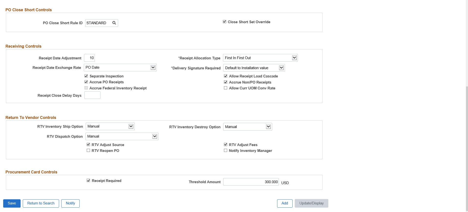

PO Close Short Rule ID |
Select the PO Close Short Rule ID from a prompt list of available Rule IDs. The Rule ID is needed for the close short process to determine a rule to close short the PO The close short will not be processed if the ID is blank. |
Delivery Signature Required |
Select an option that indicates that a signature is required from the individual receiving a Mobile Inventory delivery for this receiving business unit. Options include:
See smin, Using Mobile Delivery, Processing Deliveries Using Mobile Devices, Adding a Signature to a Delivery |
Receipt Close Delay Days |
Indicates the minimum number of days that must pass since a receipt was last updated to make it eligible for closing. |
Receipt Required |
Select the Receipt Required check box to indicate that any transaction line amount greater than the threshold amount will require attachments. |
Threshold Amount |
Enter the amount limit for a requisition line. Note: This field becomes editable if you select the Receipt Required check box. |

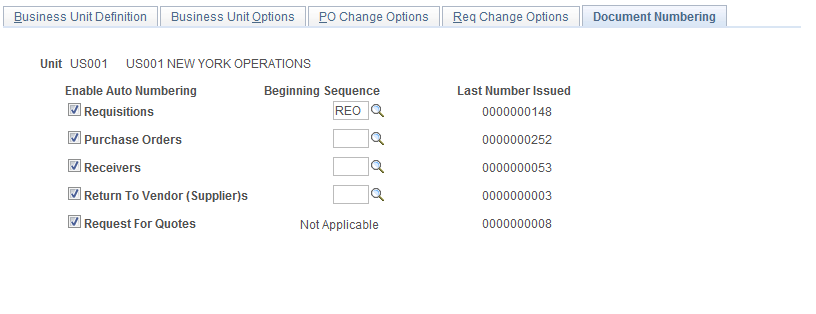

Use the Purchasing Definition - Document Numbering page (BUS_UNIT_TBL_PM3) to define transaction document autonumbering options.
Navigation:
Select Requisitions, Purchase Orders, Receivers, Requests For Quotes, and Return to Vendors to enable autonumbering for the associated transaction. The last number that was assigned for each transaction appears.
This example illustrates the fields and controls on the Document Numbering. You can find definitions for the fields and controls later on this page.
Field or Control |
Description |
Beginning Sequence |
To enter the beginning sequence number for the Purchase order, users have to create a valid auto numbering entry. If the Beginning Sequence is blank the Last Number field in the PO Business Unit will be used in the Auto Numbering routines. If the value has been entered in the Beginning Sequence field, the standard Auto Numbering will be used for the Purchase Orders. Note: When using the standard Auto Numbering, the default sequence is ignored since the Beginning Sequence value here serves as the default. |
Last Number Issued |
Displays the Last Number value stored in the Purchasing Business Unit if the Beginning Sequence is blank. If the Beginning Sequence is entered, the value displayed will be from the Auto Numbering Table |
