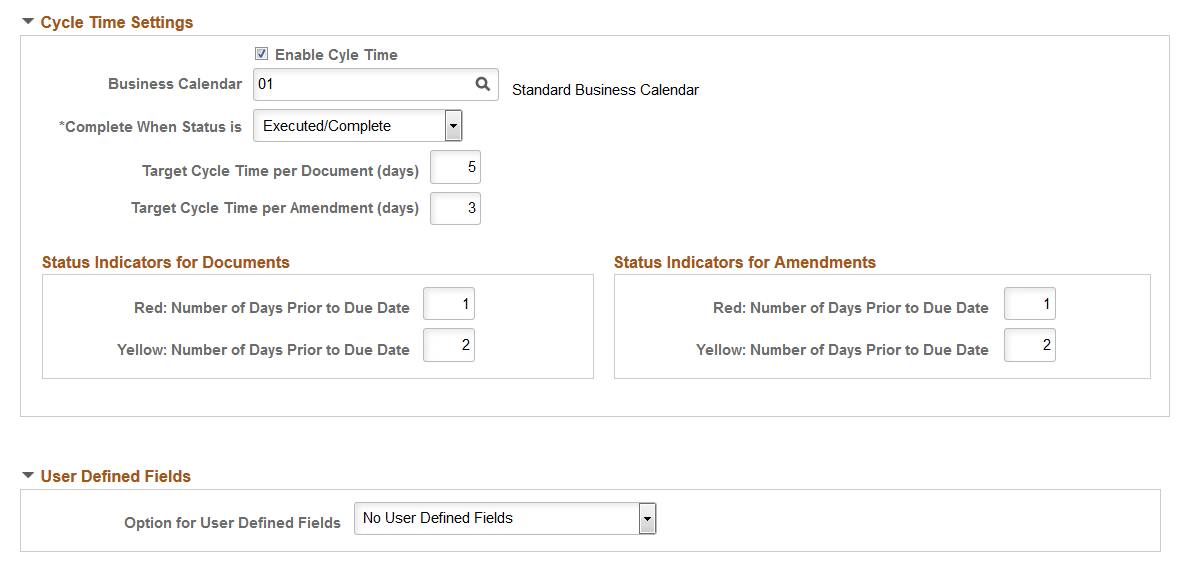

Cycle Time Settings
Use this section to define the cycle time options for a specific document type. For example, you can ensure that document requirements are achieved in a timely manner by establishing a time frame. These settings are initially defined on the Installation Options page, but you can override them on this page. After defining the settings, you can then use the Find Existing Documents page to determine which documents are overdue or close to being late.
Field or Control |
Description |
Enable Cycle Times |
Select to indicate that cycle times are enabled for this document type. When you select the check box, you can edit the remaining fields in this section. |
Business Calendar |
Select a business calendar to use for document and amendment cycle times. The business calendar is used to determine what days, such as holidays or weekends, should be removed from cycle-time calculations. |
Complete when Status is |
Select a status that indicates when the system should stop tracking the cycle time of a document. For example, you can track document cycles during critical stages when numerous reviewers or approvers are involved in the cycle and not track it for its entire review cycle; or, the organization might want to track a critical document from the beginning to when it is executed. You can end document and amendment cycle tracking when a document reaches a status of:
Target Cycle Time per Document (days) |
Enter the target number of days that a document should take to be completed. |
Target Cycle Time per Amendment (days) |
Enter the target number of days that an amendment should take to be completed. |
Red: Number of Days Prior to Due Date |
Enter the number of days prior to the due date that you want to populate the workbench with a red flag indicator. When a document falls within the number of days that you enter, the system inserts a red flag indicator on the search results for the Find an Existing Document page. |
Yellow: Number of Days Prior to Due Date |
Enter the number of days prior to the due date that you want to populate the workbench with a yellow flag indicator. |
User Defined Fields
Use this section to indicate that you want to use the user-defined fields that have been enabled on the User Defined Fields Page for this document type.
Field or Control |
Description |
Option for User Defined Fields |
Select an option that indicates how you want to apply user-defined field for the document type. Options are:
