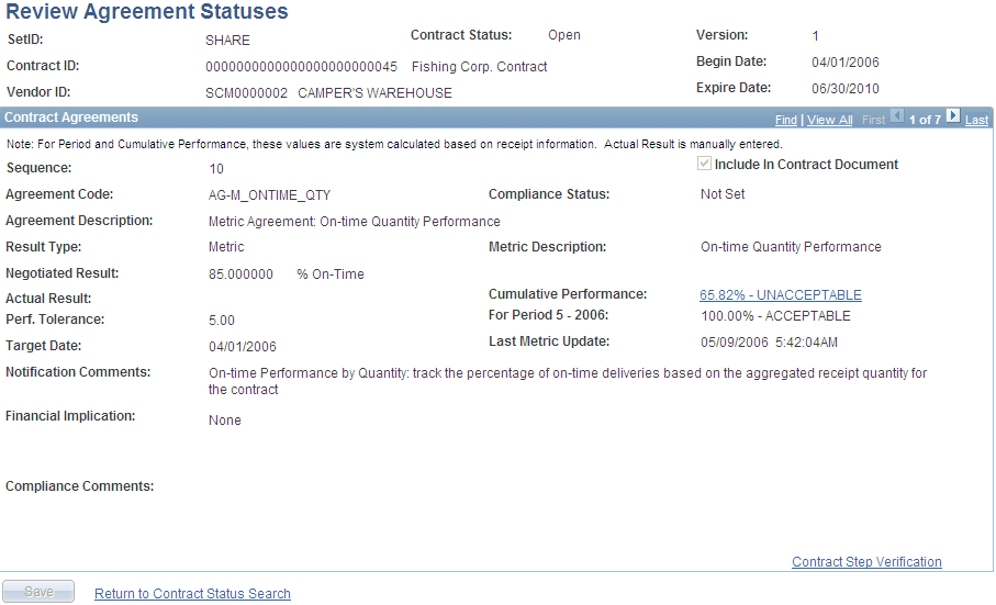

The Review Agreement Statuses page provides the supplier's Cumulative Performance value and a link to the View Supplier Shipment Performance page.
This example illustrates the fields and controls on the Update Agreement Statuses page.
Use this page to view the level of acceptance or noncompliance to the agreement.

Cumulative Performance  |
 Click the link value to access the View Supplier Shipment Performance Page.  |
