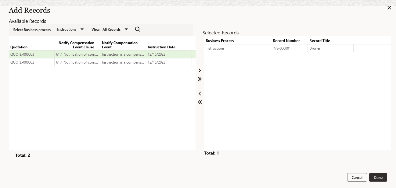

  2. Select the Add icon from the Linked Records pane. The Add Records dialogue box is displayed.
  3. From the Select Business process drop-down menu, select the business process type to open all records of that business process type.
  4. Select the records you want to link. Use the > arrow to move an individual record to the Selected Records panel, or select >> to move all records.
  5. Repeat steps 3 and 4 for other business process types.
  6. Select Done.
Add Records image
