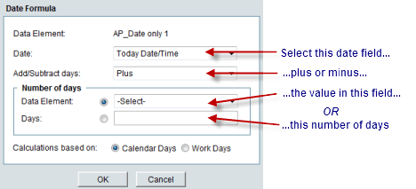

To create a date plus/minus formula:
- Open the form that contains the date field for which you want to create a formula. The Form Designer window opens.
- In the Form Designer window, select the date field for which you want to create the formula.
When the calculation is performed, this field will appear as read-only on the form and will be automatically updated whenever the fields that make up the formula change.
- Select the Formula button. A Date Formula window opens.
- For Calculations based on, choose:
- Calendar Days to calculate the formula based on calendar days. This option does not take company non-working days into account.
- Work Days to calculate the formula based on the company calendar working and non-working days.
Example:
When: Date 2 = Date 1 + 1 working day
- If Date 1 is a working day, the system calculates from the selected date and adds the number of working days. So, if Date 1 = 01/23/2023 (working day), then Date 2 = 01/24/2023.
- If Date 1 is a non- working day, the system calculates from the next working day and adds the number of working days. So, if Date 1 = 01/21/2023 (non-working day), then Date 2 = 01/24/2023 because the system calculates from 01/23/2023 at 12.00 AM
