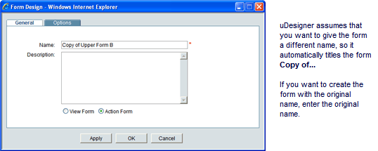

Creating a New Form or Workflow From a Snapshot
You can use a snapshot to insert a new form or workflow into a design.
To create a new upper form from a snapshot:
- Go to the Company Workspace tab, and switch to Admin mode.
- In the left Navigator, select uDesigner.
- Open the business process you want to work with.
- In the left Navigator, double-click Upper Form.
- From the toolbar, select New, and then select From Snapshot. The Snapshot Log opens.
- Highlight the name of the snapshot containing the upper form you want to use, and select Open.
uDesigner opens the form's Properties window.
- On the General tab, enter a name and description for the new form.
If this is to be a read-only form, select View Form, and then select OK.
If you want the reader to be able to edit the fields on this form and include attachments or line items, select Action Form, and then select Apply.
- Select the Options tab.
This tab displays different options, depending on the BP type you are creating. To complete the Options tab, use the instructions in the topic "Designing an Upper Form."
- Select OK.
uDesigner creates the new upper form and displays the name on the upper form log.

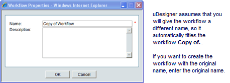

To create a new workflow from a snapshot:
- Open the business process into which you want to insert a new workflow.
- In the left Navigator, select Workflows. In the right pane, uDesigner displays a list of the workflows that have been created for this BP.
- Highlight the name of the snapshot containing the workflow you want to insert, and select Open.
uDesigner opens the workflow's properties window.
- Enter a name and description for the new workflow, and select OK.
uDesigner inserts the new workflow and displays the name on the workflow log.
