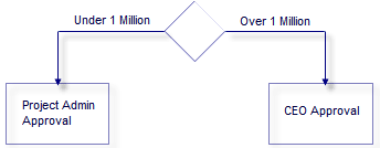

A workflow can contain a conditional step that must be resolved before the workflow can continue. Conditional steps entail separate (conditional) routing. This routing is triggered at the step by a field condition or situation you can specify in uDesigner. An example of conditional routing is a purchase order that follows one path through a workflow if the total amount is less than a certain amount, and follows another path if it is equal to or greater than that amount. (The trigger value for the field on the conditional step's form is assigned when the business process is set up in Unifier.)
This graphic displays how a condition can trigger two different steps if the amount is more or less than a set amount.
When the workflow reaches a conditional step, the business process tests the value of the field on the form to see whether it meets the trigger value.

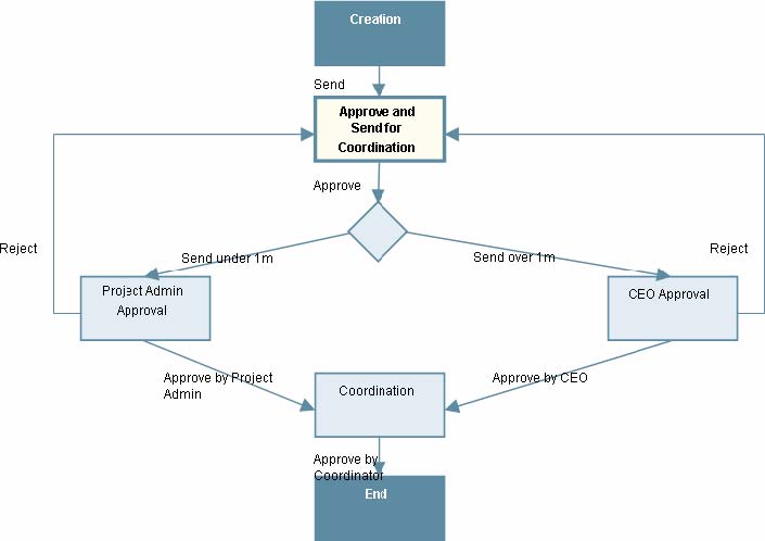

    You can include multiple conditional routings in a workflow, but only one condition per step.
    This image depicts an example conditional workflow.
