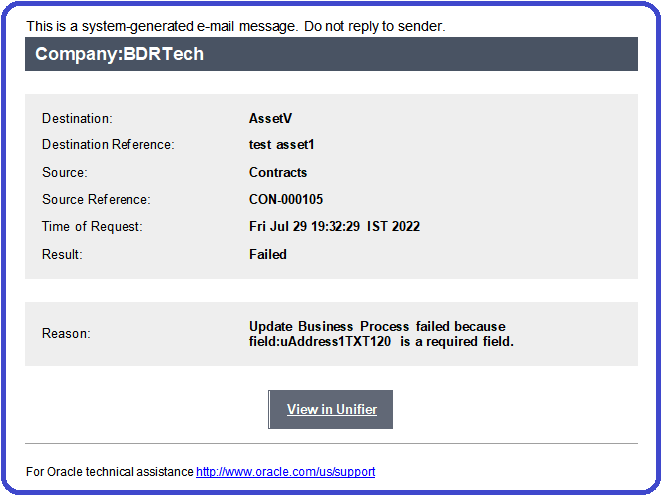

The Reverse Auto-populate (RAP) will fail if an invalid or inactive Status has been defined in the data set value during RAP configuration of a destination non-Workflow BP. (Error messages might include: RAP to "Status" has failed because an invalid value was detected in the source element. Or: The data element cannot be updated in destination BP as record status is inactive. Or: The selected record status is inactive in destination BP and cannot be updated.) The system logs these errors, which you can send to the user who has been designated to receive source BP error notifications in the "Send error notification to" section of the Business Process Setup window. The error email notification will have the following two additional fields to assist the recipient with identifying the source:
- Destination Reference
- Source Reference
You can find the reasons for the reverse auto-population (RAP) failures in the audit log of the BP record. In addition, on occasion the system generates error codes for reverse auto population failures which can be used to troubleshoot the reverse auto population failures.

The Reverse Auto-populate (RAP) email messages will notify you if the RAP fails, during runtime, and include the following details for better traceability:
Note The Reverse Auto-population (RAP) option can take place between different elements, if the option is included for those elements.
For Source Business Process and Destination Business Process:
- Destination Reference with BP Record number (Destination Reference: Where you have the field with a value that can change through RAP.)
- Source with Source BP Name (Source Reference: Where you have the field with a value that you can change, and as a result, update the Destination through RAP.)
- Source Reference with Source Record number

The following is a sample of an RAP email message that displays the changes done when a DE is reverse auto-populated.
