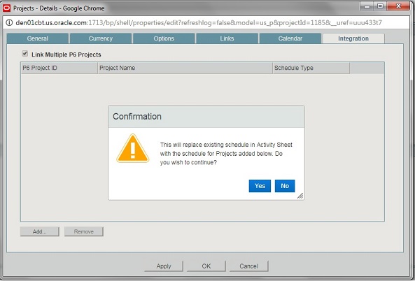

- The Summary Sheet Integration does not work if you link to multiple projects in the Gateway Integration tab of a shell.
- All existing Activities data and corresponding Audit Log data is deleted when you link to multiple projects in the Gateway Integration tab of a shell.
- When the P6 project ID is added in General tab of the shell Details window (which is already added in another shell Integration tab), priority is given to the shell in which the P6 project ID added in Gateway Integration tab on running Get Data from any of the shells.
