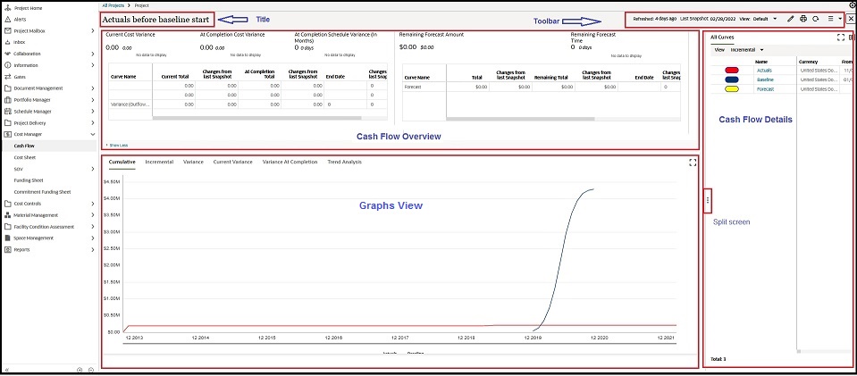

The project/shell cash flow worksheet is divided into the following sections, as shown in the following typical screen capture:
The cash flow worksheet window is divided into the following parts, as highlighted in the following screen capture, and each part can be individually maximized.
This image displays the various parts of the cash flow work sheet, including the title, toolbar, cash flow overview, graphs view, and cash flow details.
The following explains each part in detail.
