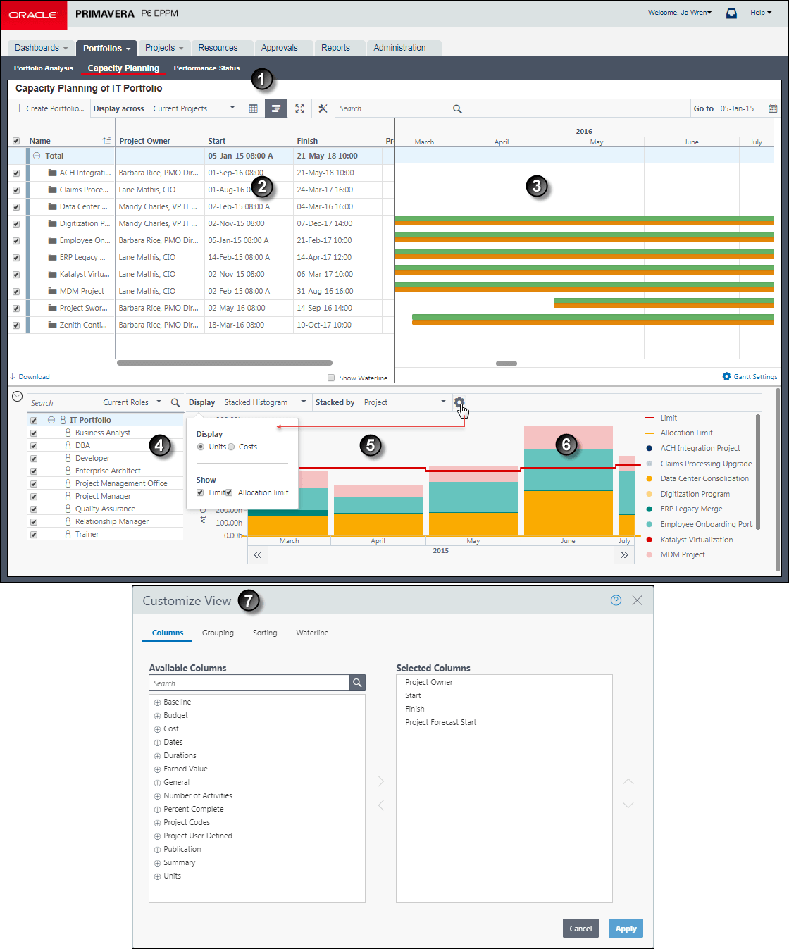

This illustration is a graphical representation of the text in the following table.
Table of Key Capacity Planning Page Elements
Item
Description
item one
Navigation: Before you begin, first open the portfolio you want to work with, then select Capacity Planning.
item  two
Scorecard: Use this table to analyze, sort, and select projects. Only the projects you select in the option column appear in the Capacity Planning chart.
Note The scorecard on this page is not related to the set of defined portfolio view scorecards.
item  three
Gantt chart: View current and forecast schedules. Drag the bars to adjust the Capacity Planning chart data.
item  four
Role Selection Area: Select the options for the roles you want to include in the Capacity Planning chart.
item five
Capacity Planning Chart (Under Allocated): View role allocation as a stacked histogram, area chart, net availability chart, or spreadsheet.
item six
Capacity Planning Chart (Over Allocated): Customize the chart to show a limit line representing the maximum capacity of the currently selected roles by timescale period.
item seven
Customize Capacity Planning Chart: Customize the columns, grouping, waterline, or chart options.
Note The net availability charts are often the best place to begin a resource capacity or demand analysis since they represent a streamlined birds-eye view. These charts include all related projects and roles in a single view allowing you to expand or drill down into only the roles with perceived problems.
