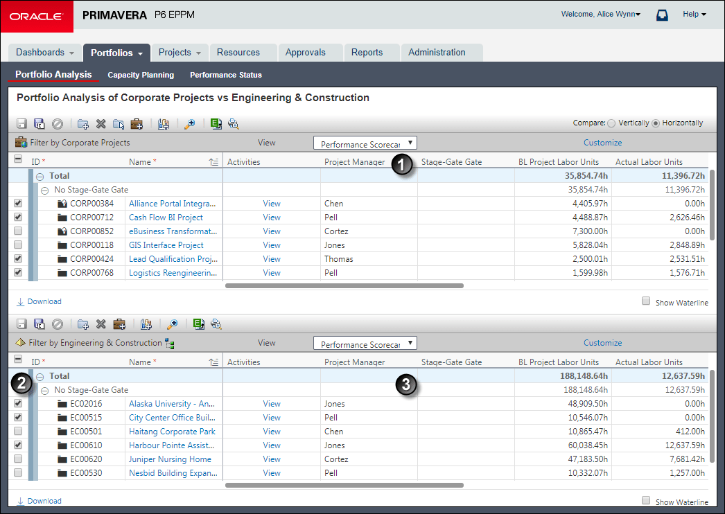

This illustration is a graphical representation of the text in the following table.
Table of Key Scorecard Elements
Item
Description
item one
Scorecard work area: The first scorecard will appear in this upper work area.
item  two
Project Selection options: Select an option to add a project's data to the cumulative Total line.
item  three
Scorecard work area: The second scorecard will appear in this lower work area. In this example, the user has customized the view with a waterline. Use a waterline to analyze a project group by sorting projects into two separate groups based on a defined sorting and constraint limit. Projects above the waterline, displayed with a white background, are those that fall outside the constraint limit value; all other projects, displayed with a light blue background, appear below the waterline.
Note To support comparative analysis, the Portfolio Analysis work area is divided into two parts. The elements above generally appear within both parts.

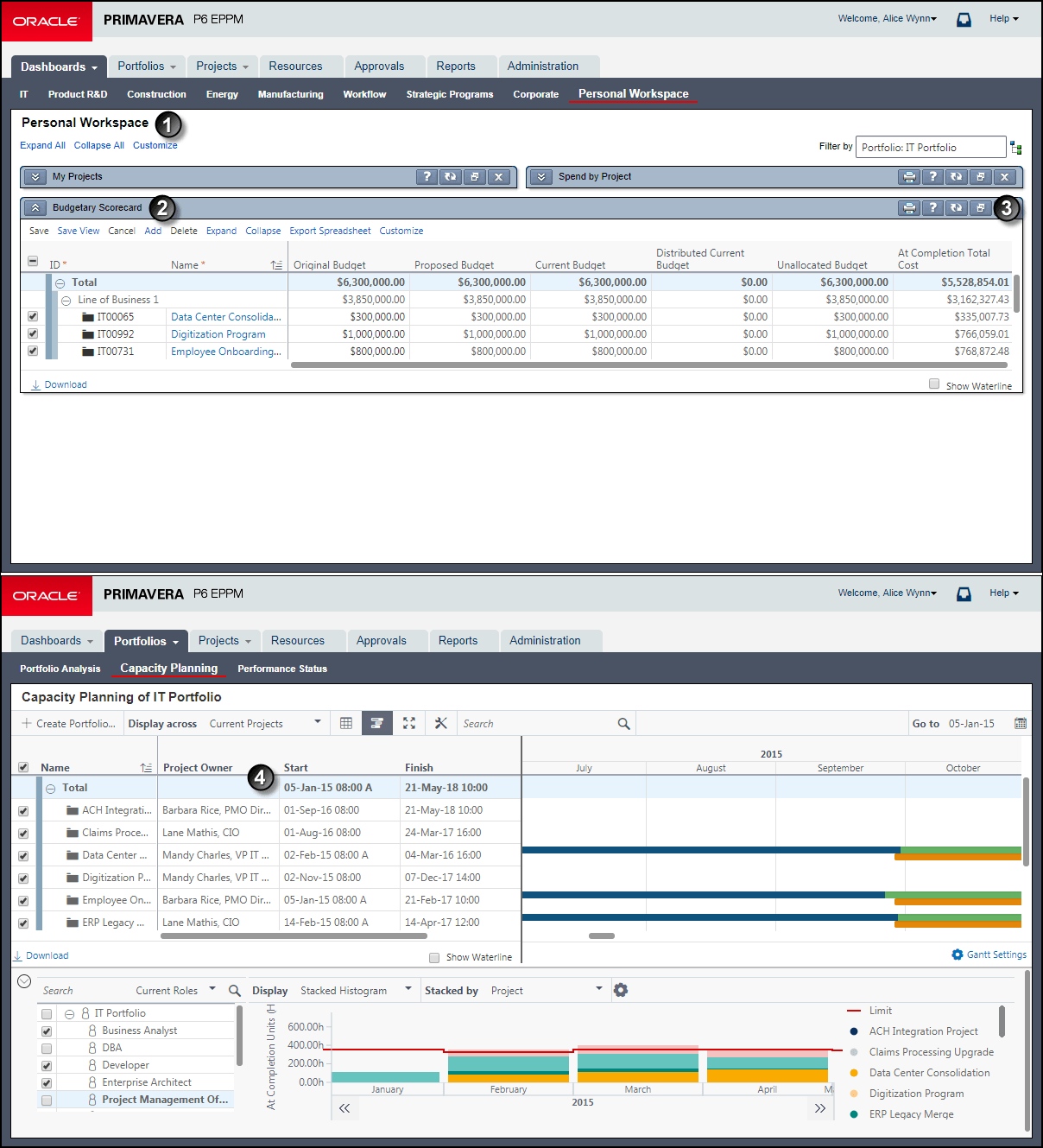

Table of Related Scorecards
Item
Description
item one
Dashboard: The Personal Workspace dashboard. You can show portfolio views on private, multi-user, or global dashboards.
item  two
Scorecard in a portlet: The Budgetary Scorecard displays in a portlet on a dashboard. This example demonstrates a named portfolio view scorecard.
item  three
 Click here to maximize or minimize this sectionicon: Click to maximize and expand the scorecard. Additional command links will appear at the top of this portlet when it is maximized.
item  four
Scorecard on the Capacity Planning page: This example demonstrates a general table format also referred to as a scorecard; however, this is not a named portfolio view scorecard.
