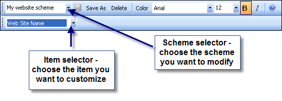

  3. Click the Splash Tab.
  4. Click a splash screen element to select it, or choose an element from the item selector (see image below), then customize it in the fields at the top of the dialog box.
  5. Click the Main tab.
  6. Click a screen element to select it, or choose an element from the item selector (see image below), then customize it in the fields at the top of the dialog box.
  7. Click Save As to save the modified scheme.
    Use the existing scheme name to replace the old scheme with the modified one, or give the scheme a new name to save it as a separate project Web site scheme.
