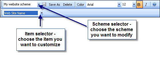

  3. Click the Splash Tab.
  4. Click a splash screen element to select it, or choose an element from the item selector (see image below), then customize it in the fields at the top of the dialog box.
  5. Click the Main tab.
  6. Click a screen element to select it, or choose an element from the item selector (see image below), then customize it in the fields at the top of the dialog box.
