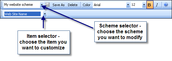

- Click a splash screen element to select it, or choose an element from the item selector (see image below), then customize it in the fields at the top of the dialog box.
- Click the Main tab.
- Click a screen element to select it, or choose an element from the item selector (see image below), then customize it in the fields at the top of the dialog box.
