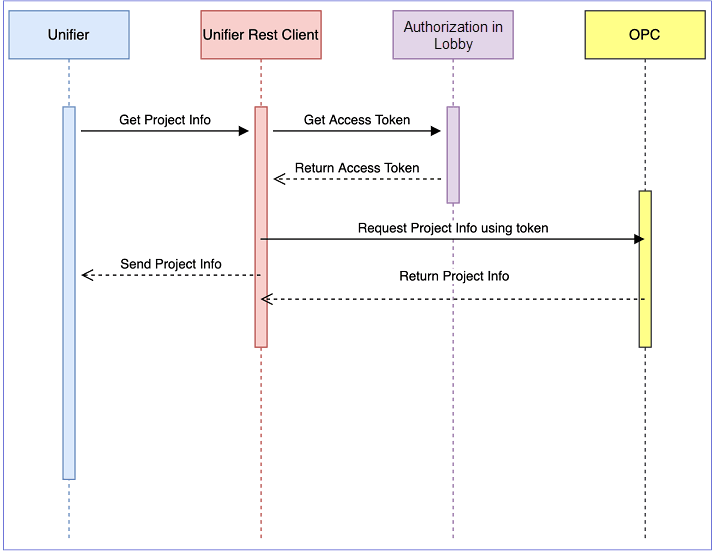

Data can be shared between Unifier and Oracle Primavera Cloud. Unifier can access the Oracle Primavera Cloud Application Programming Interface (API) through an access token generated from the Lobby.
To generate the required access token, your System Administrator (on-premises installations) or Company Administrator (cloud service) must enter the URL for the Lobby in the custom.properties file (Advanced tab of Unifier Configurator Settings). The file must contain the following entry:
skire.lobby.lobbyuri = <lobby URL for your environment>
If the server name and the host and scope name are different, the Oracle Primavera Cloud connection will not be established. As explained in the Connect for Primavera Cloud Integration topic, Unifier uses the Lobby identity application token request by sending the URL, username, and password values to get the access token and refresh token.
The following diagram shows the integration elements:
