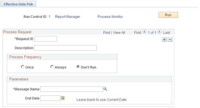

Use the Effective Date Pub page (EO_EFFDATAPUB) to run the Effective Date Publish utility.
Navigation:
This example illustrates the fields and controls on the Effective Date Pub page. You can find definitions for the fields and controls later on this page.
Field or Control |
Description |
Message Name |
Select the current incremental message to publish. |
End Date |
Select the latest effective date to process from the delay table. |
Run |
Click to run this request. The Application Engine program uses the trigger records in the delay table and the end date parameter from the run control component to publish a current effective incremental message that contains all future-dated rows that are effective. This ensures that third-party systems that cannot manage future-dated records always receive currently active data on that data's effective date, even if that information was previously updated on the PeopleSoft system. |
