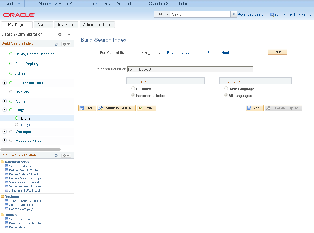

Use the Build Search Index page (PTSF_SCHEDULE_SI) to build search indexes for the deployed search definitions.
Navigation:
On the Build Search Index pagelet, for example, click the Blogs link.
This example illustrates the Build Search Index page.
To build a PeopleSoft Interaction Hub search index:
Select .
On the Build Search Index pagelet, click a search category for which you want to build an index. As an example, click the Blogs link.
The Build Search Index page appears in the target content area. The Run Control ID and the Search Definition fields are populated with values associated with the selected search category.
