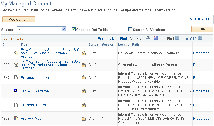

Access the My Managed Content – Checked Out page (select click the Check out link).
This example illustrates the fields and controls on the My Managed Content - Checked Out page showing content items that are filtered by the Status and Checked Out To Me fields. You can find definitions for the fields and controls later on this page.
When clicking a Content Item Status link on the My Managed Content Status page, you are redirected to the My Managed Content page with the filters set according to the status selected. These filters can be adjusted directly on the My Managed Content page. The content is automatically filtered to only return content rows where the user is the creator, updater, or approver of the last version.
Selecting the Search All Versions option filter will check all versions; however, data retrieval will take longer with this filter selected. The preceding example shows the My Managed Content page when the Checked Out content item status is selected.
Note: The newly added content item How to Retrieve Secure Content is listed as checked out and locked. You can also see that it is a Microsoft Word document, its latest version is 1, and it is located in two folders.

To check in a content item:
Access the My Managed Content page for a list of all content currently checked out to you.
Select
Click the Properties link to access the Content Attachment Properties page.
Click the Check In button to unlock the content item and make it accessible to authorized folder members for review or edit.
Members can access the content using a variety of methods, including their own in-box or using browse.
Note: The Check In and the Cancel Check Out buttons disappear. The Check Out and the Submit For Approval buttons appear.
Return to the My Managed Content page.
The content item is no longer listed. You will need to change the filtering criteria to see it.

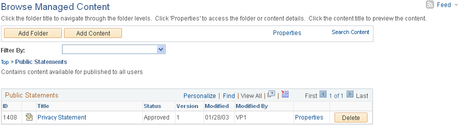

Use the Browse Managed Content page (EPPCM_HIERTOP_MAIN) to edit and view all content that was checked out by you.
Navigation:
Click a title link.
This example illustrates the fields and controls on the Browse Managed Content page, Public Statements folder.

If you navigate to the folder containing the required content, a lock is no longer associated with the file because the content is now checked in. Instead, a star icon indicates the content item was recently added.
Note: The My Managed Content page takes you directly to the content. To find your content using the browse option, you need to know where the content is located.
To check out content items:
Click the Properties link on the Browse Managed Content page.
Click the Check Out button on the Content Properties page.
The content item opens in its original format ready for you to review, edit, or save. For example, the How to Retrieve Secure Content item opens in Microsoft Word.
Save the content to a location on your computer.
The Content Properties page reappears. Notice the changes to the Version, Version Status, Created, and Modified fields. Checking out a piece of content creates a new version with a status of draft.
Return to the Browse Managed Content page.
Notice the icon indicating that this content is checked out and locked, and the version number has changed.

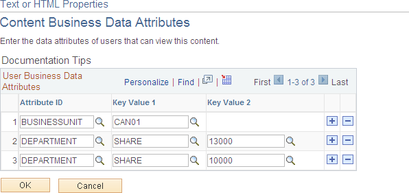

Use the Content Business Data Attributes page (EPPCM_CONT_ATT) to assign business attribute controls to a piece of managed content.
Navigation:
Click the Business Data Attributes link on the Content Properties page.
This example illustrates the fields and controls on the Content Business Data Attributes page. You can find definitions for the fields and controls later on this page.
Insert one or more rows and select the attribute(s) and key(s) to assign to this content. Only users whose attributes match the values specified will have access to this content.
You can assign multiple business attributes. Values using the same attribute are grouped using the OR operator. Values from different attributes are grouped using the AND operator. For example:
Suppose Company is defined as an attribute that is used to manage access to content. If both Company A and Company B are assigned to a piece of content, then users from either Company A or Company B can access that content.
Suppose both Business Unit and Department are defined as attributes to manage content access to content. If business unit US001 and department 1000 are assigned to a piece of content, then only users assigned to business unit US001 and department 1000 can access that content.

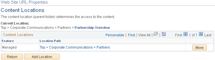

Use the Content Locations page (EPPCM_CONT_LOC) to view information about the folders in which the content is published.
From this page, you can move content to a new folder on the Move Content page. In addition, from this page, you can specify additional folders in which the content is available on the Add Content Locations page. Specifying an additional location does not create another copy of the content; instead, it creates a link so that only one instance of the content is present within managed content.
Navigation:
Click a folder title link and click a subfolder title link.
Click an appropriate Properties link and click the Locations link on the Content Properties page.
This example illustrates the fields and controls on the Content Locations page. You can find definitions for the fields and controls later on this page.
Note: The Content Locations page in the Managed Content feature lists all the folders where the content is located, including the locations of other publishing features that imported the managed content. When the Content Locations page is accessed from a nonmanaged feature, such as Workspaces or Categorized Content, it will only show the content locations for that feature. You can only move content between folders of the current feature in the current site.
When moving content or adding new content locations, be aware that the location (parent folder) determines the access security for the content.
See Top Folder Properties - Move Folder Page.
Field or Control |
Description |
Move |
Click to change the current location of the content. |
Add Location |
Click to add an additional location for the content. |

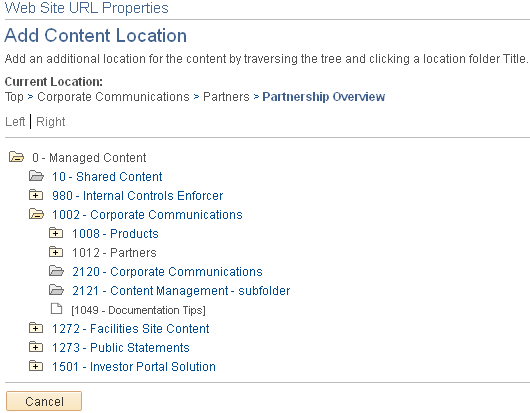

Use the Add Content Locations page (EPPCM_CONT_TREEADD) to select an additional location for the content.
Navigation:
Click the Add Location button on the Content Locations page.
This example illustrates the fields and controls on the Add Content Location page.
To select an additional location for the content:
Click the folder icons to navigate through the hierarchies.
Select the new location by clicking the folder title.
The Content Locations page appears with the new location listed.
Click the Return button to return to the Content Properties page.
Click the Save button.
The document is now listed in two folders.

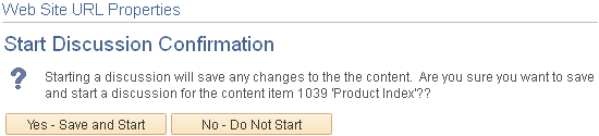

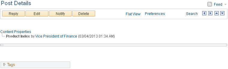

The Start Discussions link on the Content Properties page enables users to start a discussion, which is then attached to the content item. After a discussion has been started, the link changes to View Discussions and is used to edit, respond to, and view discussions.
Note: These discussions stay with the content item, and they can only be accessed from the Content Properties page.
Start Discussion Confirmation Page
Use the Start Discussion Confirmation page (EO_PE_YESNOCONFIRM) to use to confirm the start of a discussion on this piece of content.
Navigation:
Click a folder title link and click an appropriate Properties link.
Click the Start Discussion link on the Content Properties page.
This example illustrates the fields and controls on the Start Discussion Confirmation page.
Use the Start Discussion Confirmation page to confirm the start of a discussion on this piece of content.
Post Details Page
Use the Post Details page (EPPDF_VIEW_TOPIC) to start a new discussion or edit an existing discussion for this content item.
Navigation:
Click a folder title link and click a content title link.
Click Yes-Start Discussion on the Start Discussion Confirmation page.
This example illustrates the fields and controls on the Post Details page.
Use the Post Details page to start a new discussion, edit an existing discussion, or view an existing discussion about a content item.

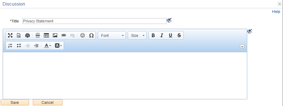

Discussion Page
Use the Discussion page (EPPDF_REPLY_TOPIC) to enter or edit a discussion topic.
Navigation:
Click the Yes-Save and Start button and click the Edit button.
This example illustrates the fields and controls on the Discussion page.
Use the Discussion page to edit a discussion topic. A discussion for a content item contains only one topic, but it can contain one or more replies.

Use the My Managed Content Status page (EPPCM_STAT_MAIN) to view, at a glance, the work that you need to perform based on the status of managed content.
Navigation:
Content Management, Managed Content, My Content Status
This example illustrates the fields and controls on the My Managed Content Status page. You can find definitions for the fields and controls later on this page.
The My Managed Content Status page and the My Managed Content page enable you to see, at a glance, the work that you need to perform based on the status of managed content.
