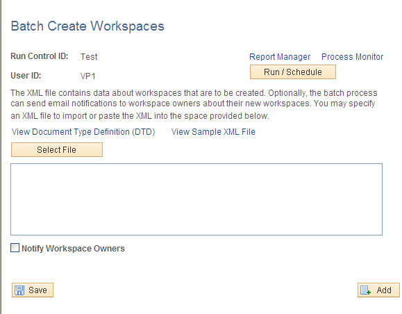

Batch Create Workspaces Page
Access the Batch Create Workspaces page (Portal Administration, Workspaces, Batch Create Workspaces, Batch Create Workspaces).
This example illustrates the fields and controls on the Batch Create Workspaces page. You can find definitions for the fields and controls later on this page.
Use the Batch Create Workspaces page to specify XML and other parameters for the workspace batch process (EPPCW_IMPORT). The EPPCW_IMPORT Application Engine program returns a standard processing log for the job and an XML file of any workspaces that had errors and were not created by the process, for example, workspaces that had blank values for required elements. You can correct the XML blocks and resubmit them for processing.
Field or Control |
Description |
Report Manager |
Click to access the Report Manager module to view report results. See the product documentation for PeopleTools: Process Scheduler,“Using Report Manager.” |
Process Monitor |
Click to access the Process Monitor to view the status of job requests. See the product documentation for PeopleTools: Process Scheduler, “Using Process Monitor.” |
Run / Schedule |
Click to schedule and run this process. Process Scheduler runs the EPPCW_IMPORT process at the user-defined time. See the product documentation for PeopleTools: Process Scheduler“Submitting and Scheduling Process Requests.” |
View Document Type Definition (DTD) |
Click to review the DTD that provides the XML specifications for the workspace batch process. |
View Sample XML File |
View example XML that demonstrates how to create and update workspaces. Copy and modify this XML to be the input to the workspace batch process. Save the XML as a file, or paste the modified XML directly into the text box. |
Select File |
Click to browse to a local file that you want to use to create or modify workspaces in batch mode. |
Upload |
Insert the XML that defines the workspaces to be created or updated. |
Notify Workspace Owners |
Select this check box to send an email to the owner of each workspace indicating that the workspace was created or modified. |
The output file is named EPPCW_BATCH_ERROR.xml and is written to the application server. Use the Process Monitor to access the log file.
