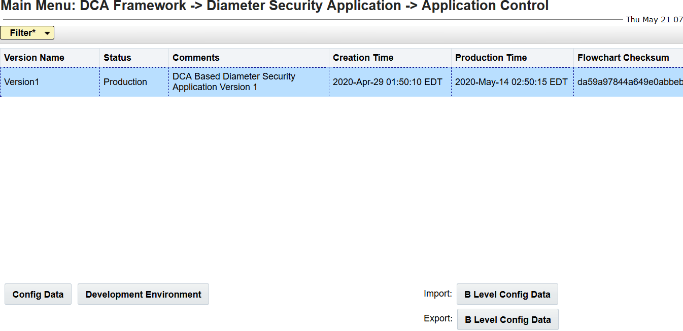

- From the Main Menu, navigate to DCA Framework, and Diameter Security Application, and then Application Control. Ensure that an entry is added in DCA application version details table.
- Select the required DSA Version Name.
- Click B Level Config Data in the
Export section of the Application Control
page.
Figure 5-1 DSA SOAM Level Configuration Export
- The application should be deactivated, see Deactivating DSA, then need to be activated, see Activating DSA, and then import NOAM json file of the upgraded release, see Configuring DSA Business Logic and Database Schema.
- Following are the steps to import the SOAM level json:
- Log in to the active SOAM GUI.
- From the SOAM GUI Main Menu, navigate to DCA Framework, and Diameter Security Application, and then Application Control.
- Click B Level Config Data, select the "file", and then click Import to import the SOAM configuration data.
