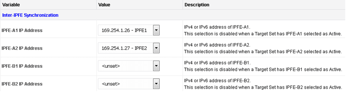

- In SOAM VIP, configuration of replication IPFE association data.
- Navigate to IPFE, and then Configuration, and then Options.
- Type the IP address of the 1st IPFE in the IPFE-A1 IP Address field and the IP address of the 2nd IPFE in the IPFE-A2 IP Address field.
- If applicable, type the address of the 3rd and 4th IPFE servers in
IPFE-B1 IP Address and IPFE-B2 IP Address
fields.
- It is recommended that the address resides on the IMI (Internal Management Interface) network.
- IPFE-A1 and IPFE-A2 must have connectivity between each other using these addresses. The same applies to IPFE-B1 and IPFE-B2.
