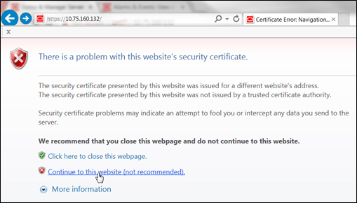

- If a Certificate Error is received, click on Continue to this
website (not recommended) link.
Figure 5-1 Certificate Error

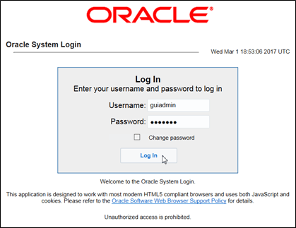

The login screen appears.
- Log in to the GUI using a user account with administrator
privileges.

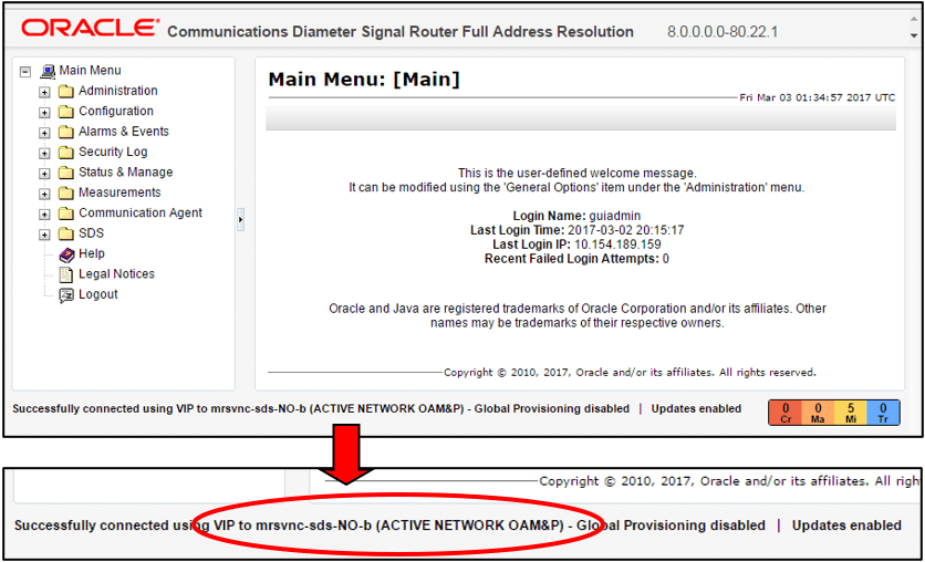

The Product Main Menu appears.
- Verify that the message shown across the bottom of the panel indicates that
the browser is using the VIP to connect to the
ACTIVE NETWORK OAM&P.

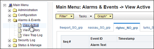

- Go to . Then, select View Active.
Figure 5-3 View Active

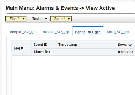

The current list of Active Alarms appears.
Figure 5-4 Active Alarms

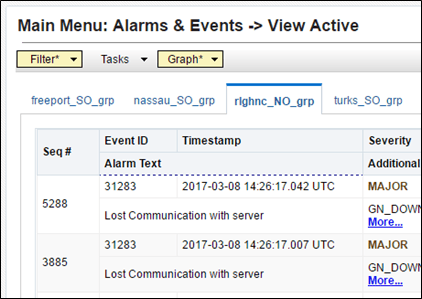

Alarms visible at this time may include but are not limited to Event ID(s): 31106, 31107, 31114, 31233 & 31283. - Monitor the current list of Active alarms until all alarms
associated with the Failover have cleared.
The user should allow at least 15 minutes for resulting alarms to clear before attempting any troubleshooting activities.
- Contact My Oracle Support (MOS) for assistance with any reoccurring alarms or alarms which fail to clear within a 15 minute timeframe.
- Refer to My Oracle Support (MOS), for more information on contacting Oracle Customer Service.
