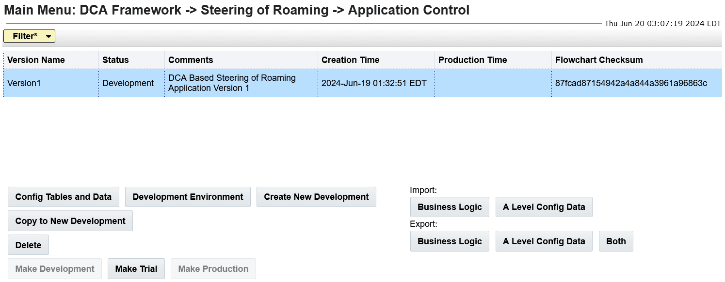

    2. From the Main Menu, navigate to DCA Framework, Steering of Roaming, and then Application Control. Ensure that an entry is added in DCA application version details table.
    3. Select the required Steering of Roaming version name.
    4. Click A Level Config Data in the Export section of the Application Control page.
      Figure 2-1 Application Control Page

    2. From the NOAM GUI Main Menu, navigate to DCA Framework, Steering of Roaming, and then Application Control.
    3. Click A Level Config Data in the Import section of the Application Control page, select the file, and then click Import to import the NOAM configuration data.
