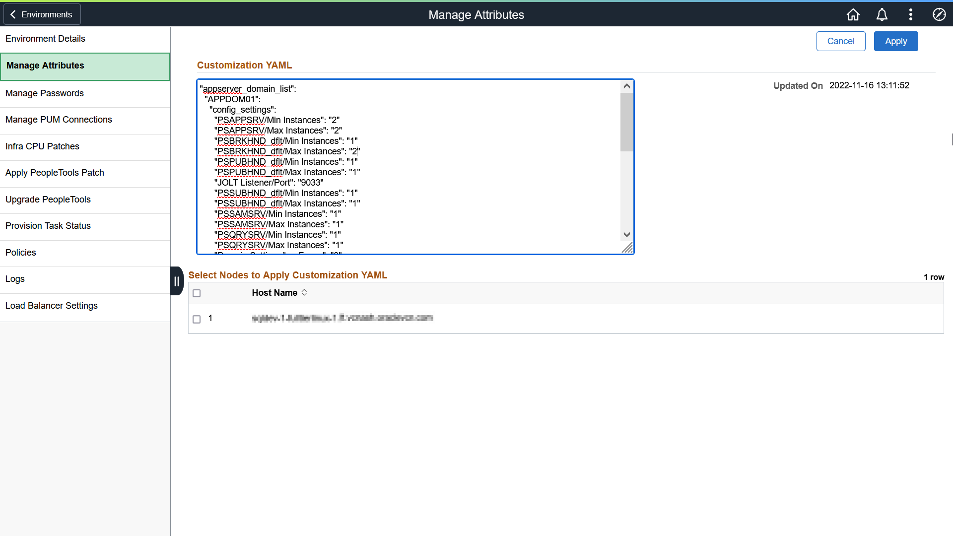

To modify the customization YAML:
  1. Click the Edit button. The Customization YAML section is enabled.
    This example illustrates the fields and controls on the Manage Attributes page that appear on clicking the Edit button.
    Customizing YAML file
  2. Modify the attributes in the application server domain, Process Scheduler domain or web server domain.
    Domain
    Attribute
    Configuration File Location
    Description
    App Server Domain
    PSAPPSRV/Min Instances
    $PS_CFG_HOME/appserv/<domain_name>/psappsrv.cfg
    Instances for processing functional requests, such as building and loading components.
    PSAPPSRV/Max Instances
    PSBRKHND_dflt/Min Instances
    Instances for processing the requests from dispatcher for Integration broker queues.
    PSBRKHND_dflt/Max Instances
    PSPUBHND_dflt/Min Instances
    Handler instances responsible for publications out bound messages from Integration Broker environment.
    PSPUBHND_dflt/Max Instances
    JOLT Listener/Port
    Port number used by JOLT server handlers.
    PSSUBHND_dflt/Min Instances
    Handler instances responsible for subscriptions in bound messages from external system.
    PSSUBHND_dflt/Max Instances
    PSSAMSRV/Min Instances
    SQL application manager process handles the conversational SQL that is mainly associated with Application Designer.
    PSSAMSRV/Max Instances
    PSQRYSRV/Min Instances
    Handles any query run by PeopleSoft Query. This is an optional process designed to improve performance by reducing the workload of PSAPPSRV.
    PSQRYSRV/Max Instances
    Domain Settings/LogFence
    Logging detail level
    Process Scheduler Domain
    PSAESRV/Max Instances
    $PS_CFG_HOME/appserv/prcs/<domain_name>/psprcs.cfg
    Application Engine server process is a process that handles both Application Engine and Optimization Engine requests.
    PSDSTSRV/Min Instances
    The distribution agent server process posts the reports and system log files to the report repository.
    PSDSTSRV/Max Instances
    Web server Domain
    auth_token_domain
    Not editable
    Domain in which the portal runs. The single sign on token is valid across this domain.
    max_threads
    $PS_CFG_HOME/webserv/<domain_name>/config/config.xml
    Maximum number of threads WebLogic can create in the default Execute queue.
    java_heap_min
    $PS_CFG_HOME/webserv/<domain_name>/bin/setEnv.sh
    Web server JVM heap size
    java_heap_max
    appserver_connections
    $PS_CFG_HOME/webserv/<domain_name>/applications/peoplesoft/PORTAL.war/WEB-INF/psftdocs/<site_name>/configuration.properties
    List of host and port details of the JSH process in App server. Web server forwards requests to these URLs.
  3. Select the hosts where the customization must be applied on the Select Nodes to Apply Customization YAML section.

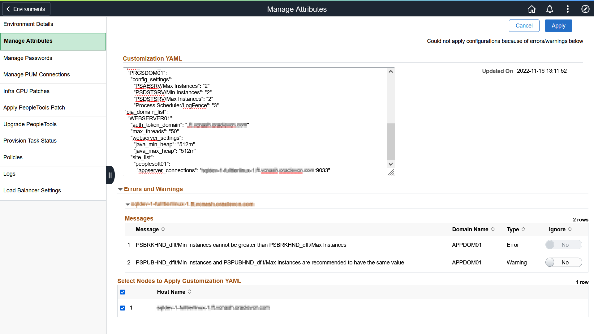

  4. Click Apply. The system displays errors and warnings related to the update, if any. You can choose to ignore warnings, but the errors must be resolved.
    This example illustrates the errors and warnings on the Manage Attributes page that appear on clicking the Apply button.
    Errors and Warnings on applying customization YAML

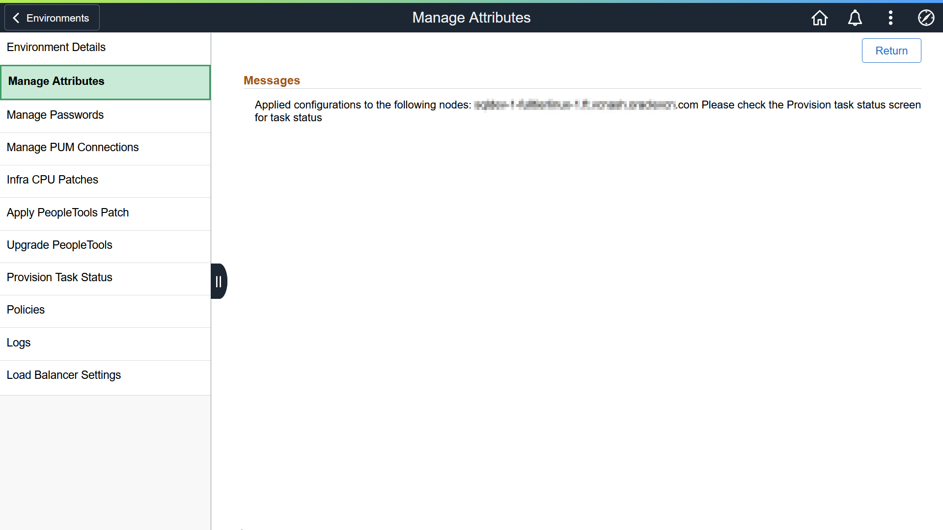

  5. Click Apply after resolving the errors. The system displays a confirmation message.
    This example illustrates the confirmation message on the Manage Attributes page that appears after all the errors are successfully resolved and warnings are resolved or ignored.
    Confirmation message
  6. Check the Provision Task Status page for the status of application of custom configurations, where the status of deployment task activities is displayed along with their start and end times. See Viewing Provision Task Status.
    You cannot modify the configuration of an instance until the tasks in progress for applying the configuration are completed.

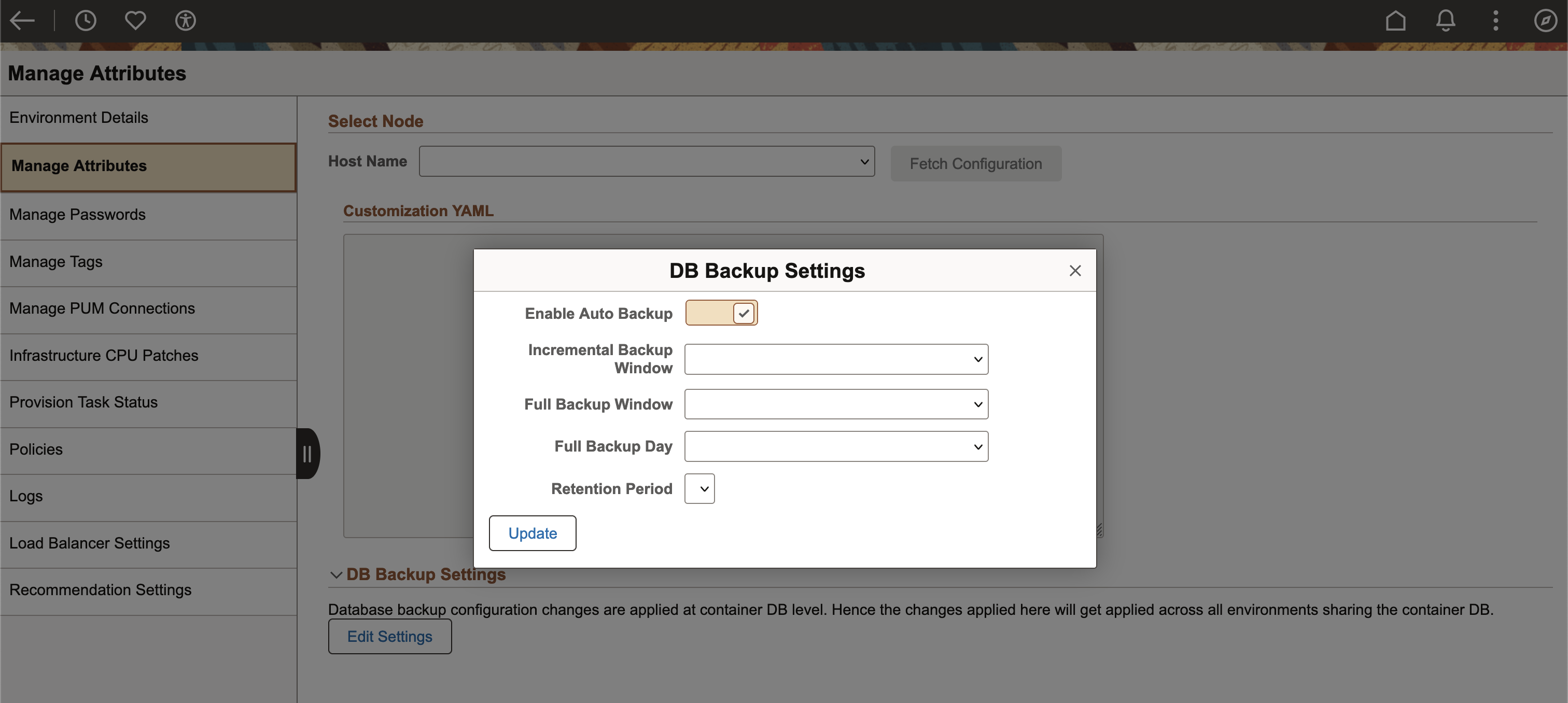

You can use this section to configure DB backup settings for DBS-based environments and imported environments.
Cloud Manager supports backup and restore of DBS-based environments that have single or multiple Pluggable Databases (PDB) in a Container Database (CDB). The prerequisite for this is that auto-backup must be enabled for the CDB containing the environment's PDB.
To update database backup settings:
  1. Expand the DB Backup Settings section and click Edit Settings.
  2. Select the appropriate settings on DB Backup Settings window.
    This example illustrates the fields and controls associated with DB Backup Settings on the Manage Attributes page. This section is enabled only for DBS-based environments. You can find definitions for the fields and controls later on this page.
    DB Backup Settings
    Field or Control
    Description
    Enable Auto Backup
    Select to enable automatic backup. This must be selected to enable the backup of DBS-based environments that have multiple PDBs in a CDB.
    Incremental Backup Window
    Select the time window for performing incremental backup.
    Full Backup Window
    Select the time window for performing full backup.
    Full Backup Day
    Select the day for performing full backup.
    Retention Period
    Select the period for which the backup of an environment is retained.
    Important! The extent of restore is controlled by the retention period of automatic backup configuration.
  3. Click Update. The settings are updated.
It may take up to 24 hours for newly deployed or refreshed PDBs to be fully available in OCI. Therefore, you must wait for up to 24 hours for the PDB to synchronize before attempting Restore action. Similarly, due to a limitation in OCI you can restore just one PDB at a time and parallel restoration of environments that share the same CDB is not possible.
Note: When you enable automatic database backup from OCI console, it is recommended to select the 'Take the first backup immediately' checkbox. If you do not want to run the first automatic backup right away, you can wait for the first automatic incremental database backup to finish before starting the Backup & Restore operations on the environment from Cloud Manager.
After a PDB is recovered to a point in time, you cannot recover the same PDB to any backup point between that point and the time in which the recovery action was initiated.
