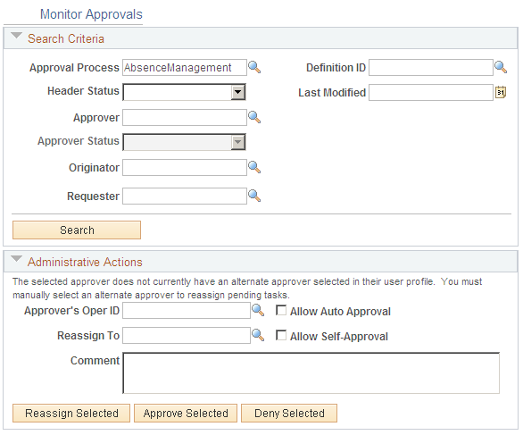

Use the Monitor Approvals page (EOAW_ADM_MON_SRC) to use the Monitor Approvals page as a system administrator to search approval processes and perform mass reassignments.
Navigation:
This example illustrates the fields and controls on the Monitor Approvals-Search Criteria page. You can find definitions for the fields and controls later on this page.
| Field or Control | Description |
| Approval Process | Select an approval process. The list of approval processes available is determined by the administrator role associated with the approval process definition. If a user is associated with the role specified in the Admin Role field on the Setup Process Definitions page, they can view or act on that process ID within the Approval Monitor. |
| Definition ID | Select the process definition that is determined on the Setup Process Definition page. |
| Header Status | Select a status in this field to display the selected status. Choices are:
| Approver | Select an approver. In order to view or take action on an approval processes for a specific approver this field is required. |
| Approver Status | Select a status from those available. This field is only available when a specific approver is selected in the Approver field. The statuses available for selection are based on the statuses of that specific approver in the cross-reference table associated with the approval process ID. |
| Originator | Select the user who entered the transaction that started the approval process. |
| Requester | Select the user who requested the transaction that started the approval process. The originator is not always the requester. |
Reassign Pending Tasks
Use this section to reassign approvals to another user. This section is only available if the process allows reassignment.

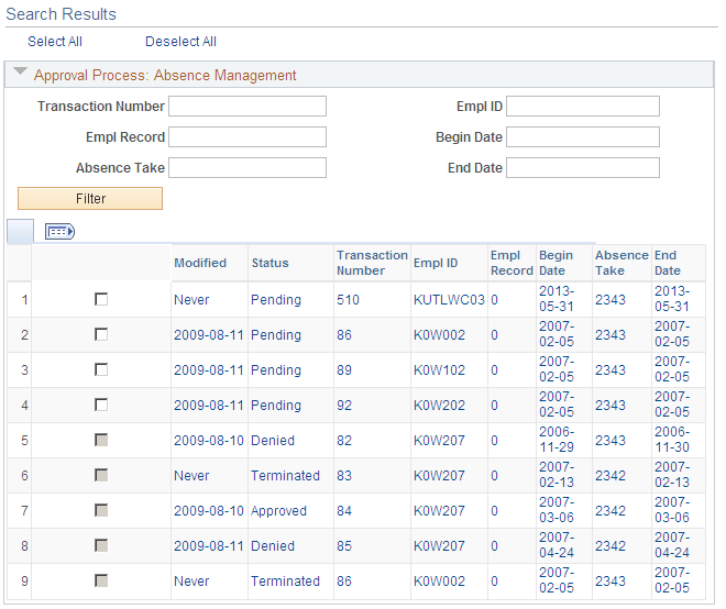

After entering the selection criteria on the Monitor Approvals page, click the Search button.
This example illustrates the fields and controls on the Approval Monitor Search results. You can find definitions for the fields and controls later on this page.
For the approval process selected, specific fields will be displayed based on the transaction display level configured for the approval process.
See Approval Monitor Configuration Page.
| Filter | Use this button to filter the result set based on criteria entered. |
| Toggle Header and Line | If the approval process contains header and line approvals, you can use this button to toggle the display to view the details. |

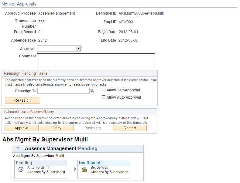

Use the Monitor Approvals page (EOAW_ADM_MON_ACT) to use this page to perform an action on a specific approval process.
Navigation:
From the Monitor Approvals Search page, select the link for the approval step you want to modify.
This example illustrates the fields and controls on the Monitor Approvals page for a specific approval process. You can find definitions for the fields and controls later on this page.
This page will reflect the options selected when you configured the approval monitor for the process. The Reassign Pending Tasks section and the buttons available in the Administrative Approve/Deny section will display as configured on the Approval Monitor Configuration page.
Warning! Due to the complex rules used by PeopleSoft Expenses, the Monitor Approvals page should not be used to approve or deny expense transactions. To approve and deny expense transactions use the PeopleSoft Expenses approval pages.
| Approver | Select an approver. All approvers associated with pending steps within the approval process are listed. |
| Comment | Enter text to appear under the approval graphic in the Approval Comment History section. |
| Reassign To | Select an approver to whom to reassign all pending steps within the approval process. |
| Reassign | Click the button to initiate task reassignment. At the end of the procedure, all pending task of the corresponding approval process instance is assigned to the user who is specified in the Reassign To field. Reassignment history is captured as comments and viewable in the approval graphic at the bottom of this page. |
| Allow Self-Approval | Select to enable self-approval. When it is enabled, the approval is assumed and the process continues. |
| Allow Auto Approval | Select to enable auto-approval. When it is enabled, the system remembers an approver’s action for that process at the header or line level, and applies the same action automatically for any subsequent appearance in the Approval Framework routing. |
| Approve | Click the button to act on behalf of the selected approver. This action applies to all tasks pending for the approver selected within the context of the approval process. |
| Deny | Click the button to act on behalf of the selected approver. This action will apply to all tasks pending for the approver selected within the context of the approval process. |
| Pushback | Click to requeue the previous step to its approver. This button is only available at a step that is greater than one. For example, a transaction has three approvers. The first approver has approved the transaction, therefore, the transaction is pending at step two. The administrator needs additional information from the requester and, therefore, pushes the transaction back to the requester. |
| Restart | Click to restart a pending transaction to all approvers in the approval path. This button is only available when the transaction is pending. |
| Resubmit | Click to resubmit a completed transaction to all approvers in the approval path. This button is only available when the transaction is complete. The transaction can only be resubmitted in its current state and cannot be modified before resubmitting for approval. |
| View/Hide Comments | Click to expand the Comments section and view comments regarding reassignment or text that is captured in the Comment field when any of the action buttons is clicked. |
