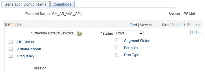

Use the Generation Control - Conditions page (GP_GCTL_CONDITION) to define the criteria for use in directing the system to include or exclude certain element conditions during batch processing.
Navigation:
This example illustrates the fields and controls on the Generation Control - Conditions page.
Field or Control  |
Description  |
HR Status (human resources status)  |
 Click this link to access the HR Status page. Indicate which employee status conditions to process.  |
Action/Reason  |
 Click this link to access the HR Action/Reason page. Indicate which Action/Reason code combinations to process.  |
Frequency  |
 Click this link to access the Generation Control - Frequency page. Indicate which frequencies to process.  |
Segment Status  |
 Click this link to access the Segment Status page. Indicate which segment status conditions to process.  |
Formula  |
 Click this link to access the Generation Control - Formula page. Indicate which formulas to process.  |
Run Type  |
 Click this link to access the Generation Control - Run Type page. Indicate which run types to process.  |
Important! When more than one generation control parameter type (such as HR status and frequency) is entered, the payee must meet both criteria to pass generation control. When more than one value (such as Actions of Hire or Rehire) for a particular generation control type is entered, the payee must meet only one of the criteria to pass generation control.

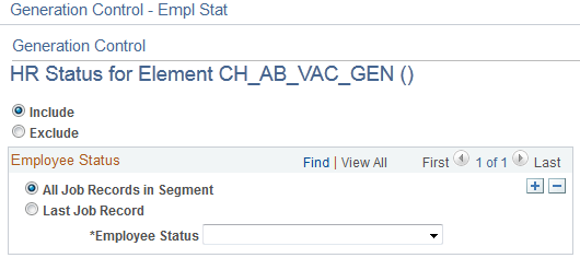

Use the HR Status for Element <name> page (GP_GCTL_ST_SEC) to exclude or include employee status conditions during batch processing.
Navigation:
Click the HR Status link on the Conditions page.
This example illustrates the fields and controls on the HR Status for Element <name> page.
Field or Control  |
Description  |
Include and Exclude  |
 Select the option to include or exclude the employee status conditions that you enter in the group box below.  |
All Job Records in Segment  |
 Select to tell the system to look at all job rows in the segment. If any row contains the value indicated in the Employee Status field, it's considered a match.  |
Last Job Record  |
 Select to tell the system to look only at the maximum effective-dated PS_JOB row for the match, within the period in question.  |
Employee Status  |
 Select a status code from the list.  |

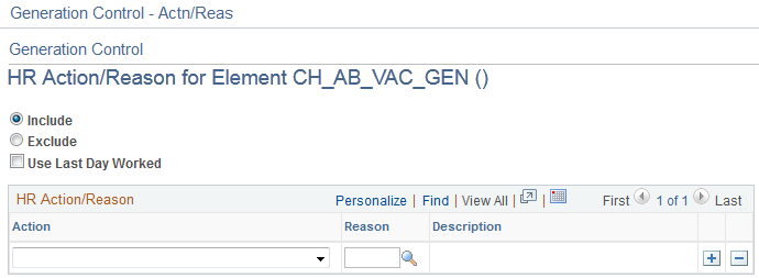

Use the HR Action/Reason for Element <name> page (GP_GCTL_AR_SEC) to exclude or include action/reason code combinations.
Navigation:
Click the Action/Reason link on the Generation Control - Conditions page.
This example illustrates the fields and controls on the HR Action/Reason for Element <name> page.
Field or Control  |
Description  |
 Select the option to include or exclude the action/reason code combinations that you insert in the group box below.  |
Use Last Day Worked  |
 Select to use the last day worked.  |
Action and Reason  |
 Select from the list of HR Action codes.  |
Note: If an action is entered with no reason, the system assumes that all reasons are valid.

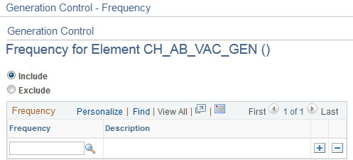

Use the Generation Control - Frequency for Element <name> page (GP_GCTL_FQ_SEC) to exclude or include frequency codes.
Navigation:
Click the Frequency link on the Generation Control - Conditions page.
This example illustrates the fields and controls on the Generation Control - Frequency for Element <name> page.
Field or Control  |
Description  |
 Select the option to include or exclude the frequency codes that you insert into the group box below.  |
Frequency  |
 Select from the list of codes.  |

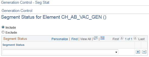

Use the Generation Control - Segment Status for Element <name> page (GP_GCTL_SS_SEC) to exclude or include segment status conditions.
Navigation:
Click the Segment Status link on the Generation Control - Conditions page.
This example illustrates the fields and controls on the Generation Control - Segment Status for Element <name> page.
Field or Control  |
Description  |
 Select the option to include or exclude the segment status conditions that you insert in the group box below.  |
Segment Status  |
 Select from the list of conditions.  |

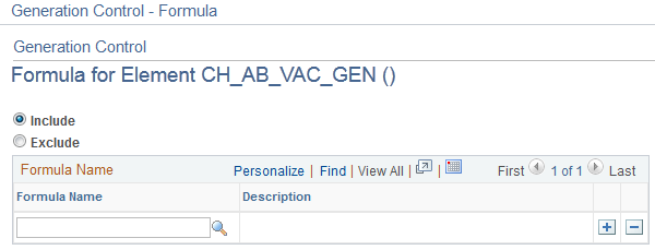

Use the Generation Control - Formula for Element <name> page (GP_GCTL_FM_SEC) to exclude or include formula elements.
Navigation:
Click the Formula link on the Generation Control - Conditions page.
This example illustrates the fields and controls on the Generation Control - Formula for Element <name> page.
Field or Control  |
Description  |
 Select the option to include or exclude the formula elements that you insert into the group box below.  |
Formula Name  |
 Select from the list of elements.  |

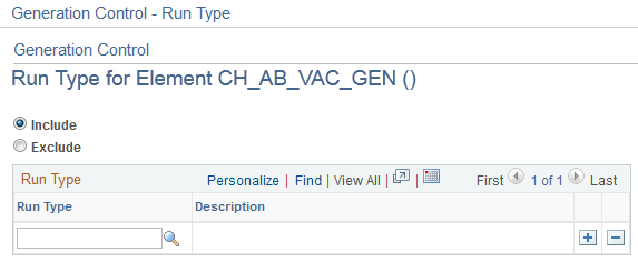

Use the Generation Control -Run Type for Element <name> page (GP_GCTL_RT_SEC) to exclude or include run types.
Navigation:
Click the Run Type link on the Conditions page.
This example illustrates the fields and controls on the Generation Control - Run Type for Element <name> page.
Field or Control  |
Description  |
 Select the option to include or exclude the run type that you insert in the group box below.  |
Run Type  |
 Select from the list of run types.  |
