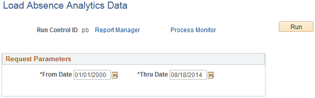

Use the Load Absence Analytics Data page (HGA_PG_RUNCNTL) to load absence analytics data for a specific date range.
Navigation:
This example illustrates the fields and controls on the Load Absence Analytics Data page.
Field or Control  |
Description  |
From Date and Thru Date  |
 Enter the date range for which you want to load absence analytics data.  |
Click Run to initiate the Load Absence Analytics Data (HGA_INIPGDAT) Application Engine process. This process uses the ABSENCE PIVOTS report data definition to load absence analytics data for all open and finalized calendar groups that fall within the specified date range.
