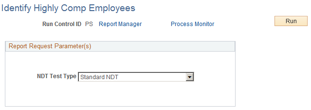

Use the Section 129 Highly Compensated page (RUNCTL_NDT001) to determine the number of highly compensated employees in your organization before you perform Section 401 or Section 129 nondiscrimination tests.
Navigation:
This example illustrates the fields and controls on the Section 129 Highly Compensated page. You can find definitions for the fields and controls later on this page.
Warning! Before determining the number of highly compensated employees, first set the nondiscrimination test parameters.
Field or Control |
Description |
NDT Test Type |
Choose from the following values: Std NDT (Standard Nondiscrimination Test, for Section 401 plans), 129 NDT (Section 129 Nondiscrimination Test), and 129 SLOB (Section 129 Separate Line of Business Nondiscrimination Test). |
