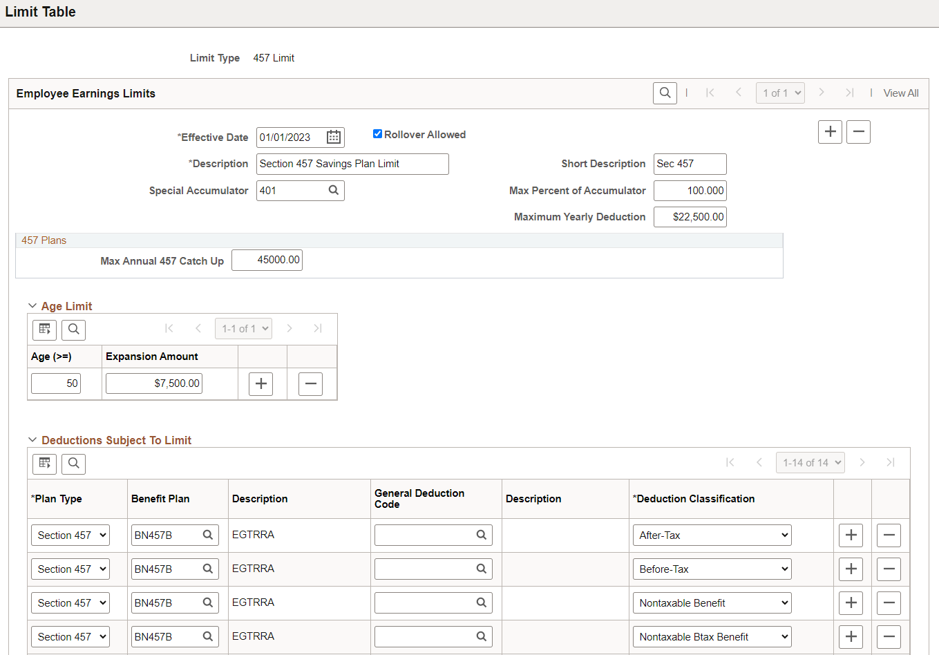

Section 457 plans are deferred compensation plans offered by state and local governments and employers that are exempt from federal income tax. The amount deferred annually by an employee cannot exceed a specific flat amount or 100% of the employee's taxable income, whichever is less.
Note: Section 457 plans are not qualified plans and are not subject to the tax code's nondiscrimination and related requirements. However, they are subject to deferral limits and mandatory distribution rules that apply to qualified plans.

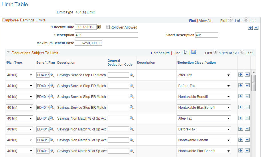

Deductions Subject To Limit |
Select the deduction codes for any and all benefit plans that fall under the specified limit. This list should be as comprehensive as possible. Both general deductions and benefit plans can be specified. To associate a limit with a deduction, enter the plan type, benefit plan, general deduction code, and deduction class. A single plan type may require more than one deduction classification. You may have to insert rows for after-tax, before-tax, nontaxable benefit, and nontaxable pretax benefit classifications for a single 401(k) plan. Note: 401(a) limit processing is supported on savings plan deductions only. A general deduction will not enforce 401(a) limits. |

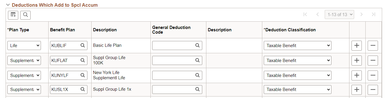

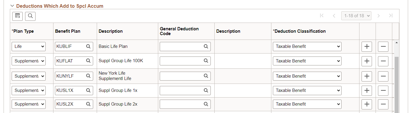

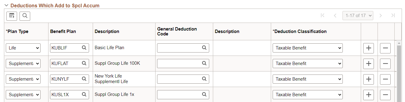

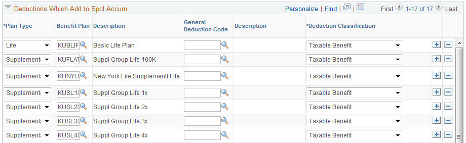

Deductions Which Add to Spcl Accum (deductions which add to the special accumulator) |
Enter deductions to add to the special accumulator. These are the taxable benefits that the IRS stipulates can be included in the calculation of the limits. The system increases the employee's eligible earnings by the total year-to-date plus the current amount of the taxable benefits that you enter here before calculating the employee's current limit. To add a deduction to a special accumulator, enter the plan type, benefit plan, general deduction code, and deduction class. |

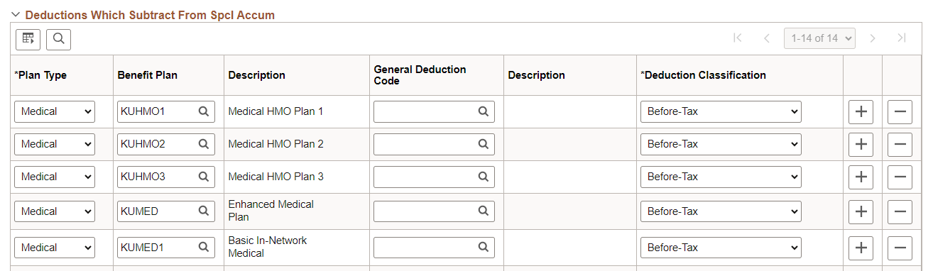

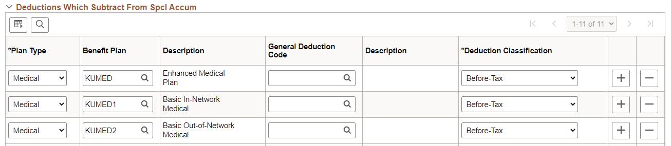

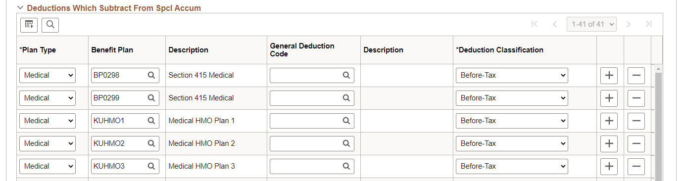

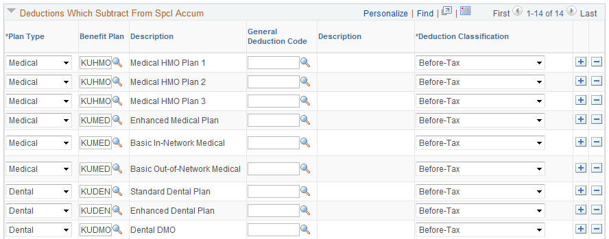

Deductions Which Subtract From Spcl Accum (deductions which subtract from the special accumulator) |
Enter the deductions that subtract from the special accumulator. These are deductions that the IRS stipulates must be excluded from the calculation of the limits. (Ordinarily, these are before-tax deductions, but you may encounter exceptions.) The system reduces the employee's eligible earnings by the total year-to-date plus current amount of the deductions that you enter here before calculating the employee's current limit. For each taxable benefit, fill in the plan type, benefit plan, deduction code, and deduction class. |
Maximum Benefit Base |
The amount that you enter in this field is determined by IRS regulations. It determines the maximum cap on the employee's annual earnings during the calculation of the employee's contribution. |

Use the Limit Table page (LIMIT_TBL1) to identify the rules that apply to the 401(a) limits.
Navigation:
Access the Limit Table page for 401(a) limits.
This example illustrates the fields and controls on the Limit Table page for 401(a) limits.

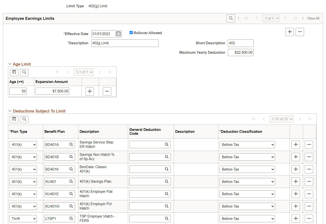

Use the Limit Table page (LIMIT_TBL1) to identify the rules that apply to the 402(g) limits.
Navigation:
Access the Limit Table page for 402(g) limits
This example illustrates the fields and controls on the Limit Table page for 402(g) limits.

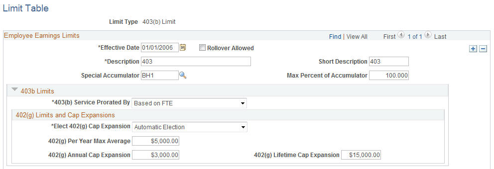

Use the Limit Table page (LIMIT_TBL1) to identify the rules that apply to the 403(b) limits.
Navigation:
Access the Limit Table page for 403(b) limits
This example illustrates the fields and controls on the Limit Table page for 403(b) limits (1 of 3).
This example illustrates the fields and controls on the Limit Table page for 403(b) limits.
Field or Control |
Description |
403(b) Service Prorated By |
Select the proration method to use for the 403(b) service year calculation in the Projection process. This information is taken from the employee's job record. |
Elect 402(g) Cap Expansion |
Select either Automatic Election, No, or Yes. |
402(g) Per Year Max Average, 402(g) Annual Cap Expansion, and 402(g) Lifetime Cap Expansions |
All of these fields are determined by IRS regulations. Enter the current approved standards. |

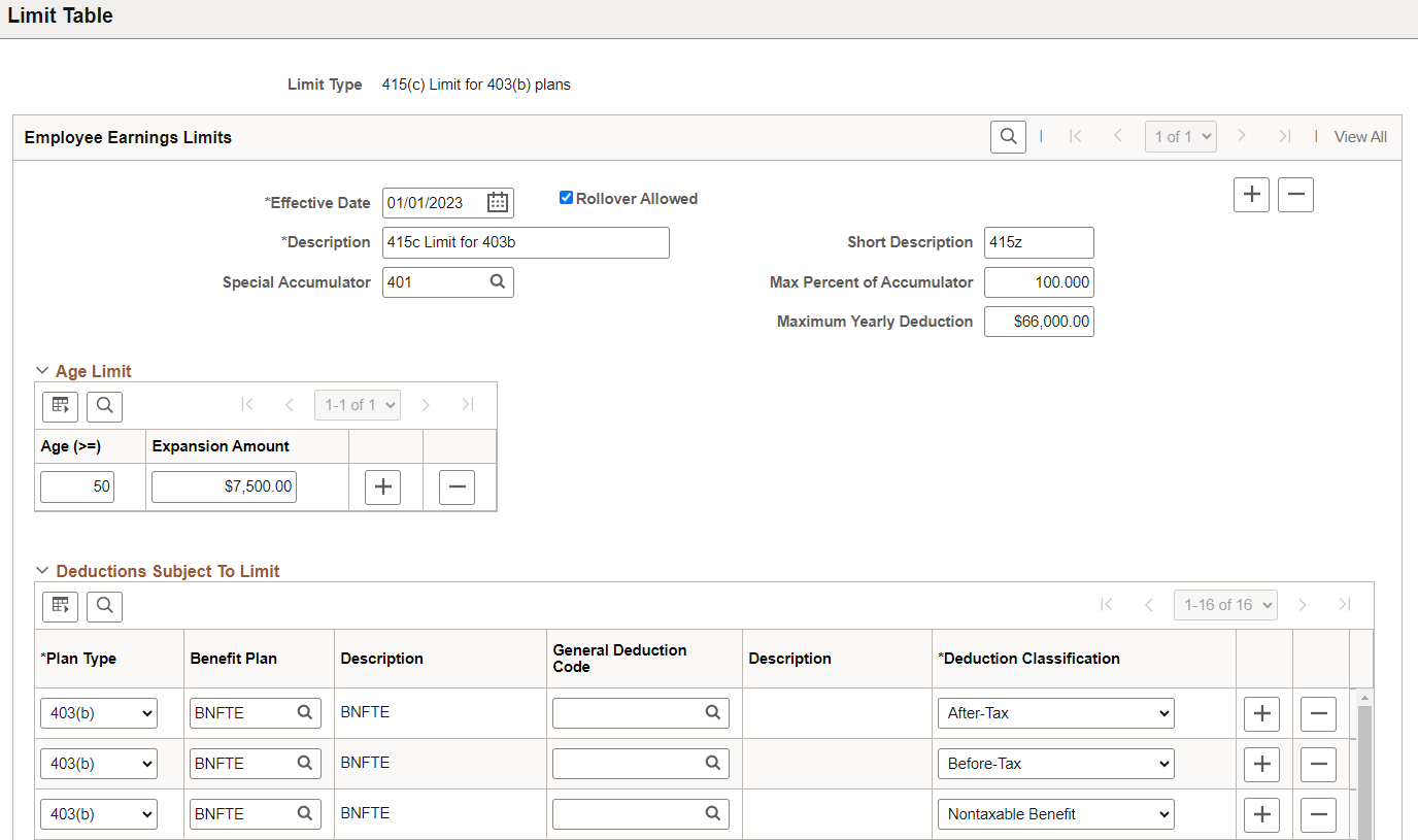

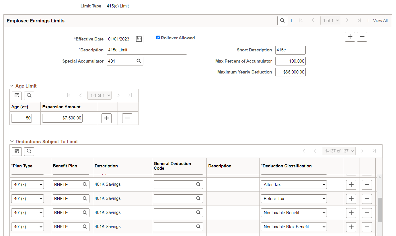

Use the Limit Table page (LIMIT_TBL1) to identify the rules that apply to the 415(c) Limits for 403(b) plans.
Navigation:
Access the Limit Table page for 415(c) Limits for 403(b).
This example illustrates the fields and controls on the Limit Table page for 415(c) Limits for 403(b) (1 of 3).
This example illustrates the fields and controls on the Limit Table page for 415(c) Limits for 403(b) (2 of 3).
This example illustrates the fields and controls on the Limit Table page for 415(c) Limits for 403(b) (3 of 3).

Use the Limit Table page (LIMIT_TBL1) to identify the rules that apply to the 457 limits.
Navigation:
Access the Limit Table page for 457 limits.
This example illustrates the fields and controls on the Limit Table page for 457 limits (1 of 3).
This example illustrates the fields and controls on the Limit Table page for 457 limits (2 of 3).
This example illustrates the fields and controls on the Limit Table page for 457 limits (3 of 3).
Field or Control |
Description |
Max Annual 457 Catch Up (maximum annual 457 catch up) |
Section 457 plans have a catch-up rule. Within three years of retirement, a participant can increase the amount contributed to the savings plan. This field is determined by IRS regulations. |

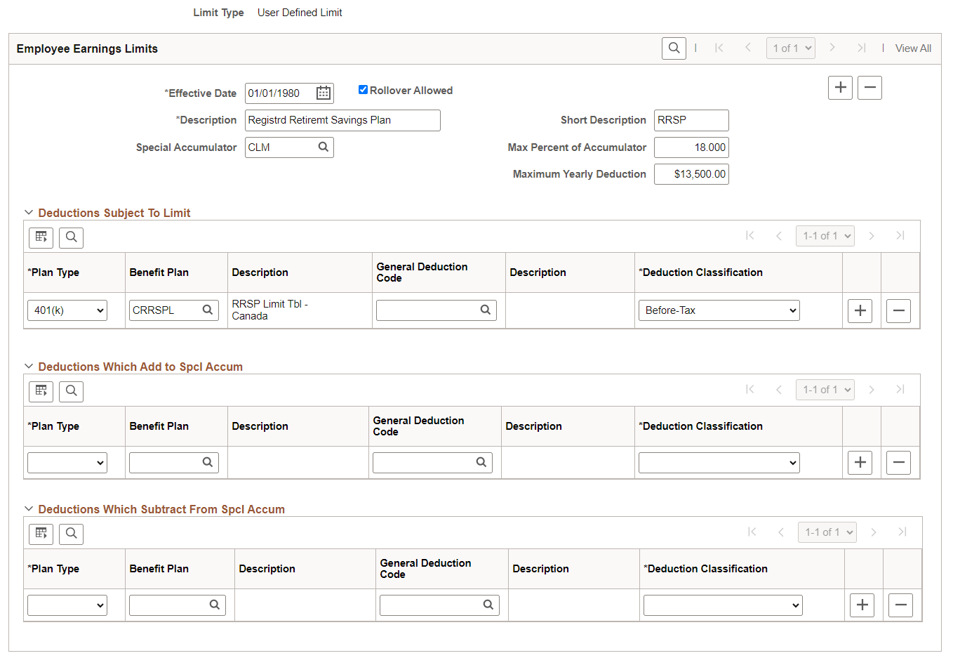

Use the Limit Table page (LIMIT_TBL1) to identify the rules that apply to User Defined limits.
Navigation:
Access the Limit Table page for User Defined limits.
This example illustrates the fields and controls on the Limit Table page for User Defined limits page.
User Defined Per Check Limit can be used to limit a deduction across two plans. For example, the table can be set up to limit the employer contribution across two plans.
Note: Unlike the other limits, User Defined Per Check Limit is set to limit in one pay check period. The others are set to limit plan balances.
