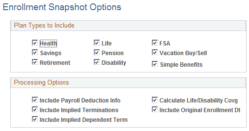

Use the Enrollment Snapshot Options page (BN_SNAP_CONFIG) to define data to extract from the database.
Navigation:
This example illustrates the fields and controls on the Enrollment Snapshot Options page. You can find definitions for the fields and controls later on this page.

Plan Types to Include  |
 Select only the plan types for which you will create a carrier interface extract or transmit data to the Carrier Interface Supplier Integration process in eBenefits. Note: If you are running the snapshot process only to create a HIPAA EDI 834 file, check only the Health plan type to reduce the time necessary to populate the Snapshot tables.  |
Include Payroll Deduction Info (include payroll deduction information)  |
 Select to include the last deduction taken and the pay end date for each enrollment.  |
Calculate Life/Disability Covg (calculate life/disability coverage)  |
 Select to have the Enrollment Reporting Snapshot process calculate coverage for life and disability plans using the plan definitions, calculation rules, and employee's compensation rate or annual benefits base rate.  |
Include Implied Term (include implied terminations)  |
 Select to include enrollments that are no longer valid because the participant has enrolled in another plan type, waived coverage, or transitioned to COBRA coverage. Note: You use this field whenever a carrier requires a positive notification of a termination or plan change (some carriers can detect these events simply by noticing a previous enrollment record).  |
Include Implied Dependent Terminations  |
 Select to create termination records for dependents in the snapshot and report them in the HIPPA file when a termination of an employee also terminated the dependent or when new coverage has been added for an employee and a dependent who was previously covered has been dropped from coverage. Note: You must select Include Implied Employee Terminations, for Include Implied Dependent Termination to be functional.  |
Include Original Enrollment Dt (include original enrollment date)  |
 Select to include an employee's earliest continuous enrollment date in the current, active plan. This applies only to employee-level enrollments and allocations. Changes to coverage codes in health plans, employee-specified coverage amounts in life and disability plans, or employee contribution amounts do not constitute a change in plan. This field applies to employees and dependents.  |
