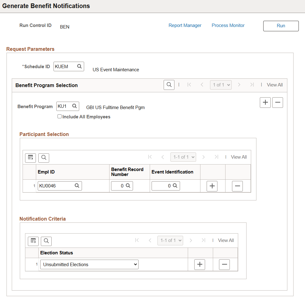

Use the Generate Benefit Notifications page (BN_NOTIF_RNCTL) to run the process to generate notifications for selected employees for a combination of Schedule ID and Benefit Program.
Navigation:
You can also access the Generate Benefit Notifications page from the Benefits WorkCenter. Navigate to
This example illustrates the fields and controls on the Generate Benefit Notifications page.
Field or Control |
Description |
Schedule ID |
Select the Schedule ID. The schedule can be for open enrollment or event maintenance. |
Benefit Program |
Select the benefit program. |
Election Status |
Select to define the notification criteria for the selected employees. When the process to generate notifications is run, a notification is sent to the selected employees based on this election status. Available options are:
Run |
Select to run the process (BN_EVT_NOTIF) to generate notifications for the selected employees based on the Schedule ID, Benefit Program and election status. Employees receive In-App and email notifications. Note: Currently, notifications can be generated for open enrollments and life events. |
