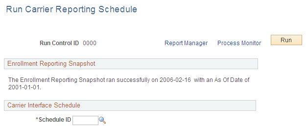

Use the Run Carrier Reporting Schedule page (BN_M_RUN_CNTL) to Extract and send data to a supplier.
Navigation:
This example illustrates the fields and controls on the Run Carrier Reporting Schedule page.
Field or Control |
Description |
Enrollment Reporting Snapshot |
This group box specifies the date on which the Enrollment Reporting Snapshot process was last run and the as of date entered for that run. These dates are taken from the BN_SNAP_HIST_TBL table. If the BN_SNAP_HIST_TBL or BN_SNAP table is empty, a message appears in this group box stating that the table is empty and the remaining fields and buttons are unavailable. |
Carrier Interface Schedule |
This group box enables you to select a schedule ID. You create schedules using the Define Carrier Interface Schedule page. |

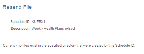

Use the Resend File page (BN_M_REFTP_FILE) to resend a file created from this schedule.
Navigation:
Click the Resend a file created from this schedule link on the Define Carrier Rpt Schedule page.
This example illustrates the fields and controls on the Resend File page.
Field or Control |
Description |
File Name |
Displays the name of the file created by the extract process. |
Run Date |
Displays the date and time that the file was transmitted to the supplier. |
Pub/Sub Timestamp |
Displays the date and time on which the report ran. |
Select |
Select if you want to send this file again. |
Resend File |
Click this link to send the file. |
