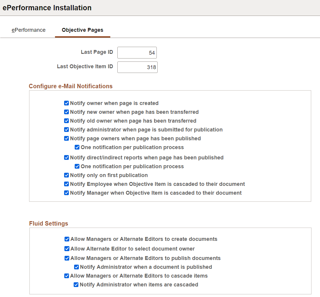

Use the ePerformance Installation - Objective Pages page (EP_INSTALL_OBJ) to configure system settings and email notification setup for Business Objectives.
Navigation:
This example illustrates the fields and controls on the ePerformance Installation - Objective Pages page.

Configure e-Mail Notifications
Field or Control |
Description |
Notify owner when page is created |
Select to send notifications to business objective owners when business objective pages (or documents) are created with assigned owners. |
Notify new owner when page has been transferred |
Select to send notifications to new owners to whom business objective pages (or documents) have been transferred. |
Notify old owner when page has been transferred |
Select to send notifications to old owners from whom business objective pages (or documents) have been transferred. |
Notify administrator when page is submitted for publication |
Select to send notifications to administrators when business objective pages (or documents) are ready and waiting for them to publish. |
Notify page owners when page has been published |
Select to send notifications to owners when their business objective pages (or documents) have been published. Typically these individuals will need to update their pages and link their objectives to the pages above them that have already been published. |
One notification per publication process |
Select to bundle the requests and send only one notification to each recipient, even if there are multiple pages (or documents) in the process for which they could be notified. |
Notify direct/indirect reports when page has been published |
Select to send notifications to employees when business objective pages (or documents) have been published. These employees are direct and indirect reports who have access to the published pages. Typically these individuals will need to update their ePerformance documents and link their objectives to the objective pages above them that have already been published. |
Select to bundle the requests and send only one notification to each recipient, even if there are multiple pages in the process for which they could be notified. |
Notify only on first publication |
Select to send notifications to recipients only on the first publication of the business objective pages (or documents). |
Notify Employee when Objective Item is cascaded to their document |
Select to send notifications to employees when objective items have been cascaded down to their performance documents. |
Notify Manager when Objective Item is cascaded to their document |
Select to send notifications to managers when objective items have been cascaded down to the performance documents of their employees. |
Fluid Settings
These settings are applicable to Fluid Business Objectives only.
Field or Control |
Description |
Allow Managers or Alternate Editors to create documents |
Select to provide managers or alternate editors the ability to add new business objective documents for employees. If selected, the Create Document link becomes available on the Business Objectives Page. |
Allow Alternate Editor to select page owner |
Select to allow alternate editors to specify the owners when creating business objectives documents on the New Business Objective Document Page. |
Allow Managers or Alternate Editors to publish documents |
Select to allow managers or alternate editors to publish business objective documents. |
Notify Administrator when a document is published |
Select to send notifications to administrators when business objective documents are published by managers. This option becomes editable when the Allow Managers or Alternate Editors to publish documents option is selected. |
Allow Managers or Alternate Editors to cascade items |
Select to allow managers or alternate editors to cascade objective items from business objective documents to performance documents. Managers can cascade items at the document section level on the Cascade Items Page. |
Notify Administrator when items are cascaded |
Select to send notifications to administrators when objective items are cascaded to performance documents by managers. This option becomes editable when the Allow Managers or Alternate Editors to cascade items option is selected. |
